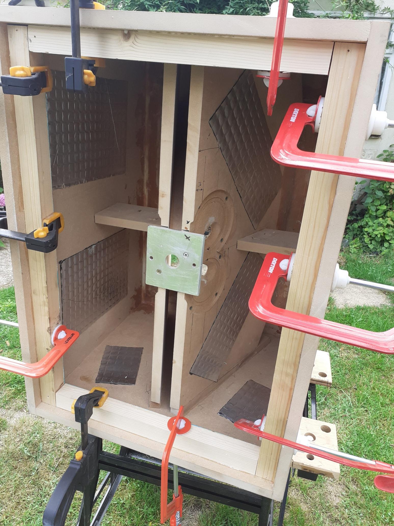

I like the idea and it doesn't seem too hard to achieve even without a 3d printer.
If you only had holes for the foam to escape on the inside of the enclosure there would not be too much time lost as it would not have to look pretty.
Rob.
Edit: maybe I should fill up the voids in the back of this horn with expanding foam ?
Rob.
