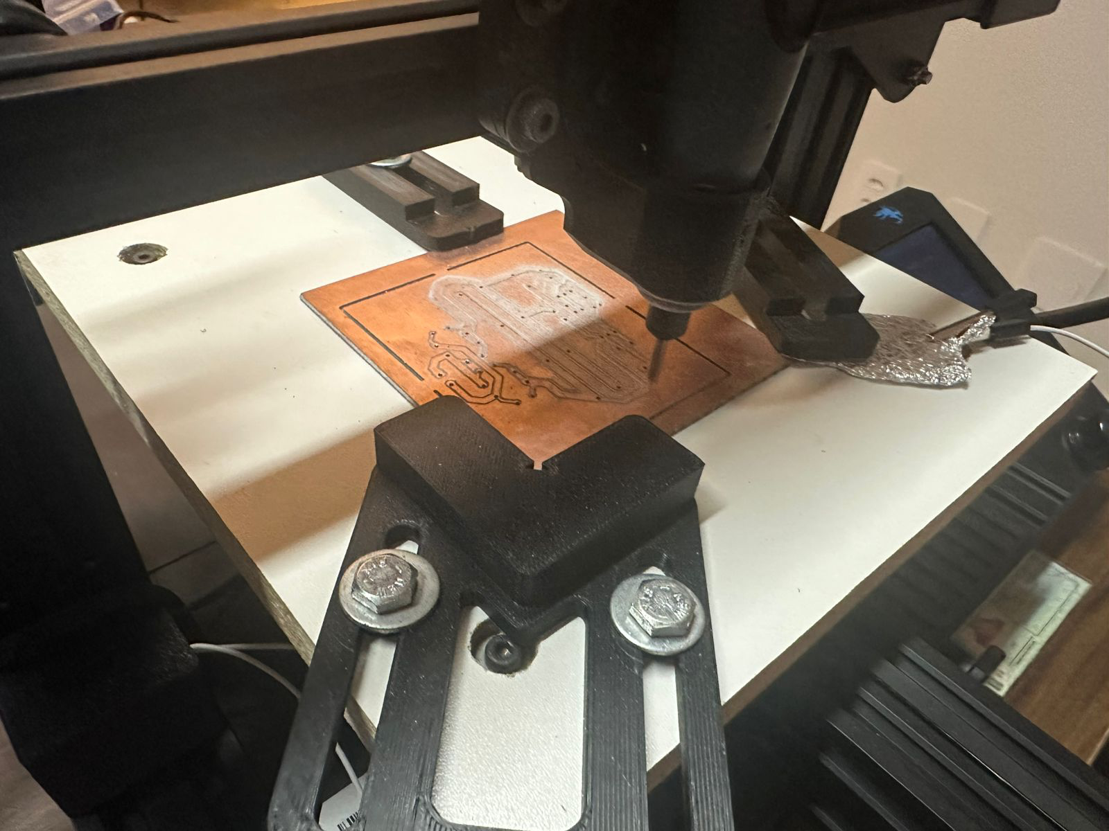

Not exactly the same way you described, but I use a 3d printer to fab PCBs at home.
I replaced the print head with a dremel extension like this: Dremel Flex Shaft Attachment. So, instead of printing and etching the PCB, I "machine" it - i.e., mill, drill, cut.
I use an Ender 3 V2 printer with a custom Marlin firmware. It takes a few tries to get used to it, but, with practice, you can even fab SMD two sided PCBs. I would say that the worst part is the software. You will have to deal with gcode files at the low level, understand code commands and customize/merge the files accordingly. You will break a few drill/mill bits until you get used to the process, but I find it great to create prototypes.
If you have a single sided pcb, you can program the printer to remove the copper (creating the tracks), drill the holes and cut the pcb using a single mill bit. Or you can use different drill/mill bits to acheive better finish. I currently prefer a 60 degrees 0.1mm v-shaped mill bit to cut the tracks, a flat mill bit (0.8mm) to remove copper and cut the board and one or more regular drill bits to... well... drill the holes.
I use FlatCAM to produce the gcode files from gerber files. Here is a picture of the v-shaped mill bit cutting the tracks:
This is not exactly what you asked, but it is an option to consider. Of course, all parts that you need to make it work were 3d printed.

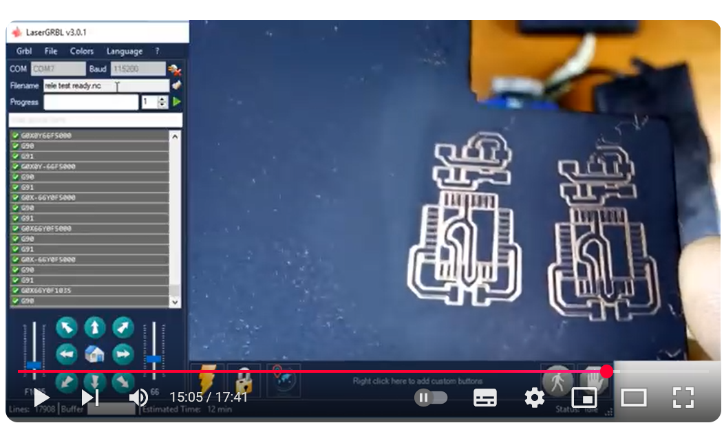

A 3D printer is difficult, I think a laser engraver up to 2W will be more convenient. The board is simply painted, and then the unnecessary layer of paint is burned off with a laser, there is no need to burn metal, so the laser power is not needed high.
And if you take an engraver with the ability to replace the laser head with an engraving one, you can drill holes in the right places.
