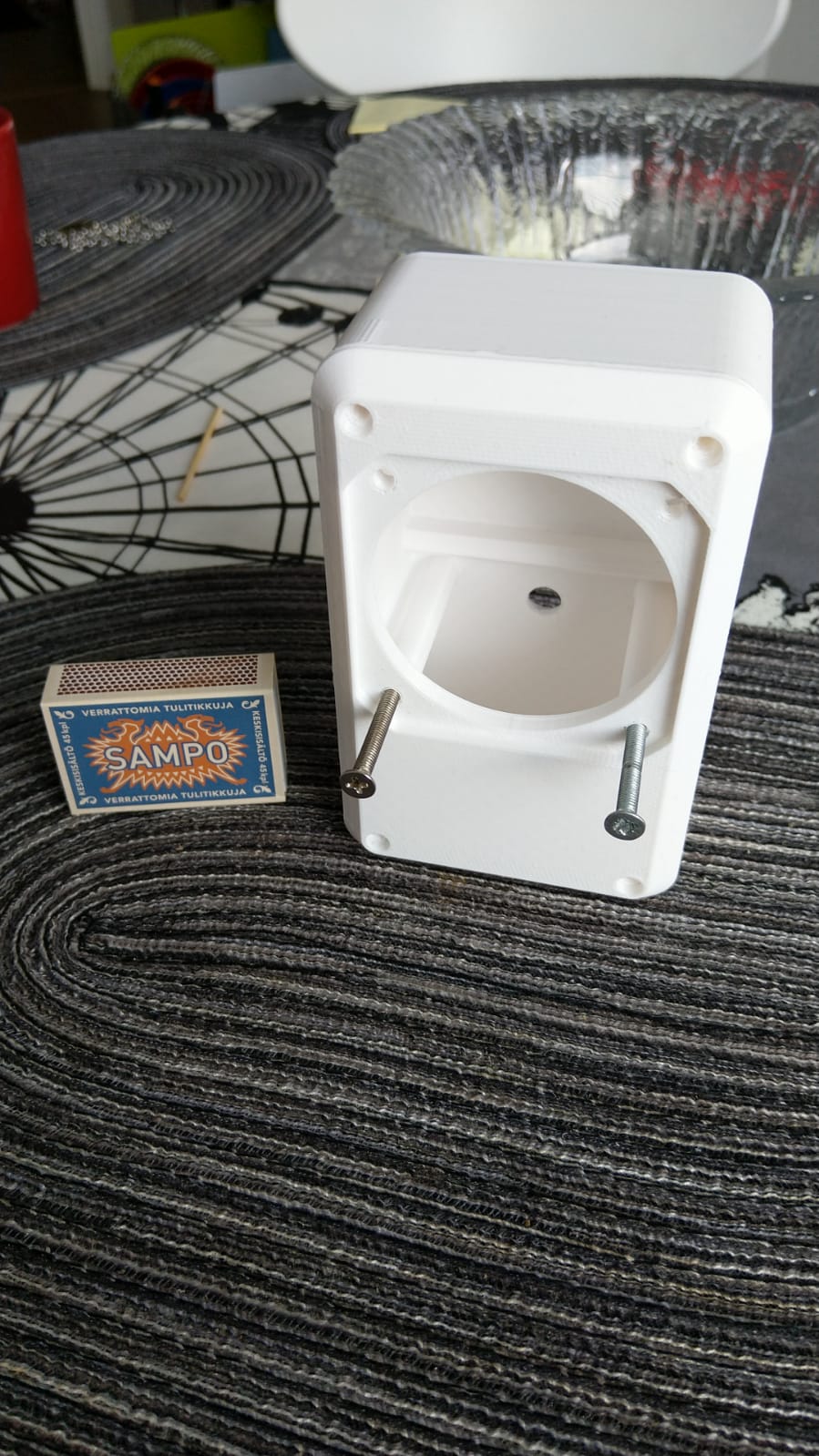

Here is an egg shaped one for the Monacor SPX-31 M incl. model file(s):
Mona aus dem 3D-Drucker – Lautsprecher selber bauen
If it wasn´t so expensive to have them printed I´d be tempted!

It is! Would love to hear that driver! Would you share your model?Small is beautifull.
"It is! Would love to hear that driver! Would you share your model?"
Oh, It´s an early proto on hold. I haven´t decided the mounting yet.
Maybe a nice bottle, speaker on top wrapped with led stripe and an acoustcally transparent (enough) lampshade to cover all up.
Double-duty . . .
Double-duty . . .
