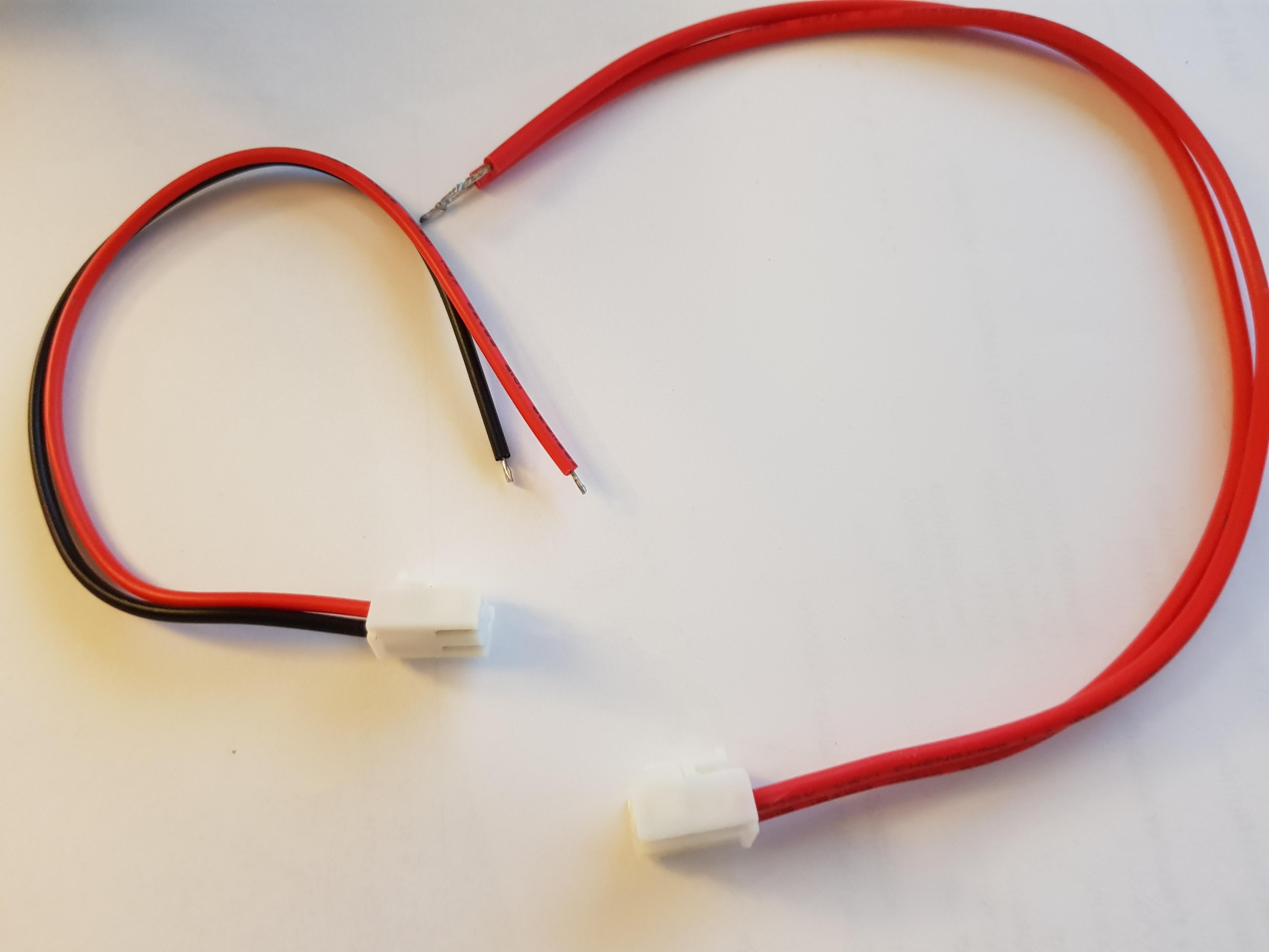

Hi Guys,
I hope you can help.
I bought a number of Amp and PSU from 3e Audio. The TPA3251 and the TPA3255.
Unfortunately, the PSU did not come with connectors and 3e Audio says he had none and lead me to an AliExpress page that contained not what I want.
I need help finding these. I went to AliExpress, Bandgood, eBay, element 14 and I could not find the same things.
I believe they are:
1. From AC to PSU 3 pin connector with only 2 pins used about 5mm between the pins the OD of the wire is 2.75 including the insulation
2. Form the PSU to the amp a 2-pin connector again 5mm between the pins and the OD of the wire is 2.1mm
I tried searching JST 5.0mm 3 pin and JST 5.0mm 2 pin and all the variations on this.
How does one find these? I only need 2 of each…. I even range the technical guys at Element 14, and they could not help.
I am sure for you experts this is easy…. can anyone help??

Hi Foxint
Your perseverence does you proud!
I believe the connectors you require are CH3.96 (ie nearly 4mm between pins, not 5mm), such as can be found here:
5PCS CH3.96 Cable CH 3.96mm Female Housing Plug Connector Wire 2P 3P 4P 5P 6Pin 22AWG Wire Length 20cm|Connectors| - AliExpress
I think it's the JST NV series:JST - JST NV Connector nvr-03 for the 3 pin and nvr-02 for the 2 pin.

Yatsushiro – thanks for the link. So I just buy 2 sets of these and it will be OK. I will throw away the ones I do not need.
The 3 pin one has 3 wires – do I just cut the black, the one in the middle? Does it matter that the colours are red and yellow, and I have red and red?
JST NV 5.0 2pin – search into eBay resulted in zero results. The results below the zero number did not really look like the ones I have. This makes it all far more confusing. I wish they were not missing in the box.
