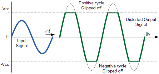

here you can find an overview what is gain. left sine is the input -right the output.
and you can see what happened if the amp is clipping --> means he "run out" of the voltage supply...😀
chris

Is the clipping shown in your graph caused by under voltage of the input source?
It seems I need to study the relationships involved carefully; gain, input voltage, output voltage, power supply voltage. Can you recommend a reference that a non EE can understand?
