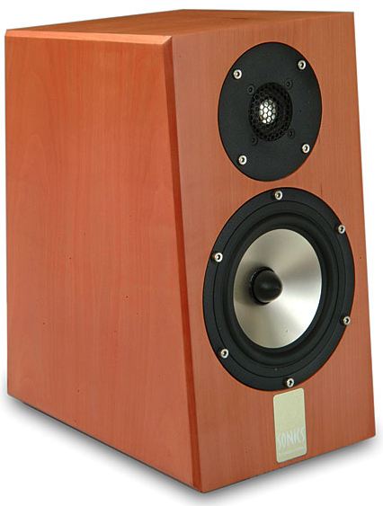

Joachim Gerhard's Sonics/Canalis Anima. The reviewer in stereophile didn't like the above axis lobing, so Joachim flipped the tweeter polarity for the Mk. II model. 😀
5" drivers are quite easy to work with for BW3, as are 8" drivers. 6", I am not to sure.

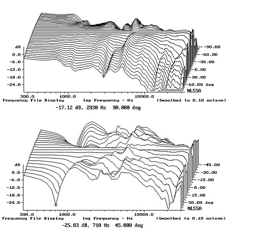

Dunlavy SC-1 as measured by John Atkinson, horizontal and vertical axis. As JA said -don't listen to this speaker standing up. 😉 As you would expect from a symmetric array on the vertical axis, with 1st order filtering. The larger models followed similar trends, detail varying with driver and implementation details.
John Dunlavy was an excellent designer and I doubt anybody would disagree with that. But he was obliged to work within the laws of physics. It is not disparaging to note that like everybody else, he picked his compromises according to his priorities (in his case, on-axis and phase response), did a damn good job within that context, and he was the first to note limitations / usage requirements, e.g. stressing minimum listening distances (and heights) for such products.
