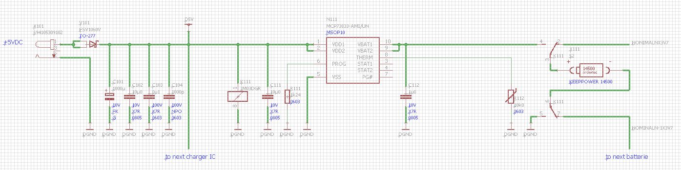

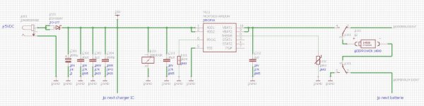

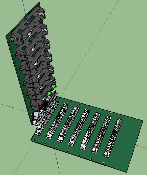

Sorry for the bad quality of the sketch, starting with Edraw today!
Features:
- standard 18650 protected cells, no custom bags
- up to 4000mAh
- 3S/6S (serial wiring allowed)
- relay switching between charging and listening for full galvanic isolation
- cheap single cell Li+/LiPo/LiFePO4 charger IC
- charging current up to 1A, default 350mA (one resistor)
- single +5V charging and working voltage only
(without cell: 1 holder + 1 relay + 1 IC + PCB + chickens chickens = 8.5$/cell )
What do you think, comments welcome!
P.S.: is LiFePO4 with protection available?
JP

A couple thoughts from someone who does Li-Ion battery technology for a living...
Why the complication of using 5V to charge the cells individually and relays to put them in series instead of using a higher supply voltage and charging them in the 3S or 6S configuration?
"Protected" 18650s are usually 3-5mm longer thane 65mm, so make sure they still fit your cell holder.
The cells are not going to be 4000mAh, at least not under any normal standard capacity testing.
I'm not aware of any protected LiFeP04 cells, but if you don't need the energy denstiy of standard Li-Ion chemistries they are a very good choice due to their increased stability, higher power output, and cycle life. You could use those cells and put the protection on the PCB.

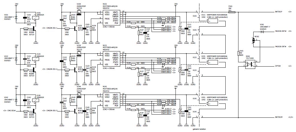

Hello @jc2
Power on:
- only micros are powered (modification to apply to the architecture: +5V supply micros dedicated and +5V supply with external power on for chargers for example E/PS 800 series type)
- secondary controllers informs master controller over I2C about all single cell voltages: master controller don´t release voltage to loads until all batteries charged
- relay switching for fully galvanic isolation: charger is then in standby
- simplest discrete opto-isolated NAND over all voltages inform master controller about UV
5V supplies are commonly available (no specific needs for CC/CV charger, ok, MEANWELL goes cheap) and I don´t need balancing using cheap single cell charger IC´s: the micro will do the job by removing charger voltage from full charged one also informs the master controller upon specific default battery: UV and OV protection inside battery.

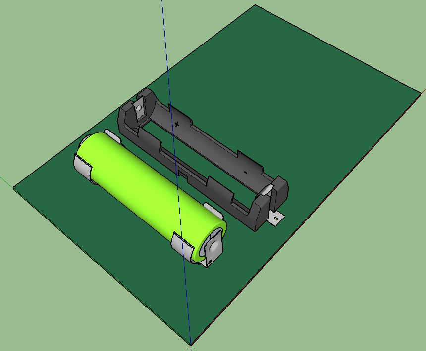

I´ll check the datasheet for the Keystone 18650 batterie holder and the datasheets of protected Li+/LiPo 18650 batteries.
I know about LiFePO4 and would really use them if protected available.

Hello jc2,
Thanks for the informations. I know the TI, LT or Intersil part, very nice but they´re connected permanently over the battery pack.
First requirement: only UV protected batteries connected to load, means, protection switchs to balanced charging circuitry; should be realized with simplest optocoupled wired NAND connection to µC.
Serialized balanced charging, because of different battery behaviour (48S), will waste power and produce undesirable heat.
I´m working on the requirement specification.
I´ve found HYCON HY2112 1-Cell LiFePO4 Battery Packs Protection ICs and HYCON HY2212 1-Cell LI+/LiPo (could be used for LiFePO4) Battery Charge Balance IC: I´ve to check availability and to check distorsion of protected/unprotected batteries (Protection using Oscillator, Counter and Logic).
COTS 48S LiFePO4 charger coming from China.

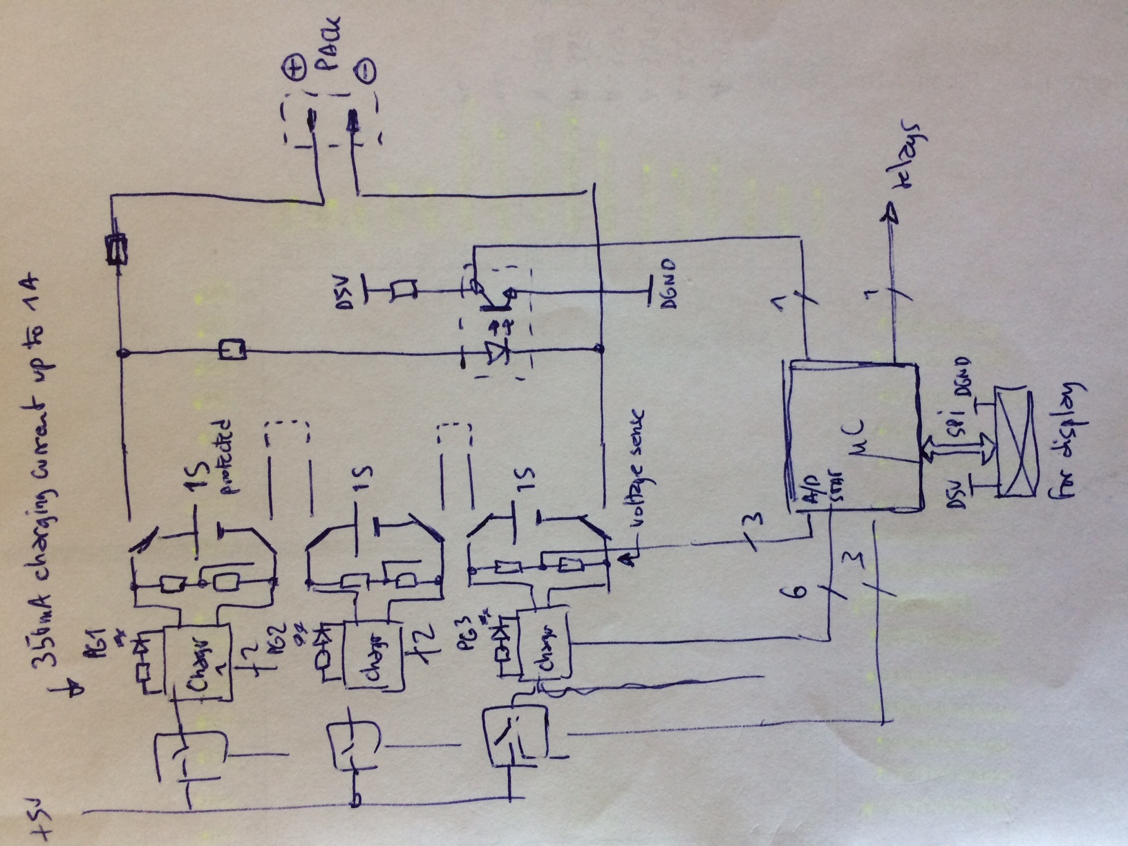

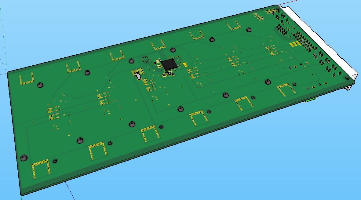

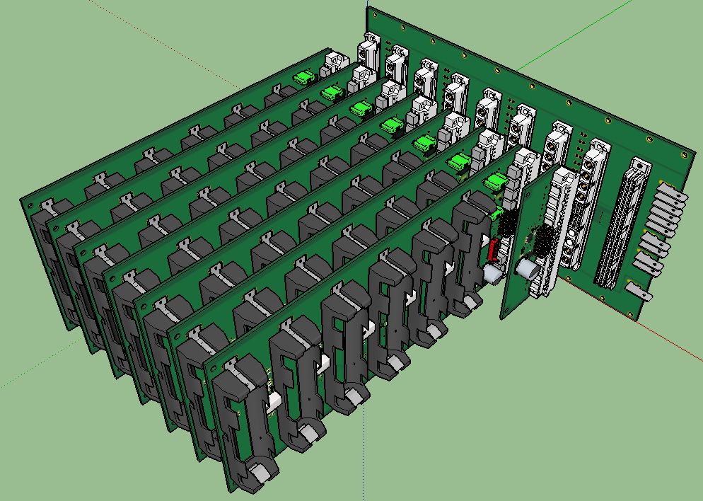

... ongoing, after a lot of coffee and more cigarettes: sketching the first stand alone prototype intended to be used with headphone amplifier such as Cmoy, SOHA or other JFET ones:
- 5S (60x75mm)
- starting with 14650 (< 4Wh) protected Li+ or LiPo
- Microchip charging ICs (800mA 1C charging current)
- standard +5V wall-cube power supply
Relay or Mosfet switches, Mr. Watson?
JP

why use protected cells ?
the charger takes care of the overvoltage and charge current, you only need an undervoltage switch and that could be on the 5S voltage/ supply line. overcurrent can be done using a PTC or self resetting fuse. these cells have plenty capacity to turn off a fuse..
basreflex
basreflex
