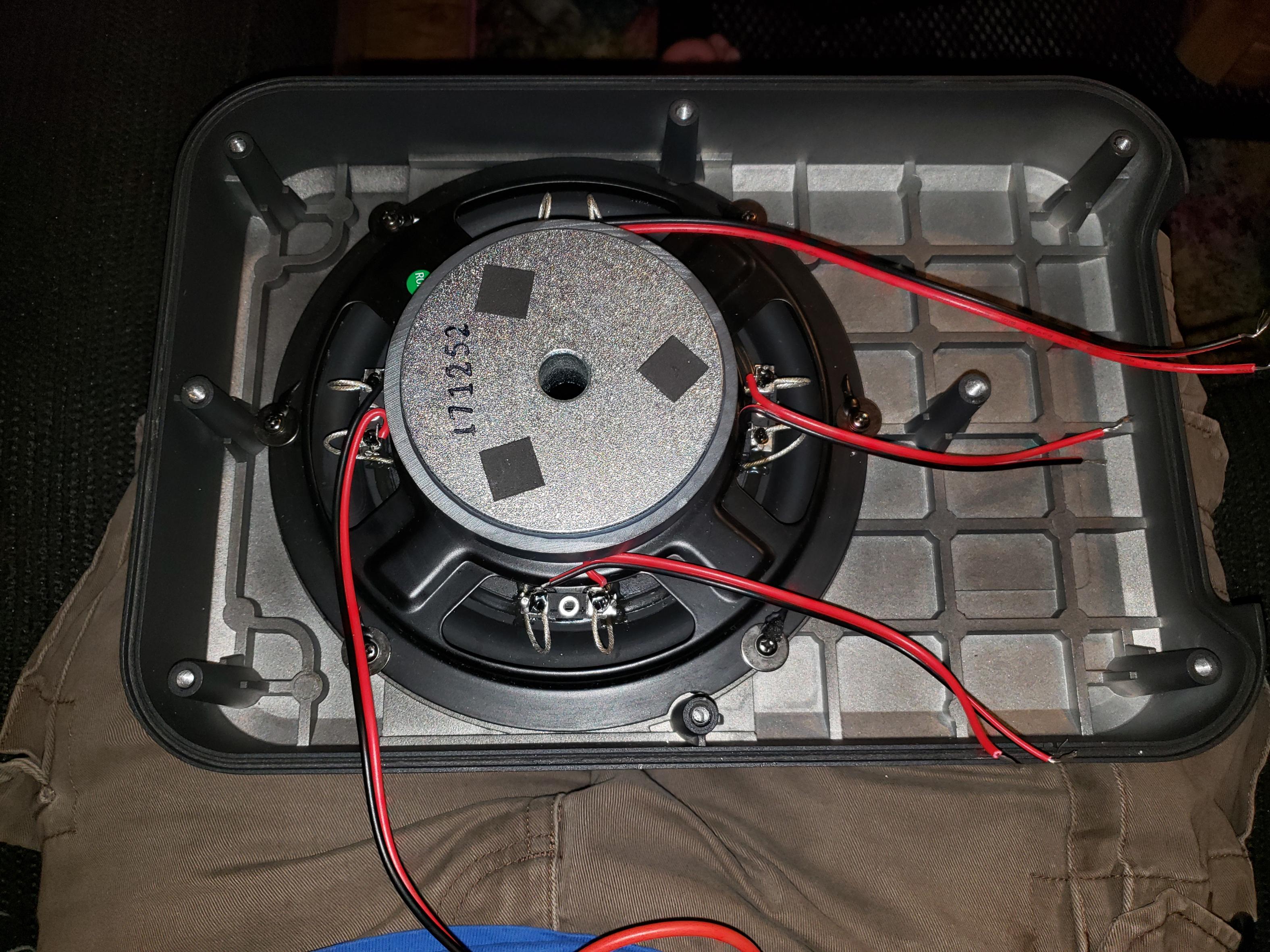

So I have this powered underseat alpine subwoofer, model pwe-s8 with a blown internal amp. I figured I would just bypass the internal amp and run it off my external but when I pulled it apart the speaker has 8 wires going to it, never seen anything like it.
That is the first I have seen with four voice coils. Measure the DC resistance of each to see how you may wire them. Could all in parallel or maybe series-parallel.
Quad-coil drivers are prevalent in car audio installations. It's not unheard of to see 4x1 ohm coils in a subwoofer. It's mostly for output, because the amplifiers send more power to really low impedances, and sensitivity is really high with 4 coils in parallel.

2 wires are red with black stripe and 2 are solid red, each set was reading 2.4 ohms on my Fluke.
Any insight on how to wire this thing up would be much appreciated 🙂 my amp puts out 200 rms at 4 ohms, hopefully it's not too much if I keep the gain down.

Well I was hoping to throw a little more power at it with an amp I already have, I think the ratings given are for the internal amplifier, no way to know what the driver itself can take though. I guess I'll try to repair the amp it came with first to play it safe.
Did it play well at full power with the old amp? If so you could try some more power. 🙂
You have these options:
1) 2series of 2 coils -> 4.8Ohm and drive it with any stereo amp.
2) all 4 in series ->9.6Ohm
3) 2 parallel 2 in series ->2.4Ohm and drive them with a mono amp.
the 200W rms amp will put out at least 83W into 9.6Ohm with option 2.
