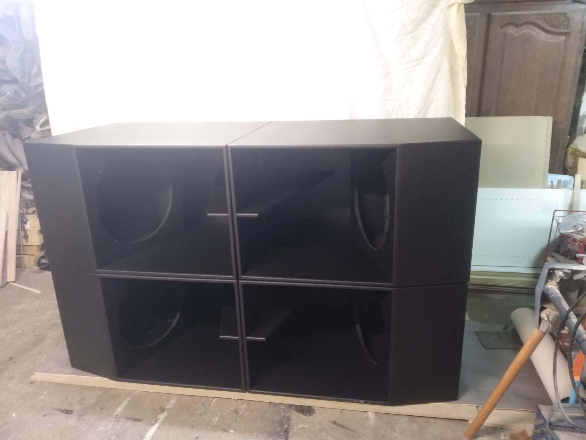

I found picture in the web:
In this picture there are 4 separate boxes for each driver.

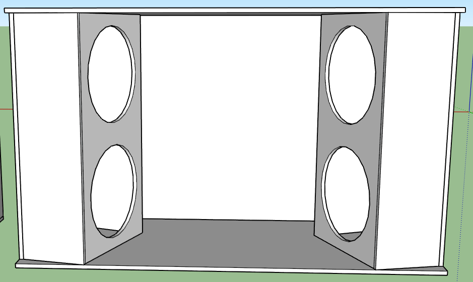

I was wandering what would happen to make 1 big box for 4 drivers, like this:

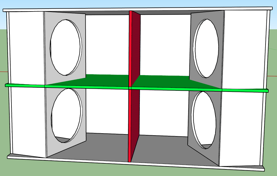

But to save materials not to install RED and GREEN baffles ?
It would look something like that :
And to make it rigid to use scrap narrow scrap planks just to connect bottom and top sides etc...
Will that work ?
I think it would be possible to remove GREEN part without change in response, but what about removing the RED part ?
Is there any way to model this in HornResp?

The horizontal green shelf could be removed without too much change, removing the red vertical horn wall would change the design considerably.But to save materials not to install RED and GREEN baffles ?
Not very well- narrow scrap planks will flex.And to make it rigid to use scrap narrow scrap planks just to connect bottom and top sides etc...
Will that work ?
The individual tapped horns can be modeled in Hornresp, but removing the red horn wall creates two series TH cabinets, which can't be modeled as far as I know.I think it would be possible to remove GREEN part without change in response, but what about removing the RED part ?
