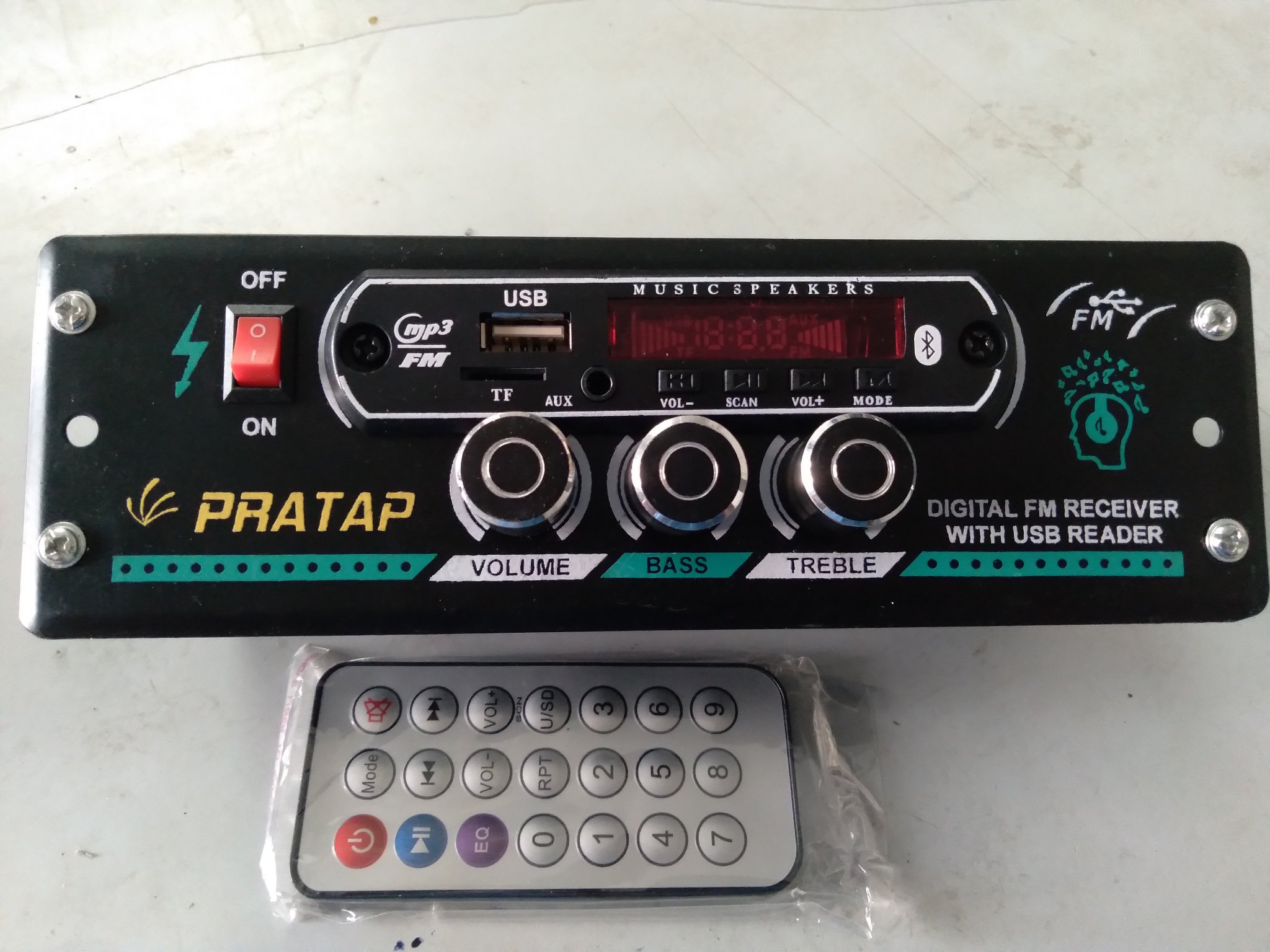

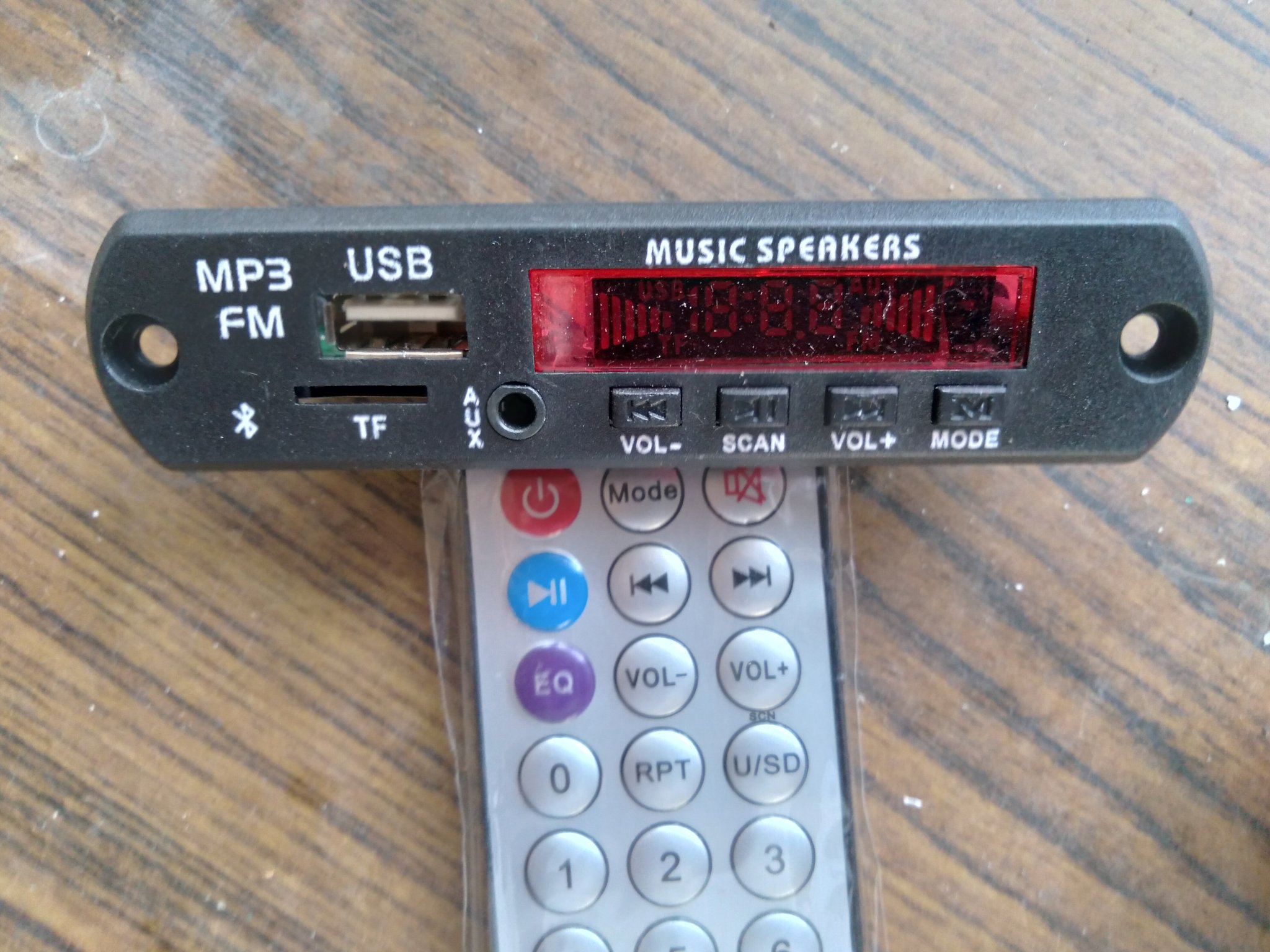

These are FM / SD Card / Memory stick / Bluetooth / Aux. In modules.
Work nicely. 7805 is enough for car use, with maybe a drop resistor.
Less than $2 here... Maybe $4 with metal box.
Includes remote.
A lot are used as the input selector / front end for a variety of new mains operated amps, and also updating old home amps with these added functions.
The price is almost a joke, considering the number of parts and effort needed to make it.
Have you listened to one?View attachment 1033187
Includes remote.

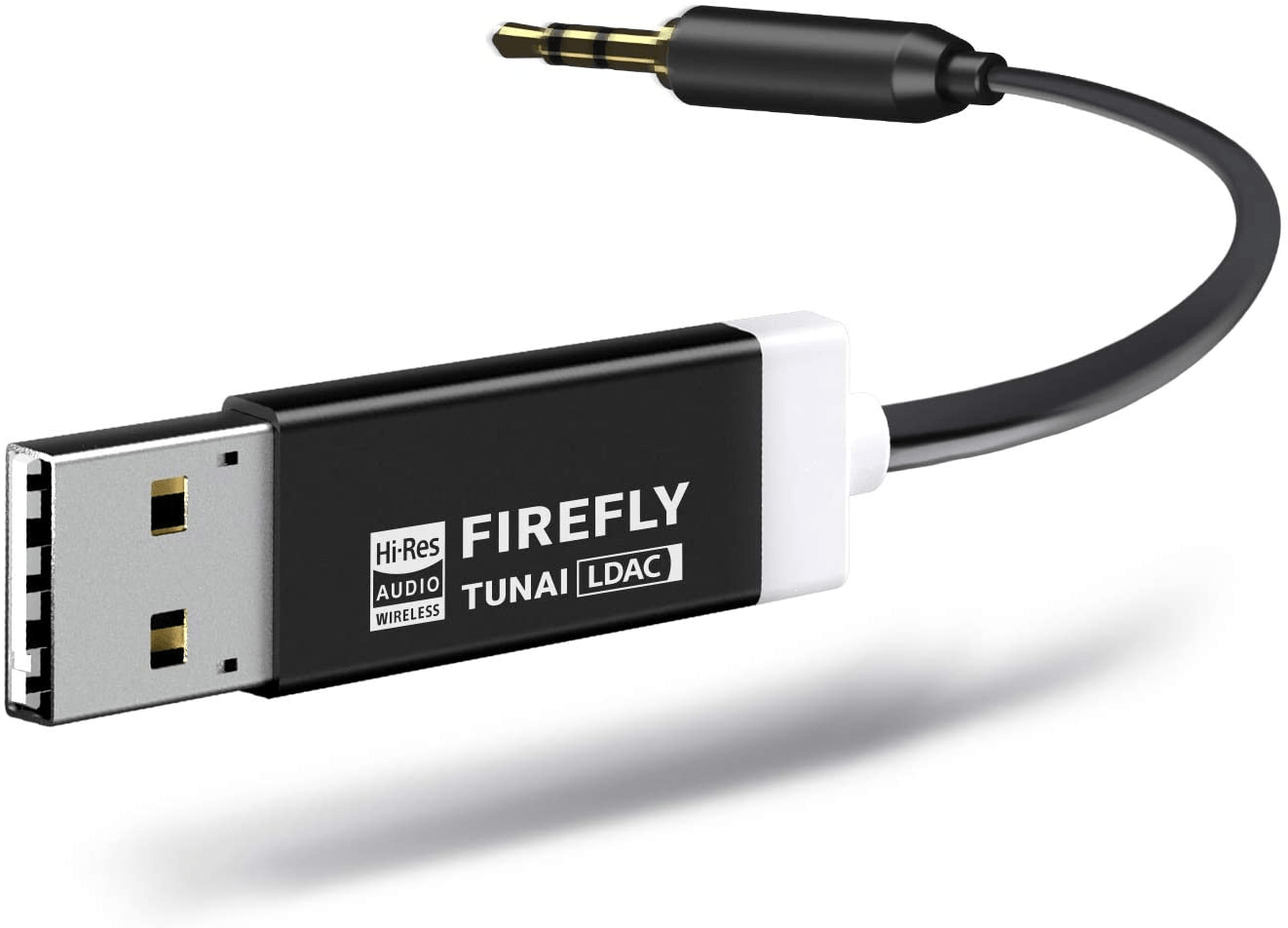

For a more elegant solution (especially if your car has a USB port):
I use this in my car. My phone is paired and playing music by the time I start the car.
https://www.amazon.ca/TUNAI-Firefly-Smallest-Bluetooth-Receiver/dp/B01HDO66NK
