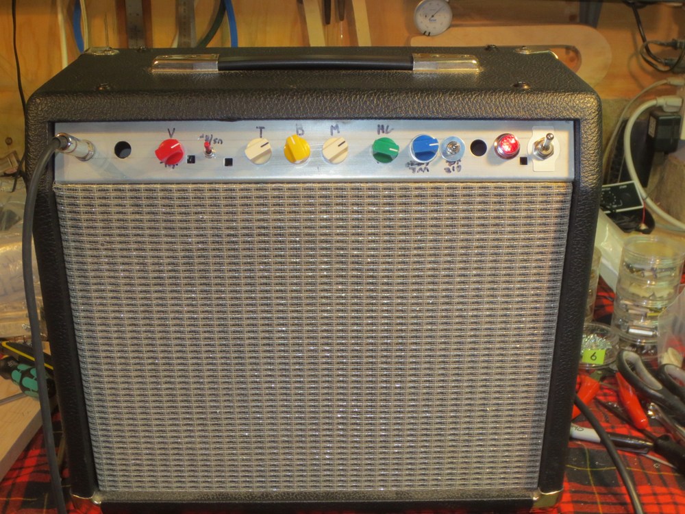

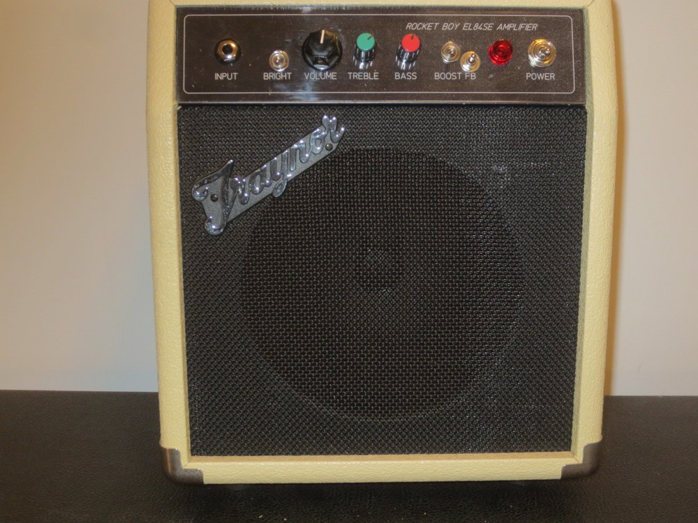

I've done three of those conversions this fall:
Frontman to micro-Bassman
Traynor GM15 ss practice amp to ADA Rocket
Fender Champion 110 to Cornford Hurricane
Of the three, the Traynor had the best chassis - a nice solid chassis with a flat bottom. The Frontman chassis was useless; had to bend a new one.
The Champion 110 had a deep back/shallow front chassis with a sloping bottom, so I needed to add a fan to keep the hot air from collecting underneath. It's still a 'work in progress' so no faceplate till I decide to stop adding gizmos and switches.
