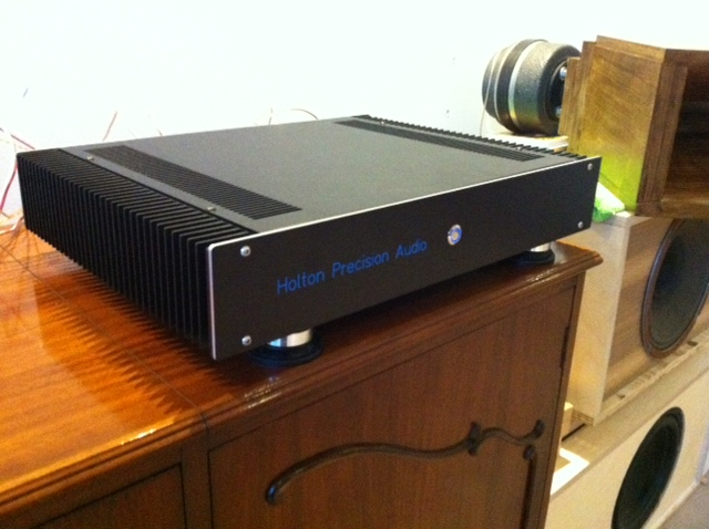

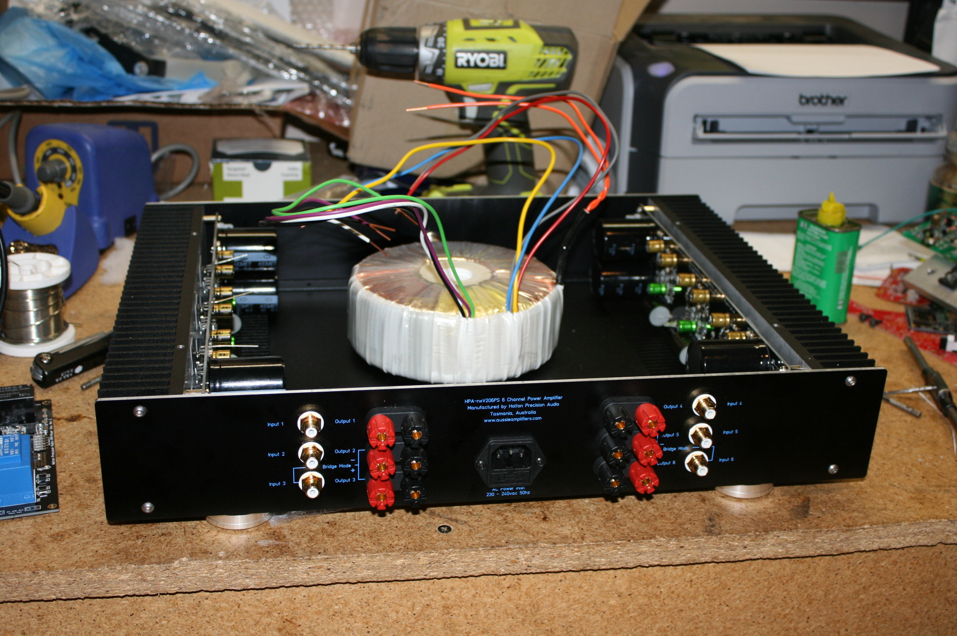

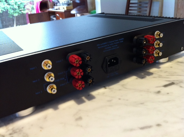

I recently took delivery of a Holton Precision Audio 6 channel amp, custom built by Holton himself. His separate components and fully built amps are getting good reveiws.
My rig is Azura 340hz horn with JBL 2445, mid bass is Eminence Kappalite 12 inch, bass is EV 18 inch. I use two units of MiniDSP.
Andrew.
