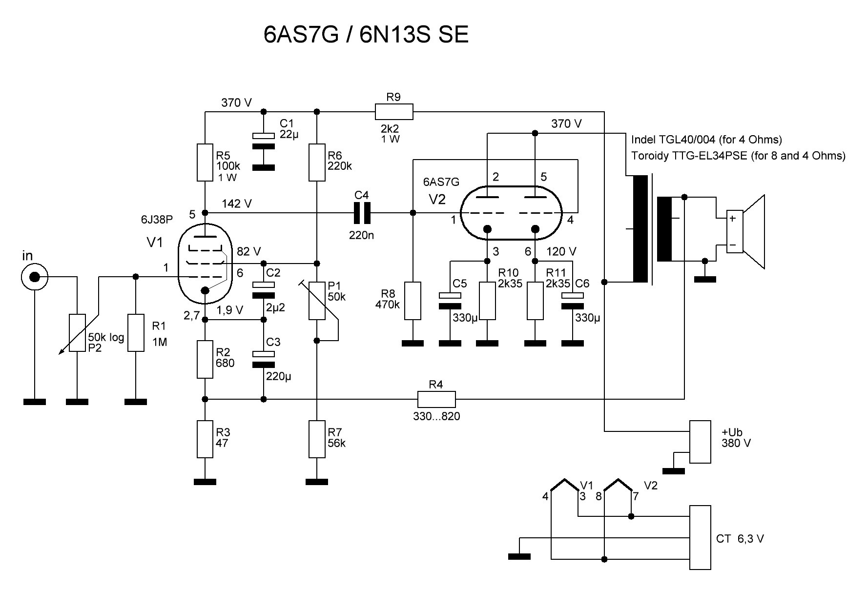

Thank you all for your replies! so 100ma, 250v, and -120v bias into 1.5K for both sections of the 6AS7 in parallel for SE? This won't over voltage the tube in anyway? I am for sure going the SE route and not PP. Thanks again!

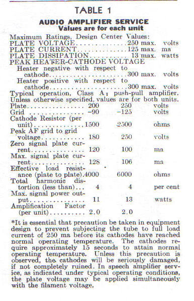

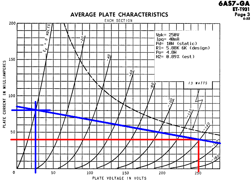

You don't have to worry about over voltage. However, this operating point will run the plates way too hot. The spec sheet (Frank's) specifies a PD= 14W/plate. 250V at 100mA is 25W. You might get a few mnore watts, but the heavy load will lead to more distortion. The loadline I posted will give slightly less than 10W into 3K (paralleled sections) out with very little distortion, and stays well within spec.Thank you all for your replies! so 100ma, 250v, and -120v bias into 1.5K for both sections of the 6AS7 in parallel for SE? This won't over voltage the tube in anyway? I am for sure going the SE route and not PP. Thanks again!
The other bit of weirdness is that the spec sheet recommends at least 30 secs of prewarm before turning on the HV. The 6AS7 was intended for series pass duty, and so has a VHK rating of 300V. That makes for a thicker than normal insulation between the filament and cathode, and a greatly increased time for the cathode to come up to working temp.
isn't this load line for push pull output stage?You don't have to worry about over voltage. However, this operating point will run the plates way too hot. The spec sheet (Frank's) specifies a PD= 14W/plate. 250V at 100mA is 25W. You might get a few mnore watts, but the heavy load will lead to more distortion. The loadline I posted will give slightly less than 10W into 3K (paralleled sections) out with very little distortion, and stays well within spec.
It's a Class A SE loadline. Since the Q-point is 40mA, the max current is limited to 80mAmax, and a Vpk= 22.96V. When the final just hits cutoff, the voltage will be 485.29Vmax. That gives a current swing of 80mAp-p -- the outer limit of Class A. A Class B, PP loadline would start at 250V since the PP pair conduct on alternate cycles, and the PP OPT operates on differential current only.
Class AB PP would require a load of 24K/P-2-P, and Class A PP 12K/P-2-P as it would be a balanced, two-phase source. As given, the OPT needs to match 6000 : 8 for one section or 3000 : 8 for paralleled sections (or whatever your speeks are).
...so 100ma, 250v, and -120v bias into 1.5K for both sections of the 6AS7 in parallel for SE?
That makes 12.5 W / triode halve, which is OK.

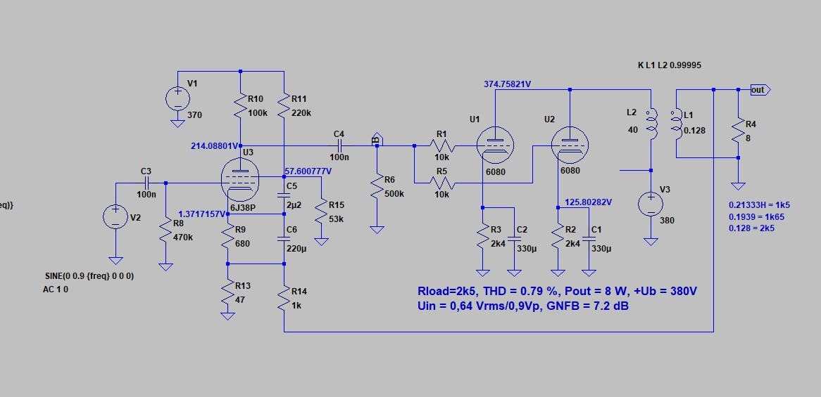

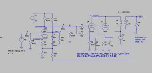

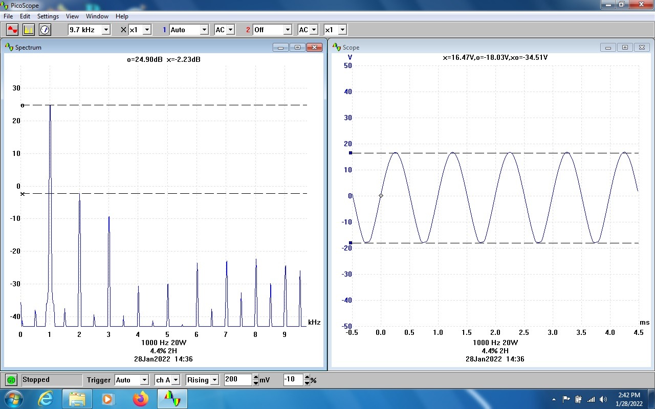

I’m curious at what output level one would get such low second harmonic distortion from a 6as7/6080 tube.Try this (attached) The h{sub]2[/sub] estimate comes in very good here, so I'd expect this to sound pretty good. You'll need a VPP= 390V to compensate for the voltage lost across a cathode bias resistor.

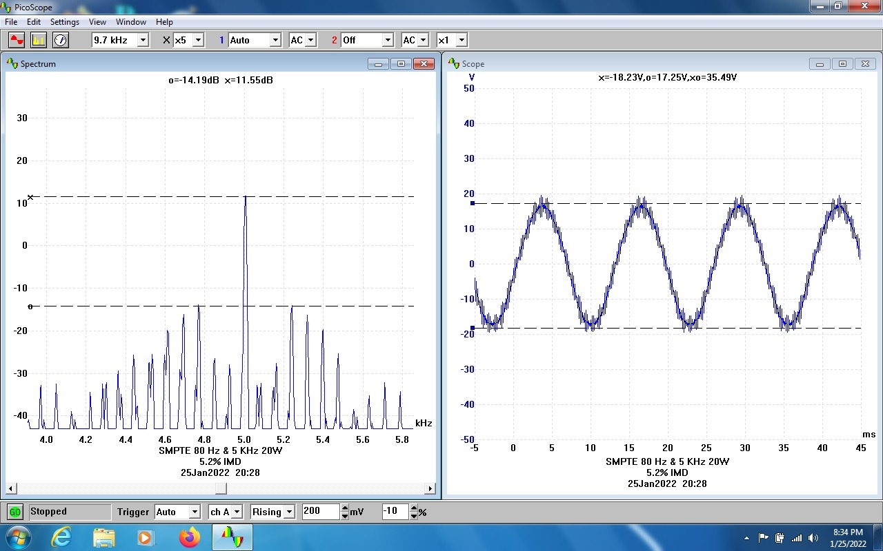

That is impossible. Attached are the test results of the 6AS7G SE amplifier I posted (#2) with 6 dB and 10 dB GNFB.I’m curious at what output level one would get such low second harmonic distortion from a 6as7/6080 tube.
If you don’t mind sharing your spice file and the models for the tubes you are using, I am very interested, I’m closing in slowly on a pp 6as7/6080 amp, and curious to perhaps eventually build one single ended also to hear the difference between the two topologies.Attached one version. If you need the LT Spice .asc, let me know.
