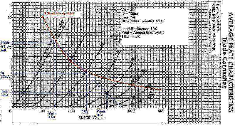

I found Triode Strapped Curve for 6AU6
See attached. The posting limitations will make this hard to read.
Not going to get much power out of it but if you are just playing around try this
Vp = 250
Io = 12mA
Bias = -4V (333R Rk for "self bias" use 3 x 1K 2W parallel)
OPT primary 10K to (whatever speaker hope its got like 98dB SPL! LOL)
Pout = about 0.35Watts
THD = about 9%
Might be able to push 1 watt in Push Pull??

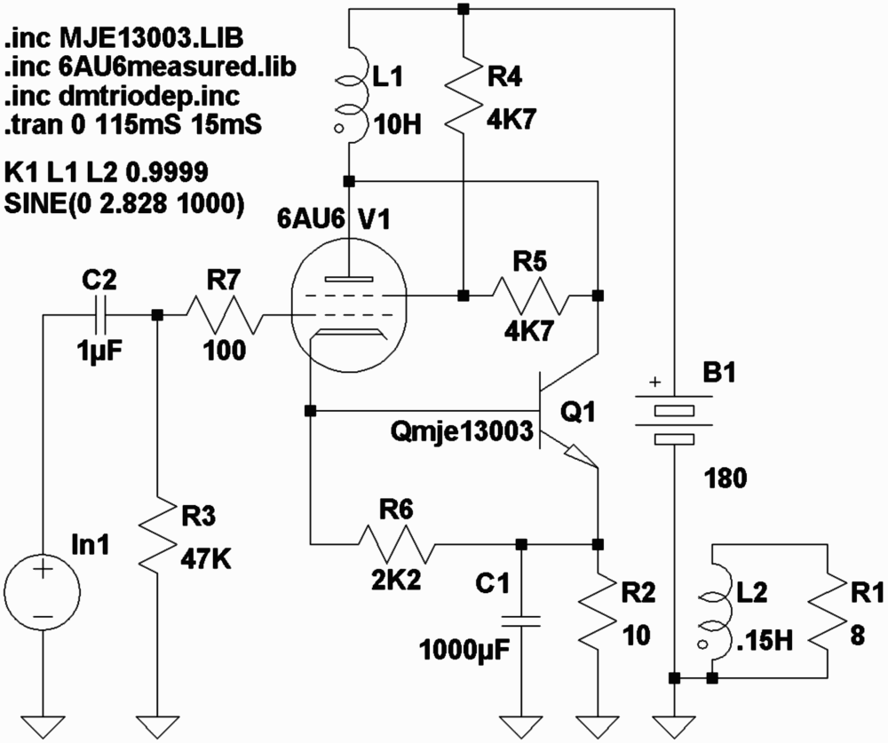

And this is the triodlington setup I tried to describe.
Sort of...
I ran into some issues with the transistor, mostly
cause I limited myself to those with spice models.
That stuck me with waaay to much HFE. +30 times
whatever the 6AU6 would conduct all by itself...
Sorta like 31 6AU6 in parallel, but not exactly.
Transformer primary impedance ends up about 533
ohms this way, which is lower than I was trying for.
Really needed a spice model for a horizontal sweep
or dynamic focus transistor with HFE around 10....
That would be a much better match for the 6AU6.
I also cheated and ran the 6AU6 in UL, rather than
as a triode. Mostly cause I needed to get both the
voltage gain and impedance up. Without completely
killing the feedback loop that allows the transistor
to share "Mu", and work as a voltage amplifier.
But the transistor needs as much governance and
control from the tube as it can get. Strapping as a
Triode would be preferable to UL, if the impedance
would just cooperate. Which again was a problem
than HFE was just too high in this example.
I might play more with this circuit sim at 300V and
see if I can trick it into working at a bit more
reasonable impedance. Or with a more suitable
bipolar.
The 6AU6 model was R McLean's.
The MJE13003 was a Motorola model.
I used a Tetrode symbol because the
spice model uses only 4 connections,
and complains when there's a fifth.
We all know there is a supressor.

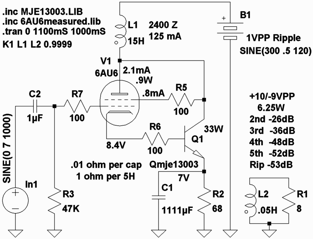

I just checked with 6K primary impedance.
Change the emitter resistance to 150ohms,
else you have pointlessly high idle current...
16VPP@47K in gets you ~16VPP@8ohms out.
Neither the transistor nor tube is cooking
itself anywhere near full potential. Thats
like 4 Watts out. Er something like that...
6K OPT needs to handle 60mA bias current.
With the resistor change mentioned above.

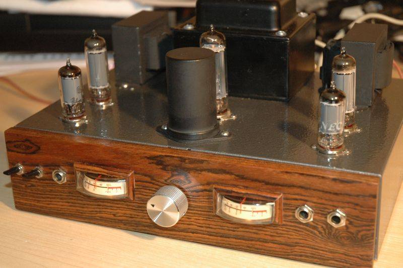

Kuroguy, that's a cool little amp! 😎 I especially like the meters; I'm assuming they're VU indicators.
Could you post a schematic? I've got hundreds of 6AU6's, and I was thinking of selling most of them at a hamfest or something 'til this thread appeared...
I don't really have a schematic. I salvaged most parts from a reel to reel. The schematic for the reel to reel is at http://www.tubesrit.com/audio/index.php?cat=5 . It is loosely based on that schematic.
Edit: Actually a cross between the r2r schematic and the radiotronics amp schematic also on that site.
