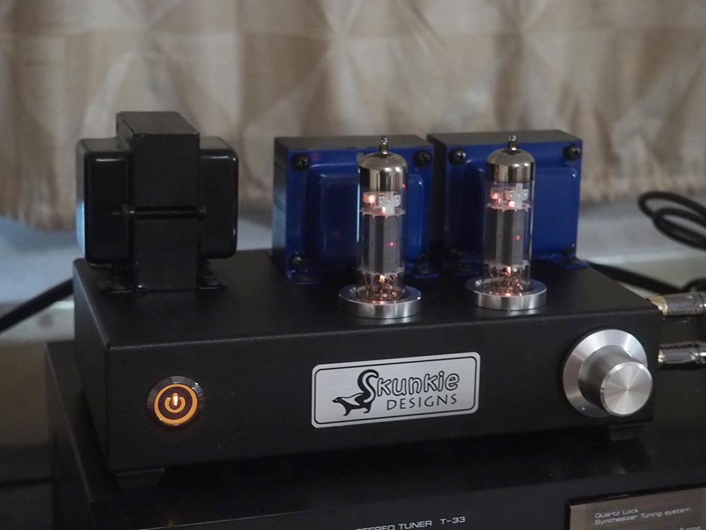

I did the usual 6EM7 mini amp with great results. I wonder how it compares to this amp? I went with a voltage doubler as I’ve never liked the idea of a switching supply in audio, especially in a tube situation. As far as OPTs, I’ve had good luck with Chinese units from HiFiEquis on AliExpress. They are a range of transformers available for very cheap but the shipping can kill you! It’s more than the transformers! I think they’re nice than the mid range Edcorel its crazy how good a little amp with a watt or two can sound if you don’t push it beyond what it is meant to do.
