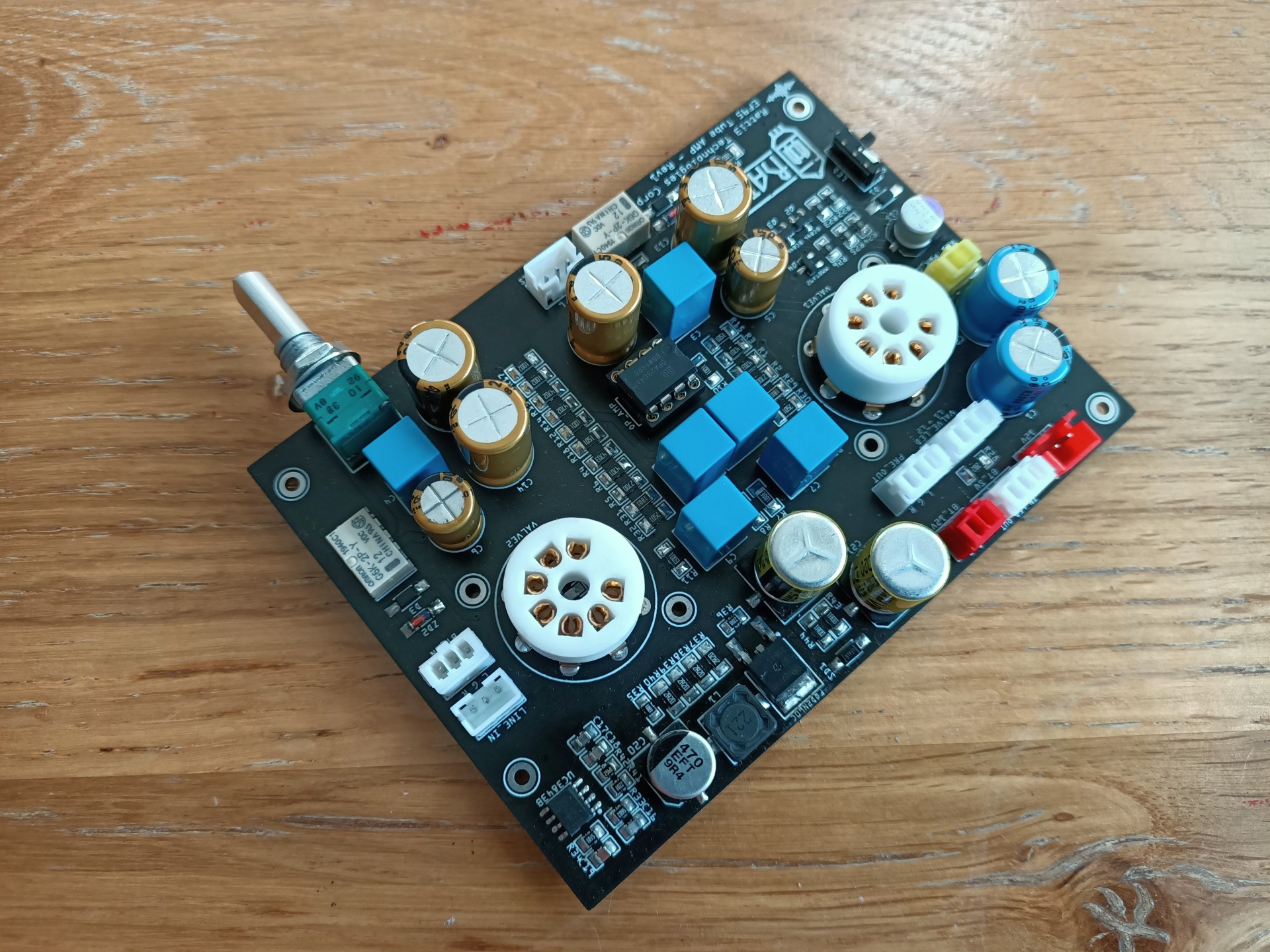

So I desoldered it and drew up a schematic, please note it is the first pass of my board analysis so there maybe a mistake or two.

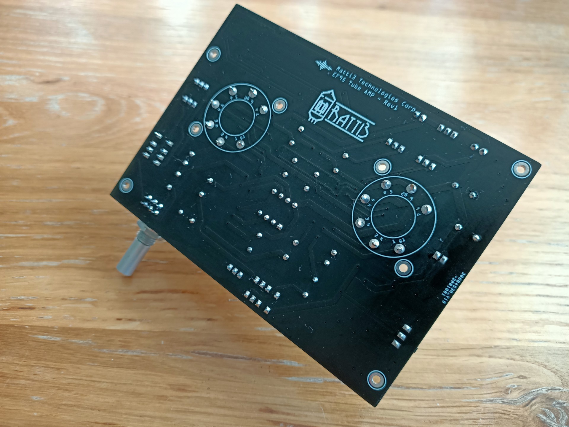

I love the simplicity of the design, however the pcb tracks were very poorly done, there were vias on the postive rail when it was completely unnecessary, the ground tracks were in a star format, and the soldering was poor.

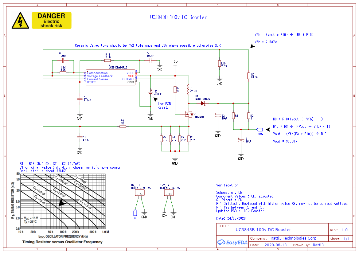

Hello again,
I haven't forgotten about this, just been busy with work.

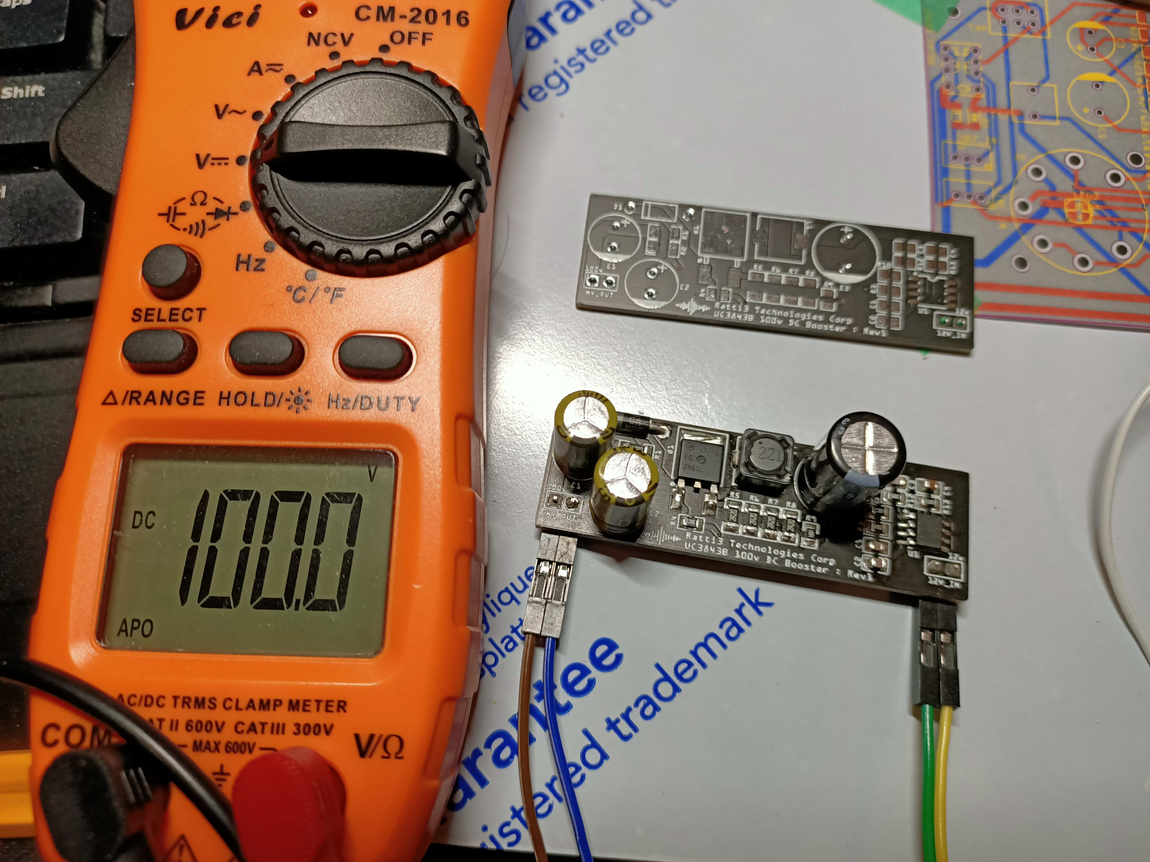

I managed to reverse enigineer the 100v DC booster and made my own version.
The booster is based on the UC3843B chip, I could not find any decent circuit diagrams for this, however I came across this:
Nixie Stuff | Threeneuron's Pile o'Poo
If you scroll down to "TI (Unitrode) UC3843 Based HV Supply" the circuit I reversed engineered is very similar.
So I did all the calculations and verified that the original circuit is indeed all correct and generates the 100v DC out as expected, so I designed the circuit in EasyEDA and made a very slight adustment to Vfb to produce exactly 100v out.
When I made the circuit and put it to the test I got 360v DC out! dang! I repeated the test and still same, so I examined the components and everything looked good, I then tested it again and got 100v DC out, what gives?
I measured the voltage (Vfb) between R3 and R10 and the correct voltage is shown 2.537.
Has anyone played around with the UC3843B, anyone have any thoughts.
Is it bad that I used a 100v Schottky diode on the 100v out (I have ordered some higher voltage ones)
Note: All components used are non fakes and high quality.
Attached schematic with Vout and Vfb calculations. (
Attached picture to show I really am getting a stable 100v DC out now.

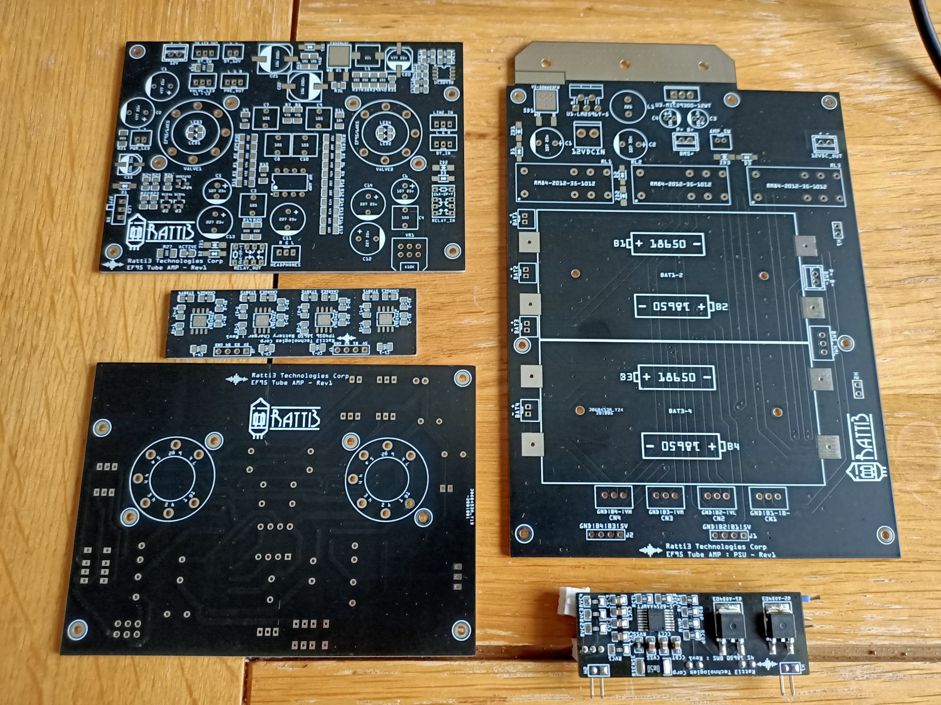

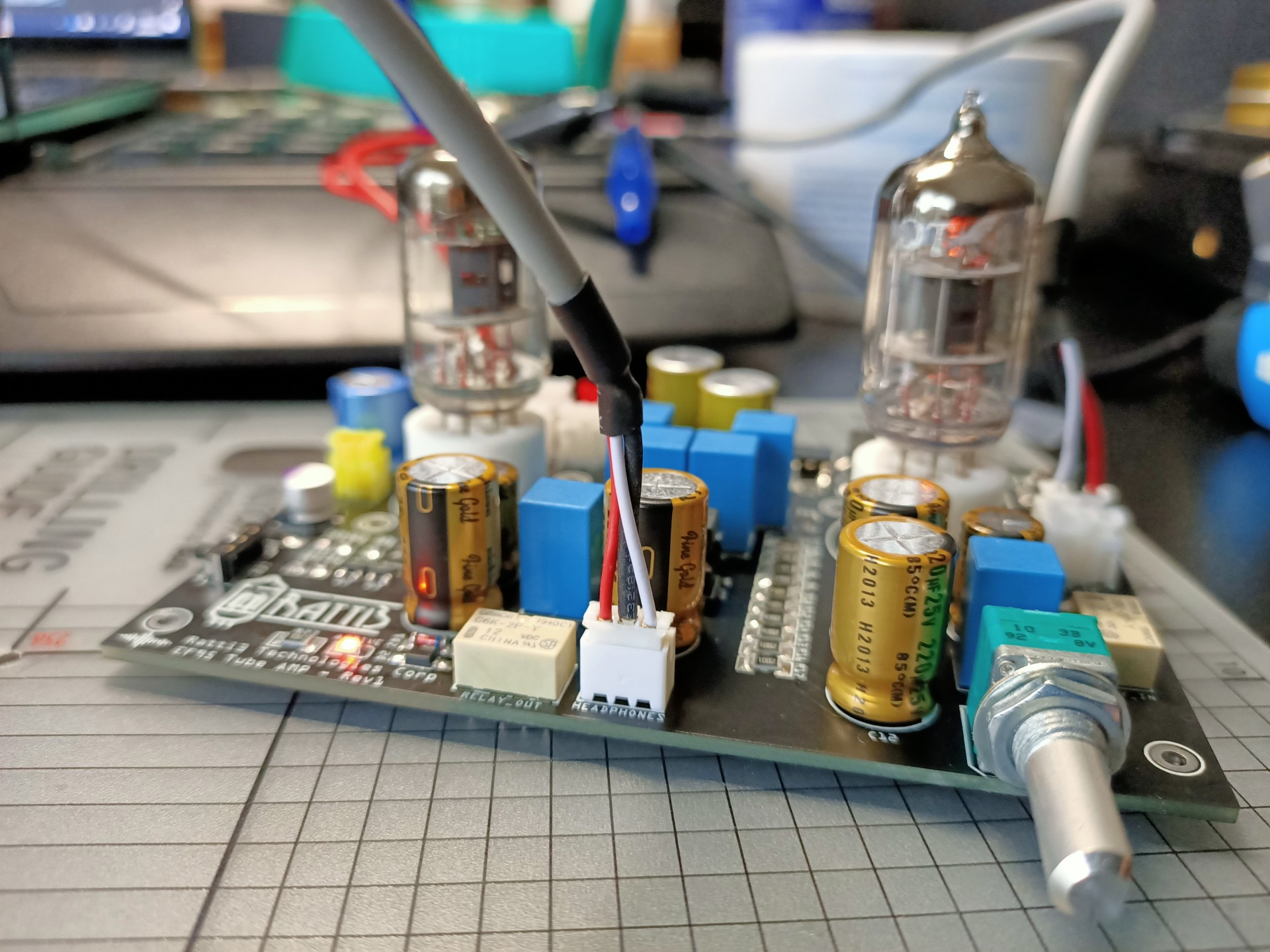

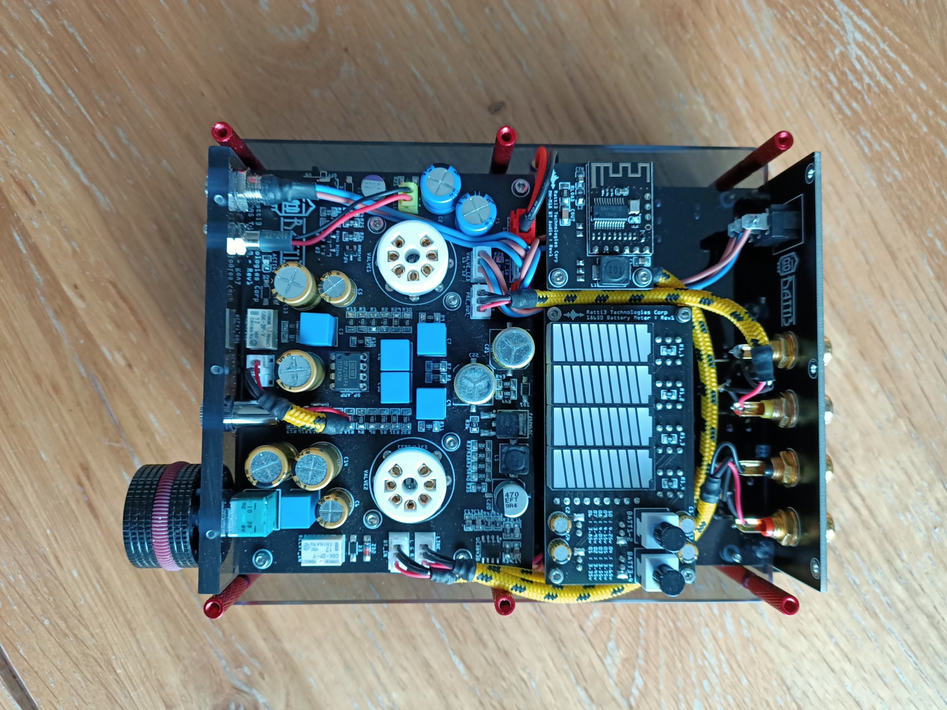

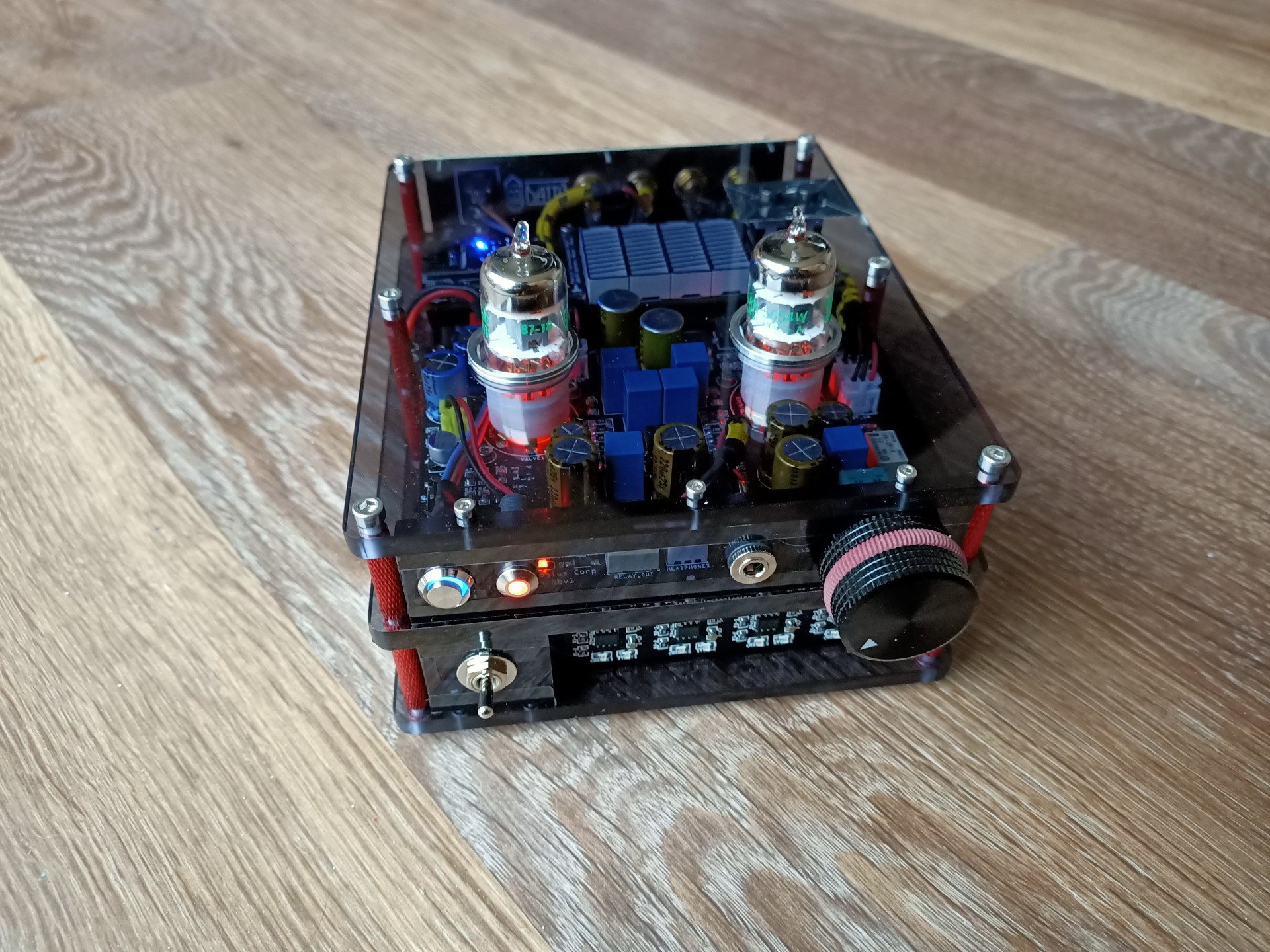

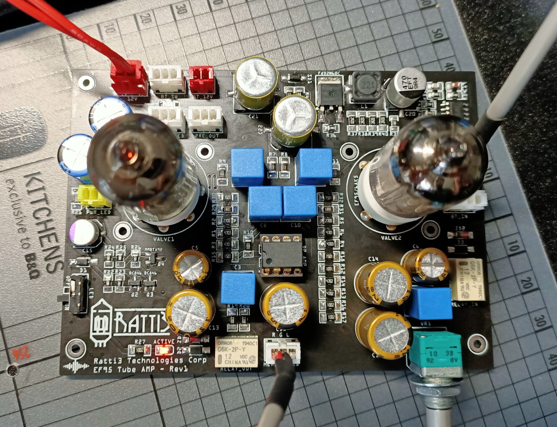

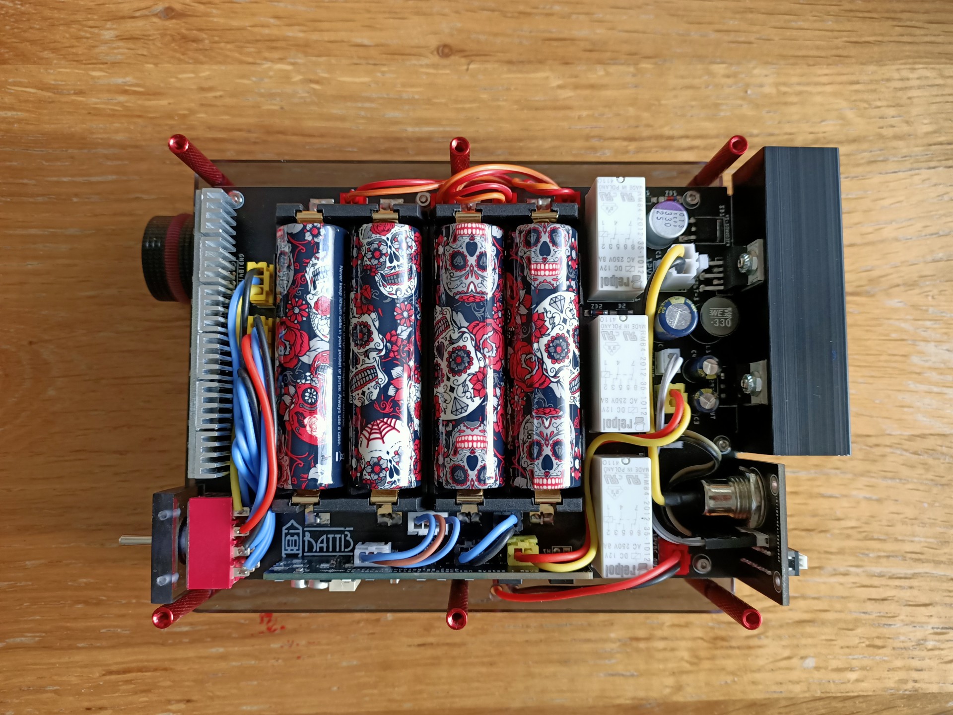

Ok, I've being making slow but steady progress. I've solved the issues I had (I think).
The tube circuit has been modified now after some research and feedback received here, I believe the schematic is now more a standard design. I've recalculated the bias and increased the plate voltage. I've also incorporated the DC HV booster on the main board.

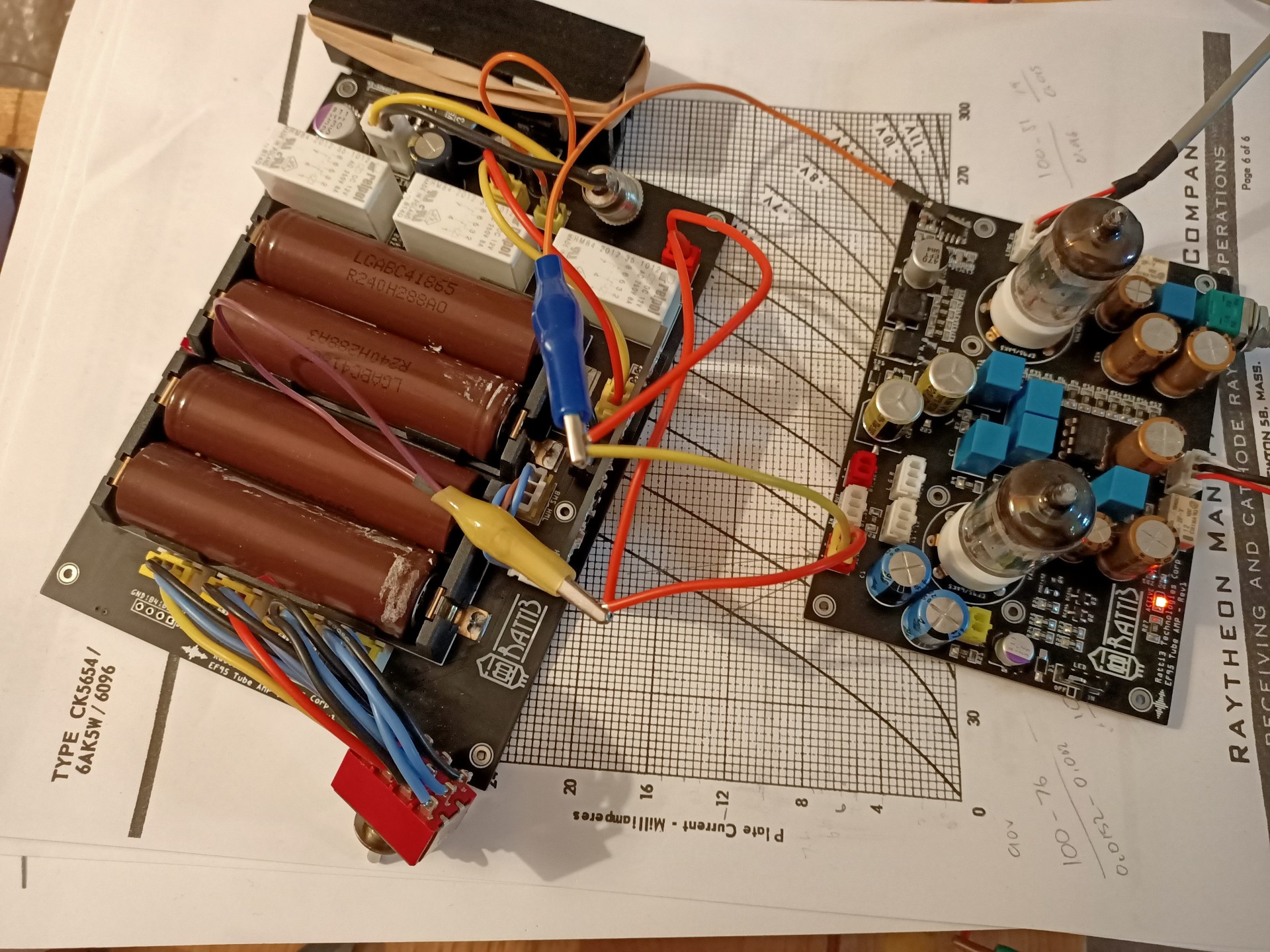

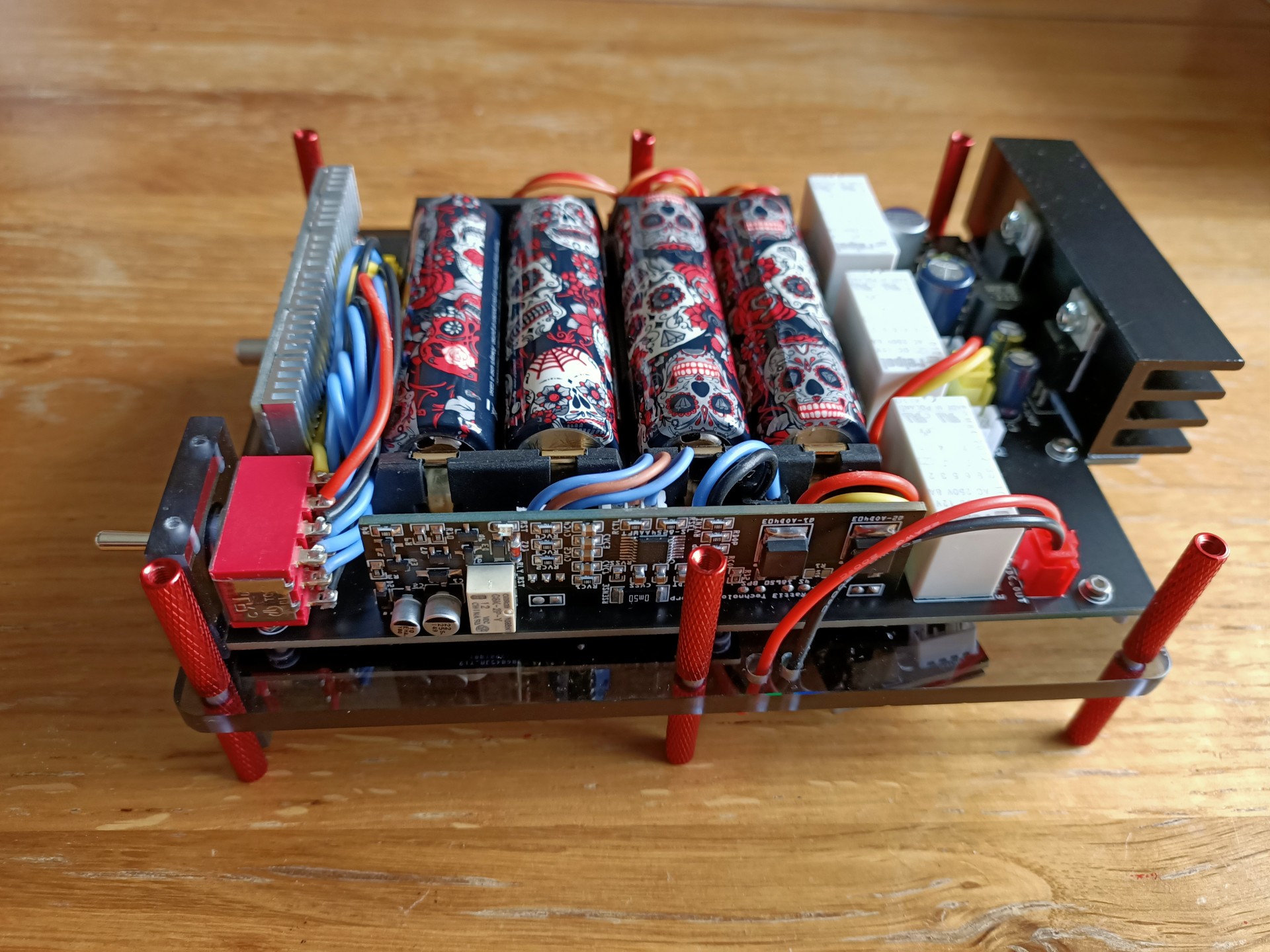

The amp now runs on battery (as well as mains if needed). A seperate board holds 4 18650 batteries, I made a protection circuit as well as charger circuit, it's all modular. The battery board has a buck covertor for supplying the battery charging module, and it has a linear 12v regulator for supplying a clean DC to the amp from the 16.8v batteries.
I'm redesigning the battery protection circuit to include a relay so the protection is not deactivate on startup. The build will also include a BT module and a battery indicator (not pictured).

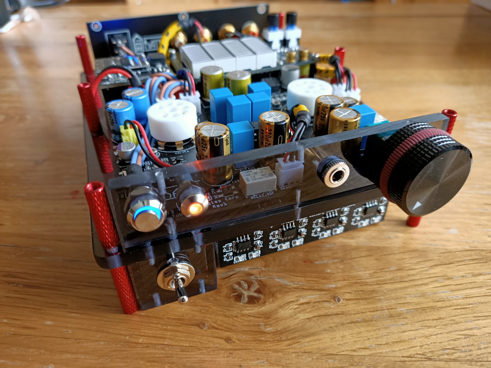

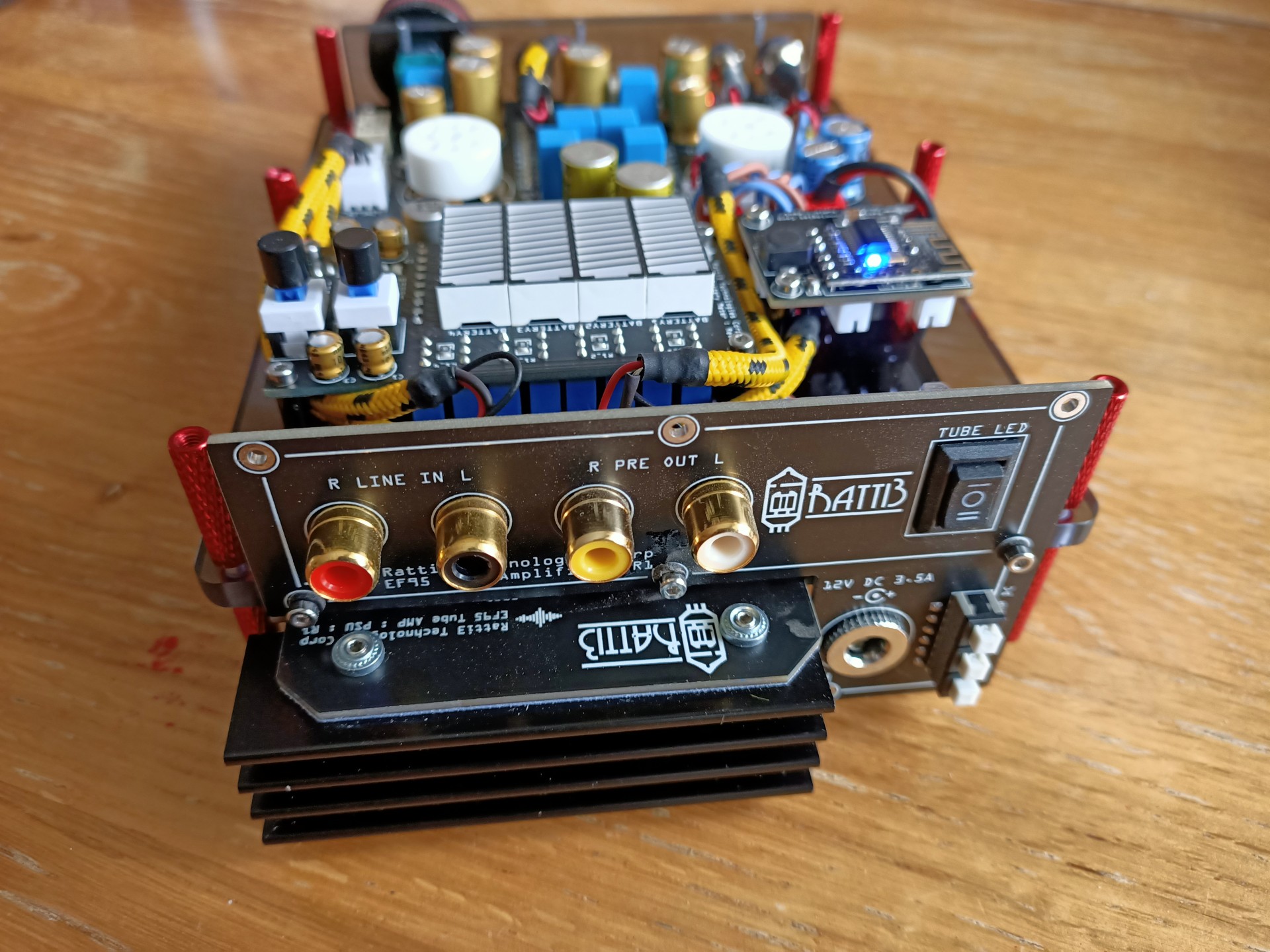

All this will be neatly housed in a perspec case. I expect the overall size to be 140mm(d), 60mm(h) and 122mm(w).
Everything you see here is what I designed and made.
How does it sound? Sounds great when running on batteries, no hum or hiss. I've not properly tested it running on the mains yet. Battery run time is 8 hours.

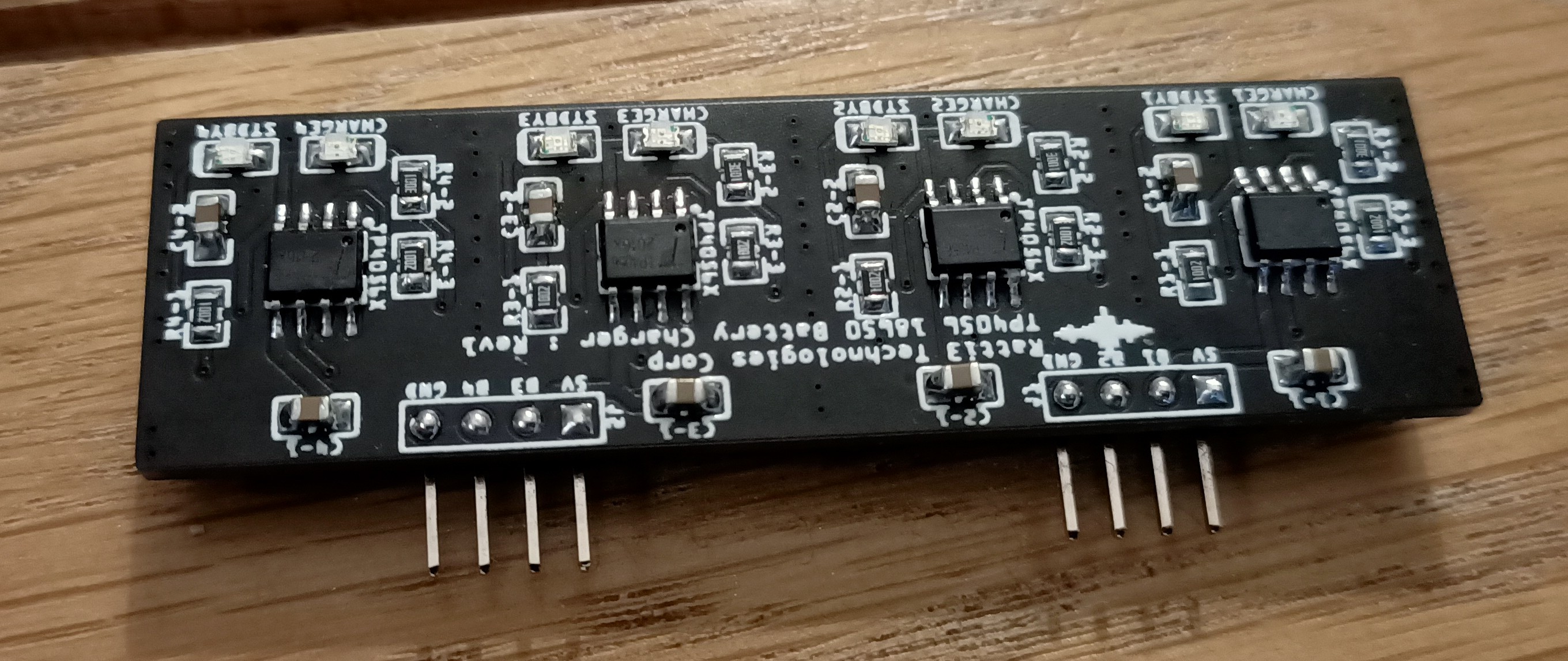

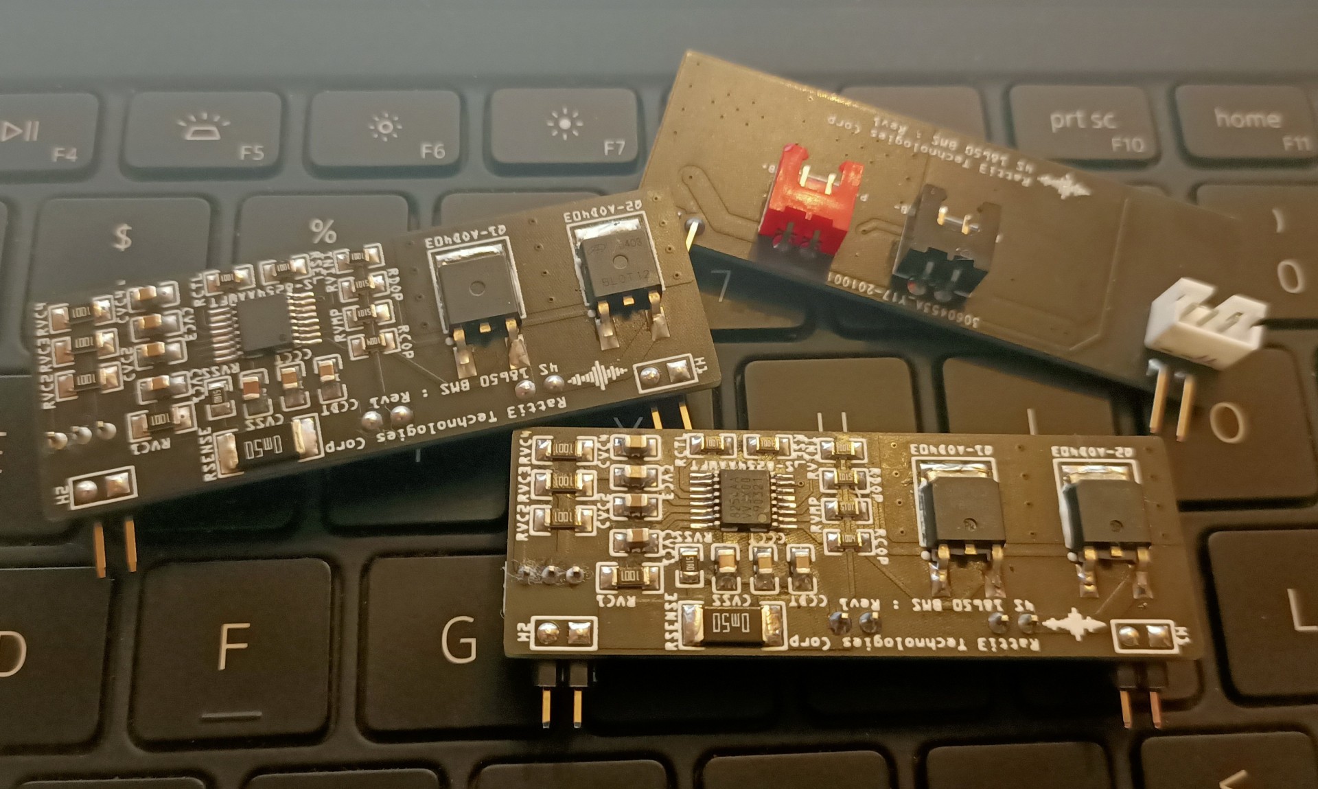

The PCB came for the battery protection circuit, I haven't had the time to make it yet. I redesigned the battery section to supply 4.55v to the TP4056 battery module, this reduced the charging module PCB temp from a finger burning 75degrees to 45degrees.
The battery protection cuts off at 3.2v as per design and the charge cutoff is 4.18v (0.2v below design - bonus), there is no balance as I didn't see a need for it if I use good batteries. The protection kicks in anyway when the cells go out of balance. I've also added extra functions like the ability to turn of the charger when plugged into the mains.
I've been listening to it for many hours, on battery there seems to be zero noise (could be because I'm 41 years old and starting to go deaf). It sounds amazing, I've tested with 2 decent heaphones that are 32ohms and nothing like HD600s, just Sony MDR-1R and Master & Dynamic MW60.
I did notice a faint hum while running on mains on the right channel, you can't hear it when playing music, now this could be due to nearby intererence, I haven't been able to test by moving it away from other electrical cables yet.
I don't seem to get any hum when I touch the exposed metal components, anyone know if I would get a mild shock with 100vdc? I haven't touched it yet accidently, I've touched 300vdc before and it wasn't nice.
I'm not done with the testing yet.

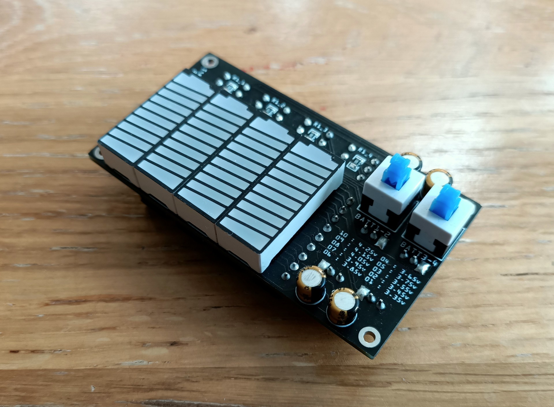

I had to redesign the bluetooth module as I forgot about the common ground loops you get with these modules, so I redesigned the PCB with mini DC-DC isolator, I've not made it yet.
I've also made a battery level indicator, not necessary but I like making things.
I've made the chassis for it, so not long left before it's complete.
All design changes and schematics will be published here.
