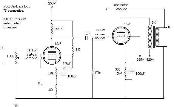

The 1625 is an interesting and less expensive alternative to the 807. Different base yet again and 12.6V filament. I'm thinking of an all 12V WE124 as I have enough tubes and sockets. Also have an decent power transformer with a 12.6V winding.

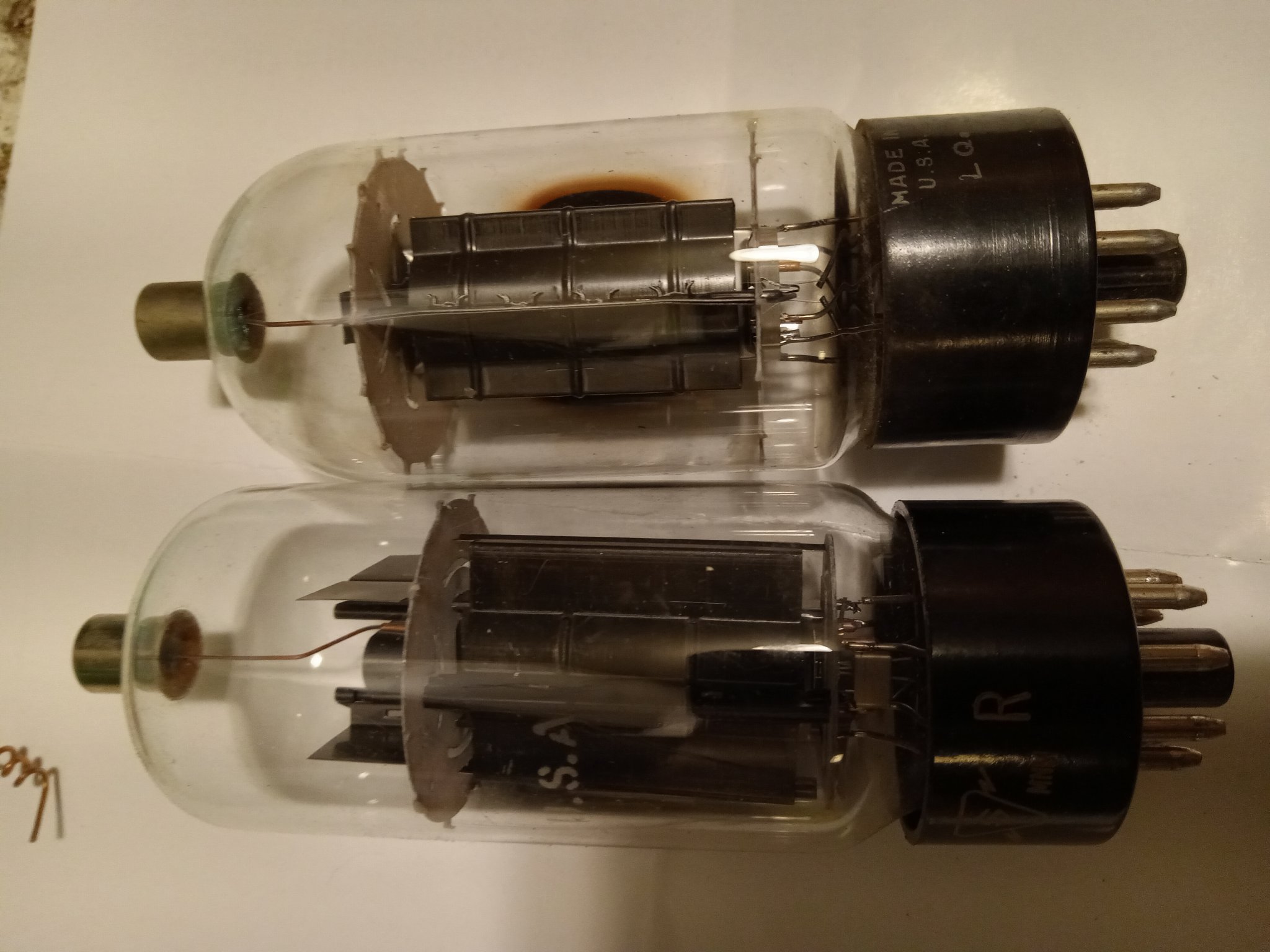

Sylvania 6BG6GA, AKA Super 6BG6. Power dissipation 30W, same as 6L6GC, and 350 V screen rating. Not all Sylvania 6BG6GA are Super. Super (bottom on the attached picture) is taller, has wide plate and big screen cooling flags.

I would second the 1625. Yes, they need 12.6v for heaters and a special (but easily available) socket, and have a plate cap. These are the kisses of death for commercial products (especially guitar amps), so NOS examples are everywhere, and used ones almost free. Built to ride around in jeeps for WW2, so insanely rugged. Curves of the 6L6/807 family. Buy a couple and hold them in your hand and you'll see what I mean. But don't tell anybody.
