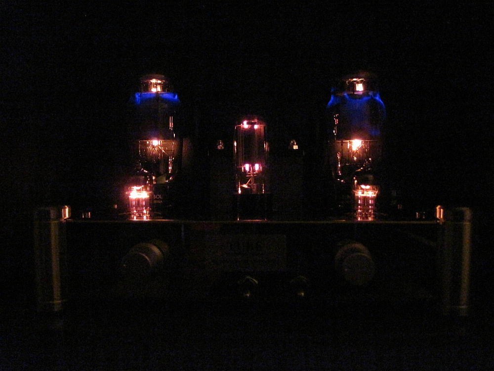

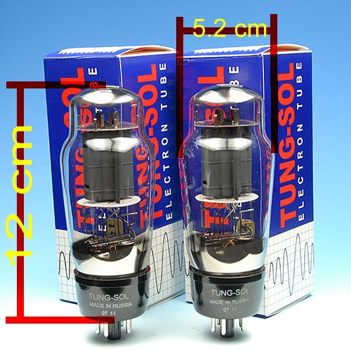

My experience and just opinion:
Pros: direct replacement of EL34/ KT66/ 6L6GC (same pin out, less heater current); strong construction; elegant; lack of microphonics; crystal clear mids, sweet and extended highs; 3D-focused; the less fatiguing tube I ever tested; doesn't require hot bias to run the best (16.4W/55ma); works perfect on SE and triode mode; plays voices more emotional than KT66 and EL34
Cons: overweight, larger than EL34/ 6L6GC; expensive (2x); less bass than EH 6l6GC that exibits more "fat" bass, more THD distortion than GL KT66 that runs somewere quieter; i didn't find nothing vintage in the sound (but just good sound)
...but be aware: only after a very long run-in (i.e. tens of hours), the valve will show all its qualities, so be patient...
So to me TS 6L6G and GL KT66 run the best, but if you need "bass" go for EH 6L6GC
Now let admire my night view.. this is by far umbeatable! 😛

I wonder though why a discontinued 6L6G would suddenly be so wanted as to warrant reproduction; I notice internal construction is still with the innards mounted on a glass tongue with in-base leads criss-crossing somewhere in the base. Retooling for such a deviation from modern on-pin mounting would have been expensive, seeing the possible low demand.
