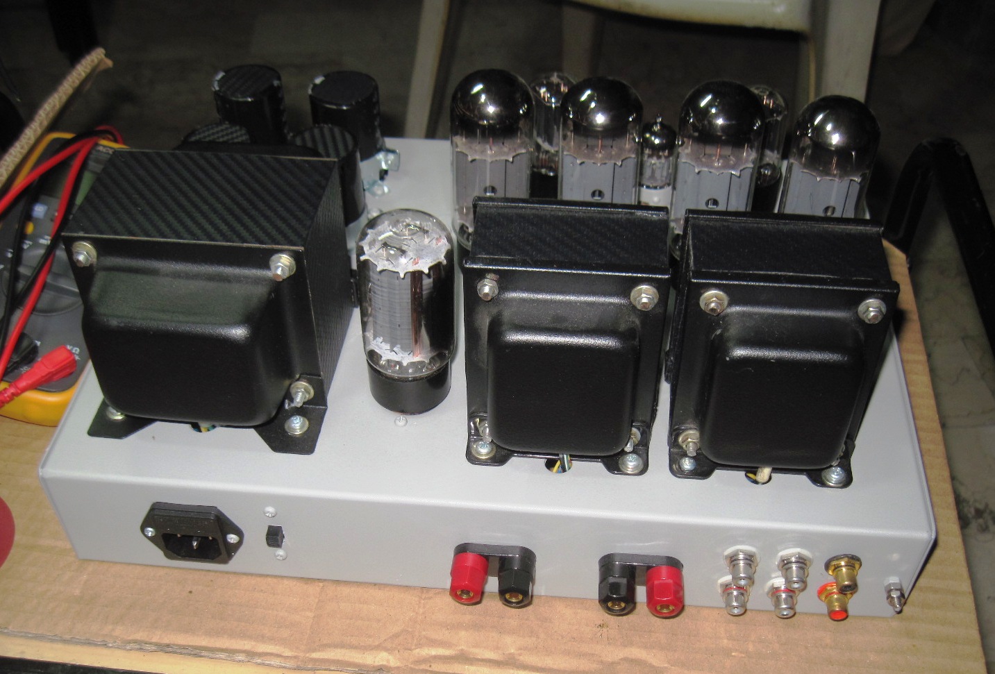

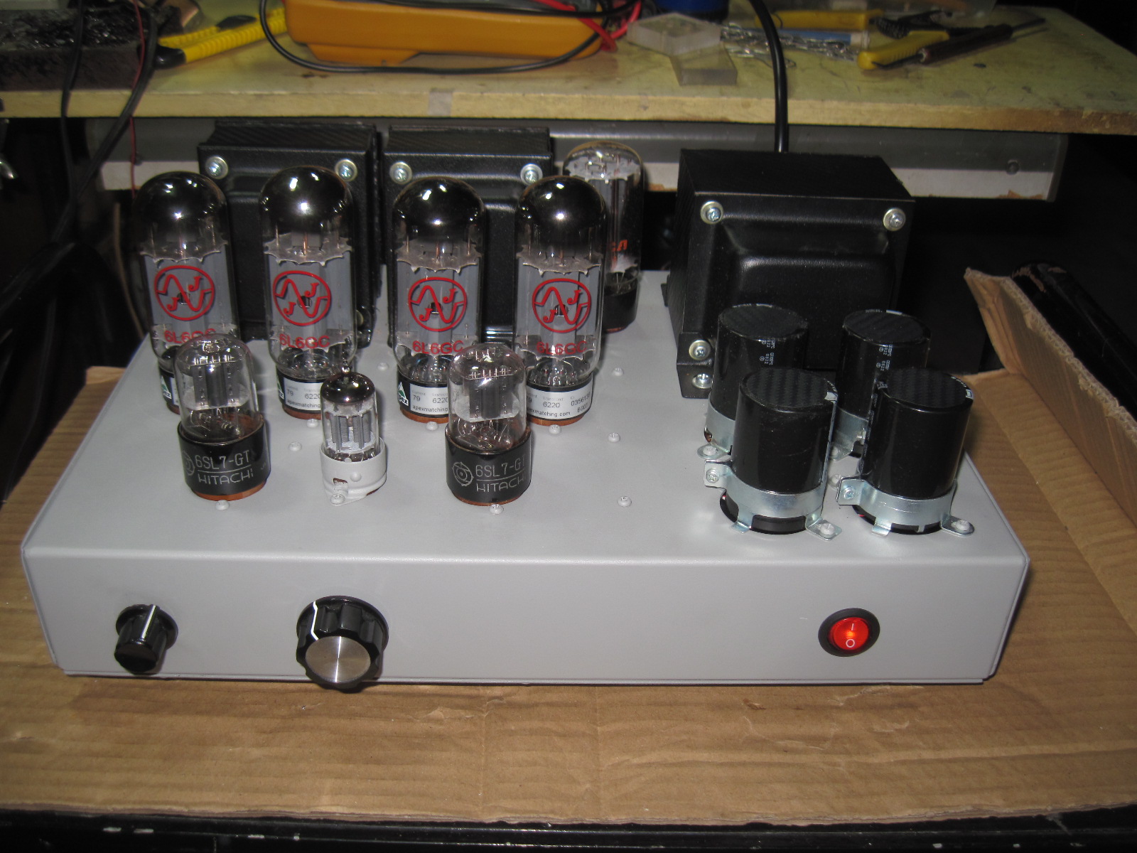

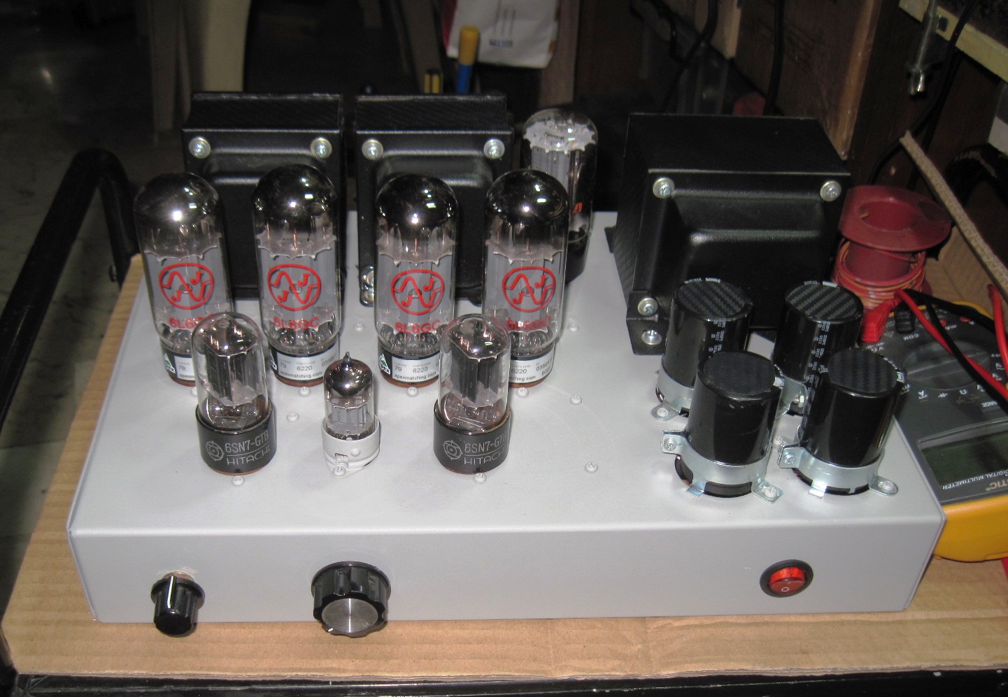

FWIW, i recently built an JJ 6L6GC ultralinear amp running on B+ of just 350 volts dc,
it sounded fabulous to my ears, 500 ohm cathode bias resistors on each cathodes with a 470 ufd 50c ecaps,

Ah yes; the good looking JJ tubes. EH also has the same appearance. Thanks for the photos! (Ltp type phase invertor/drivers?)
yes, 6SL7 long tail pair splitter, 5814 input voltage amplifier....
3DG4 rectifer...
