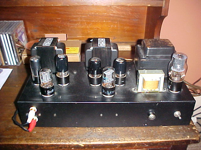

OK. Got parts, looking for a plan. 😀
Here's what I have:
Chassis with power transformer and power supply (about 300V B+ or so), and four 6V6 output tubes (already installed). Was a PPP mono amp... I'm wanting to convert over to PP stereo.
Output transformers- from Hammond organ amps- part # A024158. As used in the AO-44 PP 6GW8 and AO-35 PP 6BQ5 power amps. About 8K ohms CT primary: 8 ohms secondary. Probably capable of 12-15 watts.
I've built several Magnavox clone amps... looking for something different. Especially as these output transformers were originally intended for 8 ohm speaker loads, while the Magnavox outputs were made for 4 ohm loads.
I would like, if possible, to make this amp where it could TOLERATE 4 ohm loads on the outputs... which implies, to me, that it needs to, somehow, manage to decrease the effective plate impedance of the 6V6 output tubes- but without ultralinear operation (no taps on these transformers).
To that end, I was looking, briefly, at the feedback mechanism of Baby Huey... from the output plates, to the plates of the phase splitter. However, I know that it's been stated that Baby Huey probably wouldn't have enough gain to drive 6V6s in that application... my proposed solution would be to add one additional 12AT7/6201 tube as an input amp, for both channels of the amp (one side of the 12AT7 as a grounded cathode input stage, feeding into the Baby Huey-style phase splitter with feedback).
Now, I know these output transformers are NOT ultralinear... so that's another difference I've gotta deal with. But, with the amount of gain I can get from TWO gain stages (the grounded cathode input AND the modified-LTP phase splitter), I think I should be able to get back the low output impedance, fairly well...
In essence, what I'd really like to do, is try a non-ultralinear Mullard-style circuit, with triode front-end gain stage, but with Baby Huey-style feedback from the outputs to the phase splitter... anyone got any WAGs on whether this sounds like a feasible idea? Or, given the parts I listed above, is there an easier plan that would work well (to get low output impedance, with decent overall gain)?

hey-Hey!!!,
I've come to question the 'lots of gain needed' philosophy.
There are a few means to deliver local FB. The Gary Pimm 47 amp is one, the RCA SP20( or single pair version http://mysite.du.edu/~etuttle/electron/elect35.htm ) work really well. With U-L taps there is E-Linear, though that does best with pentodes up front, or better still Cascode.
Short story IMO is that if you build with a low gain single stage up front, it is quite easy to modify with a higher gain element later if you've guessed badly wrong( not likely ).

Bandersnatch said:hey-Hey!!!,
Looked at that RCA design... only problem, with those pentodes, it would require more "bottles" than I have room for.
Hence, the idea of modifying a triode-front-end Mullard... that could be done in stereo, with just three twin-triodes...
Though, the basic idea of the feedback scheme on the RCA might be a good option. I'd think going from plate-to-plate might be easier to implement, however... Bricktop over at AK certainly got that to work easily enough... and it seems to have the added benefit of helping stability and bandwidth on the top end, too...

Well, I did some calculations...
Looks like with my original idea (12AT7 front end/12AU7 LTP), I can get, before feedback, a gain of about 32 from the first tube (no cathode bypass cap) and about 7 from the LTP.
Comparing that to the Magnavox AMP175 clone I built before (also with 6V6 output)... it had a SINGLE gain stage (12AX7) of about 50 or so (the phase splitter is a paraphase- NO gain).
So, that gives a total preamp gain (first stage times LTP) of about 224. If you divide 50 into that, I've got about 4.5 times the gain of the Magnavox design... which had PLENTY of gain to run from any preamp I hooked up to it!
That means, I have a gain factor of about 4.5, to throw at the internal feedback loop.. about 13.5 dB. Which leaves a gain there, after internal feedback, of about 1.5... not a bad place to be, since the first stage can swing plenty of voltage (probably 40-50 volts, where I only need 25 or so, MAX). Or, I can go down to 10dB feedback to the LTP and up the feedback on the global loop 3dB over what Magnavox used... whichever sounds better...

Gordon,
One of the Baby Huey variants I did was a modification of a Chinese Music Angel PP EL34. It was very close to what you have described. Details are here:
http://www.diyaudio.com/forums/showthread.php?s=&threadid=78712&perpage=10&pagenumber=3
You can use that for a few "ideas" to be applied to a 6V6 variation.
I have been "itching" to try the Gary Pimm PP47 arrangement with 6AU6. It fits the "Theoretical" requirements.
The clue to the Baby Huey arrangement is that the diff amp needs to be low current (say less than 1mA per side and preferrably about 0.6mA per side) so as to not load the output stage excessively.
That diff amp also needs to be high rp. The shunt feedback voltage is being divided and the "lower arm" of the voltage divider is the load resistance presented by the next stage in parallel with the impedance looking down into the anode of the diffamp sides. That means the tube stages of the diff amp need to be high rp. That means a 12AX7 or a penetode (6AU6) or a cascode. It also means that you cannot simply connect fixed biased 6V6 with Rg1 value of 100K max. directly to the diff amp anodes but must impedance buffer them with mosfet source followers. The ZVN0545A that was recommended above is a great device for this (VERY low input capacitance and Crss).
