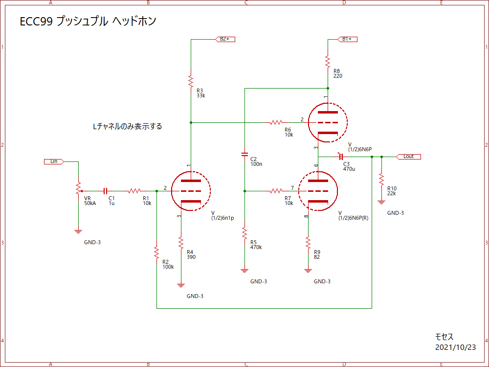

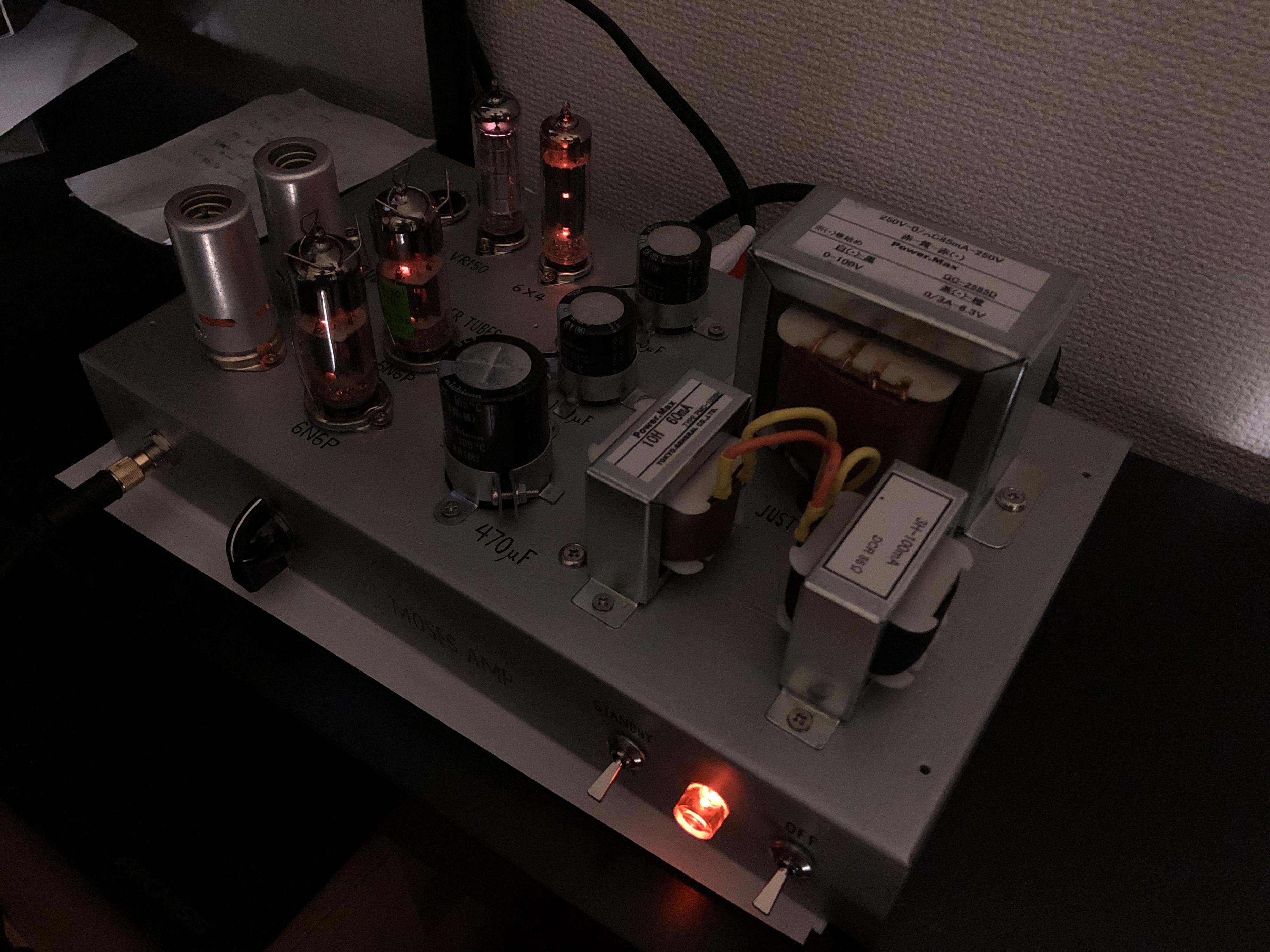

I have built a tube headphone amp with following power supply.
I got transformer with only single heater supply and a pair of 6X4 so I designed a power supply using rectifier tube with shared heater supply.
The heater supply MUST be virtually grounded using 220R (in my case). But this would cause negative potential voltage between heater and cathode which is around -280V in my case. I know the negative potential voltage of 6X4 is rated 450V which my amp should be and it's being working without problem. But this make me worried cause my people said this might cause short between heater(GND) and cathode(HV) and blow all the tubes. It just a matter of time, they said. They suggest me to get another transformer for 6X4's heater which I am going to do. (6.3V 0.5A should work well🙄)
But outside this solution. Where should I put my fuse when I'm gonna prevent heater-cathode blowing? Or any other suggestion? (including 'don't do anything' one)

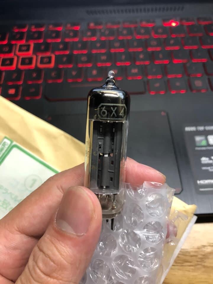

It's Toshiba NOS from Showa era.
I have no knowledge to test it, neither equipment.

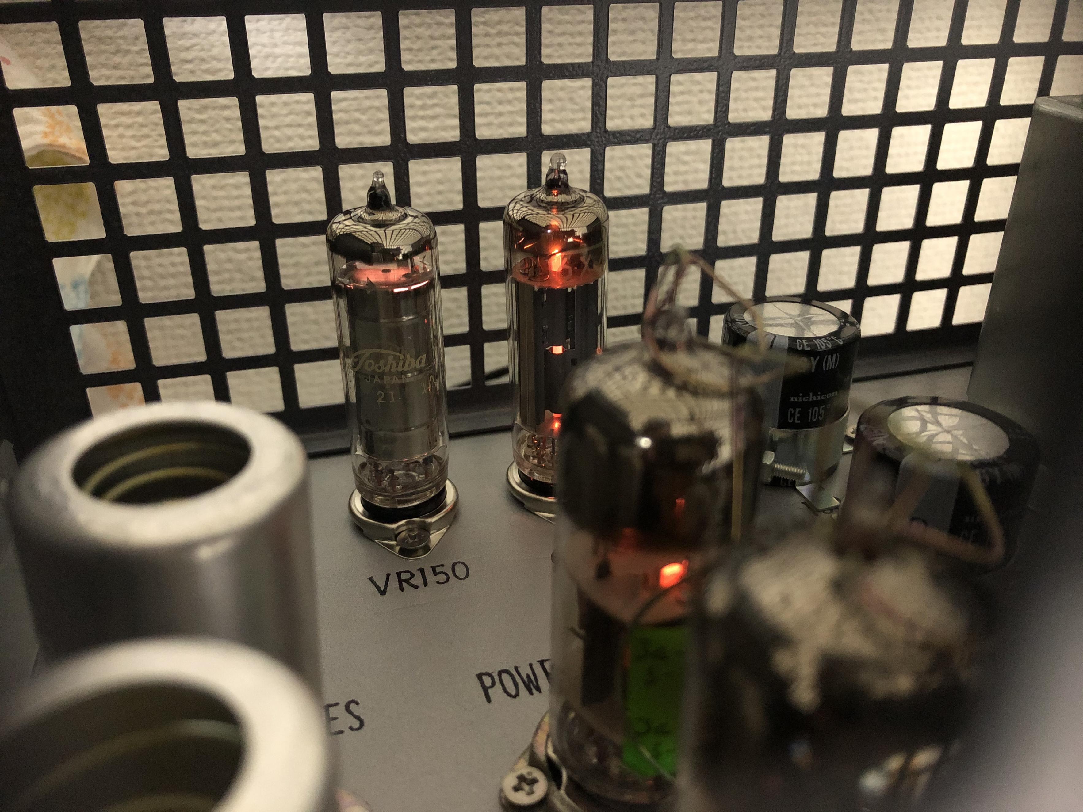

Attachment1: 6X4 when arrived
Attachment2: 6X4 (right of VR150) on duty

Very nice amp!
I stick to my vote of post #4. But the third suggestion of trobbins in post #3 looks like a safety measure that's easy to install.
Very nice amp!
Thanks! I will try to get 6X4 less stressed.
