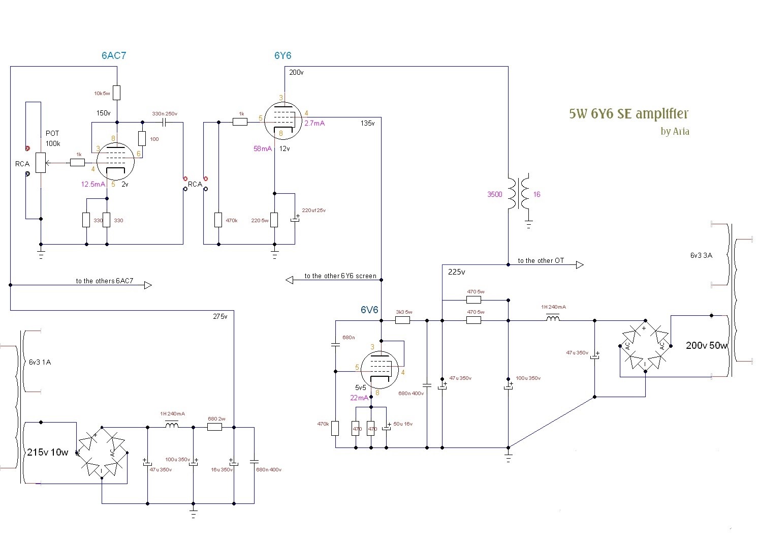

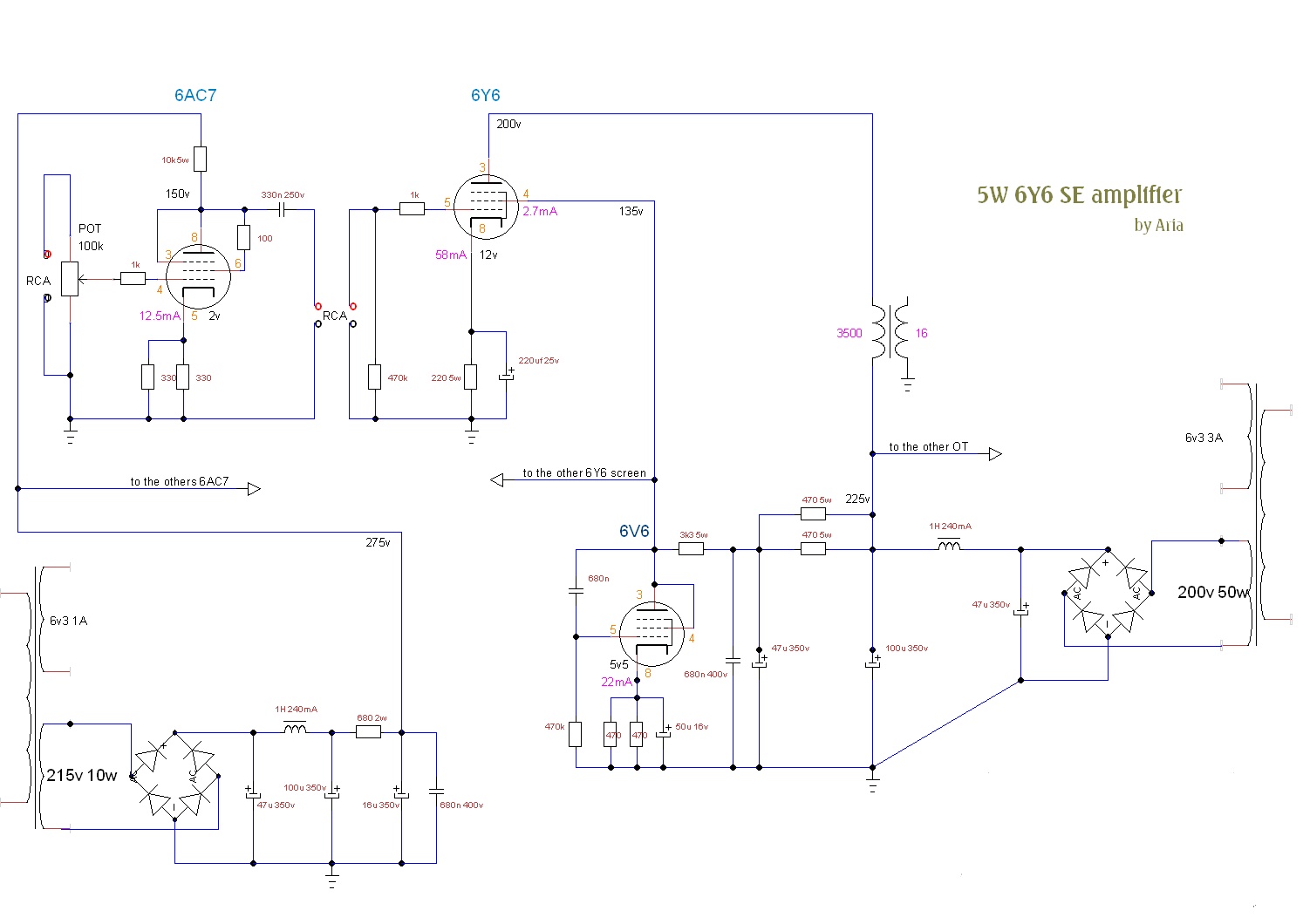

In the end this is what I built ... transients tested and listening tests ... it sounds fine (soon I will post a small video of the horrific creature). I hope I didn't make any mistakes in transcribing it to TinyCad.
Write me if you have any questions, suggestions or complaints ...
(WRONG SCHEMATICS!)
(the right schematics at #3)

Good to see that you finished this project.
I assume the 6V6 has to function like a ripple killer. I would think for it to function properly, the topside of the 680 nF capacitor has to be connected before the 3K3 resistor instead of after it, like it is now. But maybe this is a drawing mistake in the schematic?

In fact there was a transcription error...
Are you there now?
I meant the 680 nF capacitor between pin 5 and pins 3+4 of the 6V6 but by now I doubt if my earlier post was correct, so just forget about it.

6V6 works as voltage regulator (135v needed) and current shunt. It should work more or less like a cold cathode voltage regulator.
6AC7 it is a good alternative to 1/2 ECC88 with a slightly higher Ri and a consequently slightly higher gain. The output resistance in this circuit is approx. 5k quite acceptable.

There is only one thing that I just don't understand: because on the last capacitor of the preamp power supply there always remains 30v ac. even when the appliance is switched off.
You could place a bleeder resistor of 1M parallel to the 100 uF capacitor. This will let the capacitors in the preamp power supply discharge themselves after switch off.

I'd like to understand why... I have some doubt with 16u cap which Is used.
One of the advantages of the shunt regultaor is that, using on the bias of the shunt regulator a 100 ohm resistence with a pot 500 ohm in series, it is possible to test and use all the most common pentodes, such as 6F6, 6K6, 6L6, 6V6, 6W6 and the European EL34, EL84 and EL95, and then adjust the correct screen voltage with a tester. For the function it performs, the tube should last a very long time.

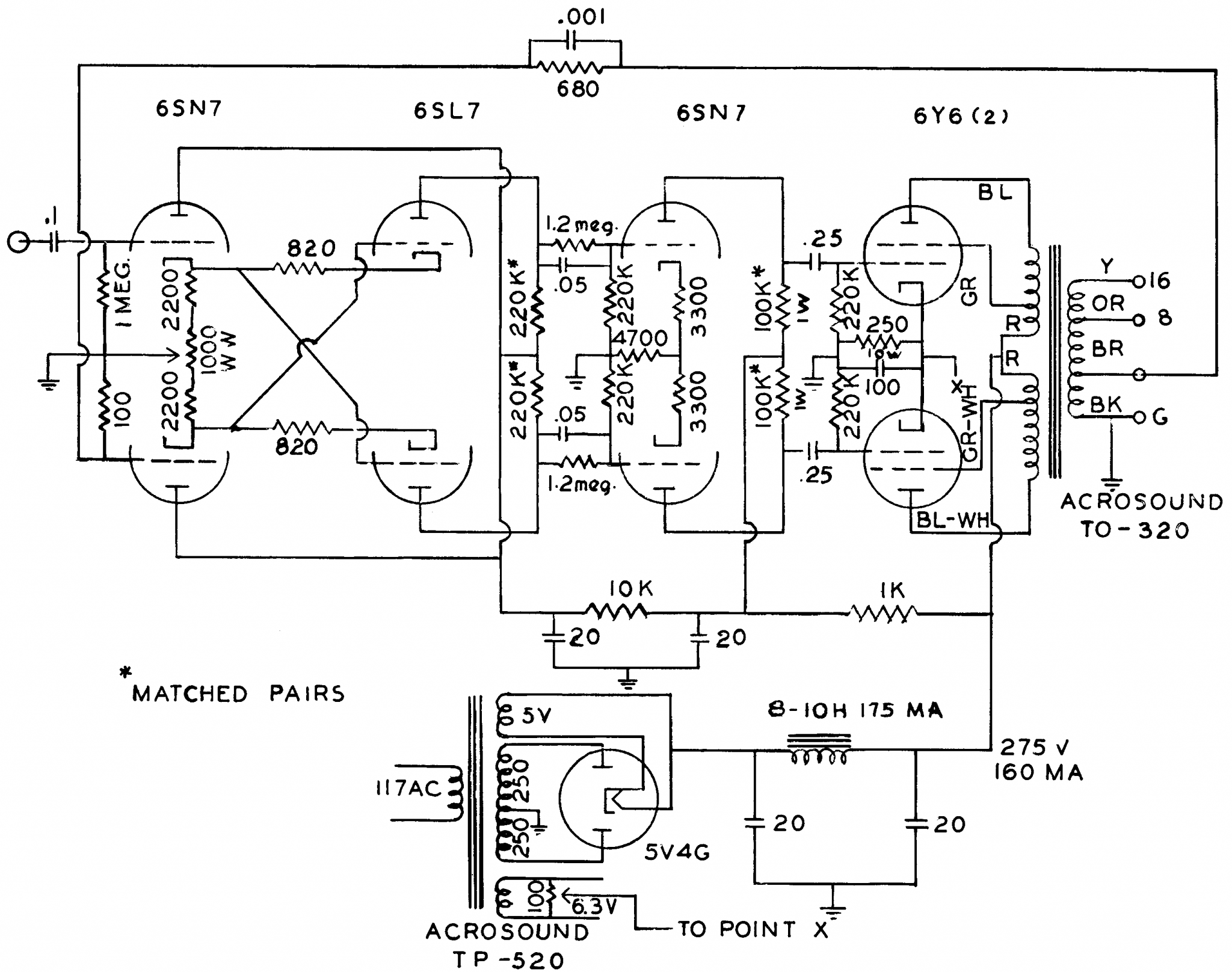

Thanks a lot for this info. This is why I'm a newby! Looking at some old schematics for this tube it was mostly used as PP, screen was hooked directly to the UL taps. I did find some other schematics for SE/UL from DY'ers that used a 40-50k resistor, thats where I got the idea to do this. Looking at the data sheet again, it doesnt name a max G2 voltage, so perhaps I can use a direct hookup to the UL tap (just like the old Acrosound 320 amp did, but for SE? Or maybe experiment with some very small resistors under 1k. I was thinking the g2 had a max voltage. If it can run ok with direct hookup to the screen taps in PP, it should be ok like that in SE right?
https://frank.pocnet.net/sheets/127/6/6Y6G.pdf
The old 1955 Acrosound 320 with 6Y6 (this is the amp that was well regarded back then) Of curse thats mainly due to the Acrosound.
From the datasheet I deduce that At Va = 200 V, Vg2 = 135 V and Vg1 = - 14 V, the value of the cathode resistor would be something like 200 to 220 Ohm. In the Acrosound amplifier the value of the common cathode resistor is 250 Ohm, which would 'translate' to 500 Ohm for only one 6Y6.
The fact that Acrosound amplifier was running the 6Y6's well over the maximum voltages must be proof of their capability to withstand this (an other example is the 12A6). But the current with no signal can't be that high (in view of the maximum anode dissipation) and I think this amplifier runs in Class AB. I would think that if you 'translate' these conditions to SE, so to Class A, the output power will be relatively low.
Just my thoughts.
