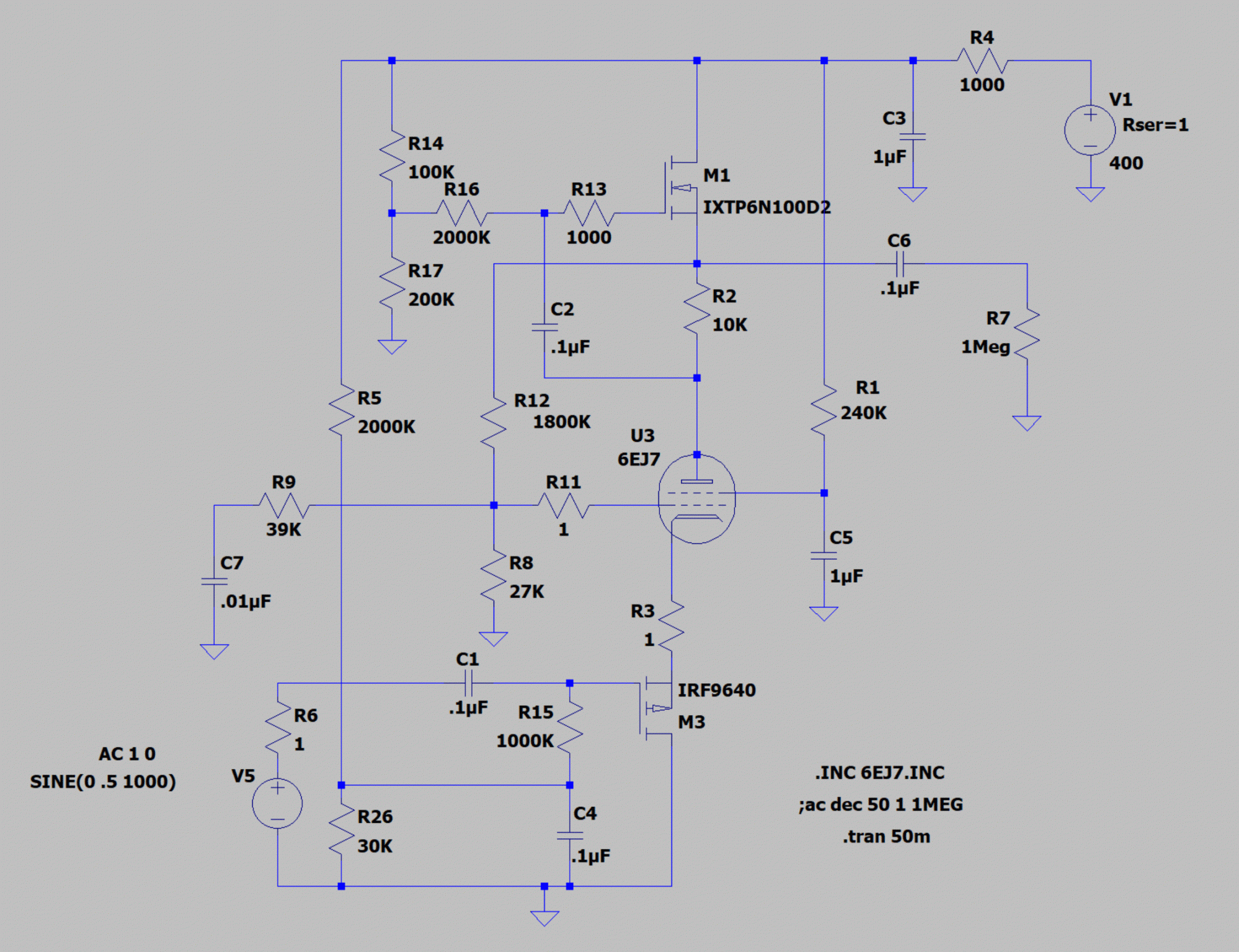

The 6AU6 is the closest and was the tube that took the 6SJ7's place in the venerable 5 tube AM radio. There is a long list of tubes that are pin compatible. See the UNSETURATOR tab in my long running "spreadsheet of tubes." All of the 7 pin tubes listed have been tested in the UNSETURATOR circuit and verified to work, including the 6AU6 and 6AK5.
I have been experimenting with "reinventing the guitar amp" using something other than the usual FMV clone circuits. There will be at least one preamp channel in whatever I build that uses a pentode in the first stage.
There was a Hundred Buck Amp Challenge contest here that ran back in 2011. My low buck entry used a pentode input stage. After the contest ended, I proposed an elimination of the "no sand" rule and suggested that the thread be allowed to remain a place to post low cost guitar amp designs. It is now a sticky at the top of the instruments and amps forum. The 4 tube low buck design got refreshed with some design changes some silicon and reposted. It is the only working guitar amp that I still have from that challenge. The schematic of the amp is included. The 18FW6 is a 6AU6 with an 18 volt 100 mA heater. R9 is a pot, and it directly controls the gain of the input stage as the load resistor R5 is bootstrapped and appears to be nearly infinite. Many pentodes are microphonic at large gain values since there are three wire grids instead of one. This amp can go from very clean to overdriven mayhem at about half throttle on a 1 meg pot. I stuck a 2 meg pot in mine and I get acoustic feedback from the speaker to the amp head at full throttle. Talking into the back of the cabinet puts your voice in the speaker with some strange sounding reverb effects. I called this circuit the saturator since the input tube can be fully saturated from any guitar I tested at less than full gain.
I devised another circuit I called UNSET which was intended to get triode like curves from a TV sweep pentode without violating the screen grid specs. In the just to see what would happen department, I blended the saturator and the UNSET together into one stage and created the UNSETURATOR. I was expecting overdriven guitar amp mayhem, but was surprised with the cleanest vacuum tube gain stage that I have ever made. Gains in the 50X range can be obtained at THD numbers under 0.2%!

Here's what I have so far. It's still basically the original GA50 circuit.
The 'partial' NFB around the output stage only really works on the high frequencies. I think that's a lot of what makes this amp sound the way it does. It never goes into rock n roll breakup, and that's fine with me. It's dark sounding, with very little treble boost because the gain at higher frequencies is attenuated by the NFB. That's also fine with me.
I've attached the original Gibson GA50 schematic (PDF).

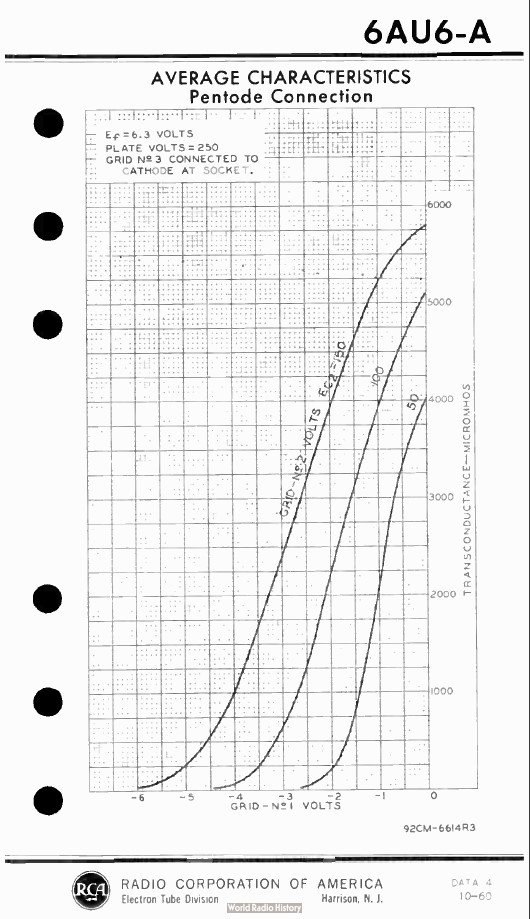

It looks like 6AU6/6J4P/EF94 is designed to be run with 10mA plate current (Ip), yielding gm of >5 mA/V.
6SJ7 operating conditions are shown with Ip = 3 mA, yielding gm of only 1.65 mA/V.
The GA-50 circuit puts only 1 mA of Ip through its 6SJ7.
If I run a 6AU6 at Ip = 1mA and Vg2 at about 70V, would it have similar gm to 6SJ7?

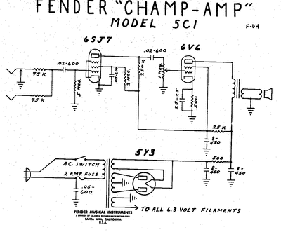

I did not understand what was going on when I was a kid, but I now know that "bonkers" was a severe case of blocking distortion caused by jamming 9 volt peak to peak square waves into the input of the guitar amp. The original Fender Champ 5C1 had an input coupling cap and a large 2 or 5 megohm grid leak resistor with the cathode tied directly to ground. Slamming a big signal into this input turned the G1 / Cathode interface into a rectifier creating a large negative voltage on the grid driving the tube into cutoff. The 6SK7 took a lot more negative voltage to cutoff the plate current. Eventually Mr. Ham Radio guy showed me how to convert the stage to cathode bias which solved most of the overdriven cutoff issues.

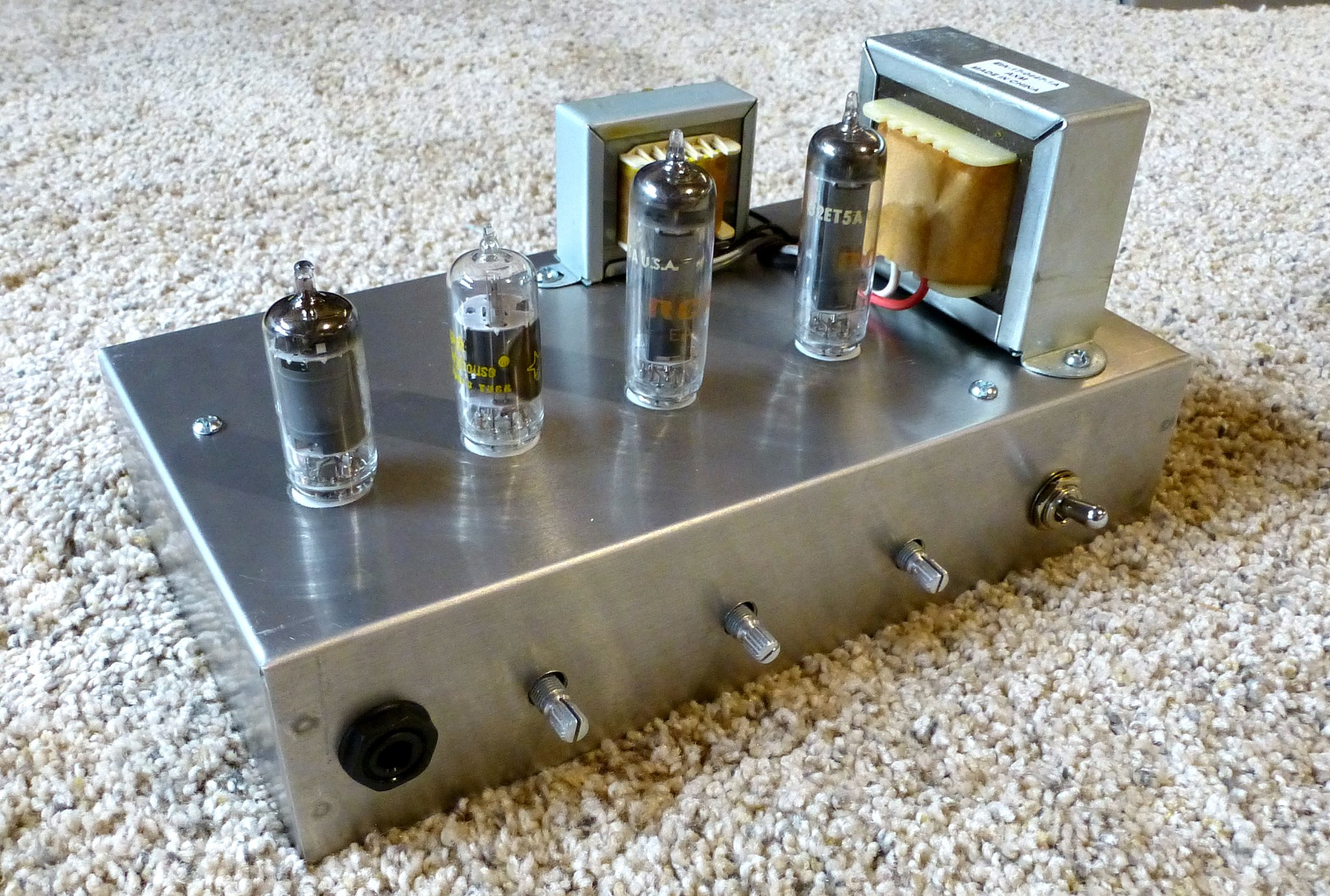

The 4T-11-10 amp schematic that I included in post #4 took several days of tweaking with several different guitars and FX devices including an old germanium fuzz pedal that I built in high school, a Vox Tone Bender clone.

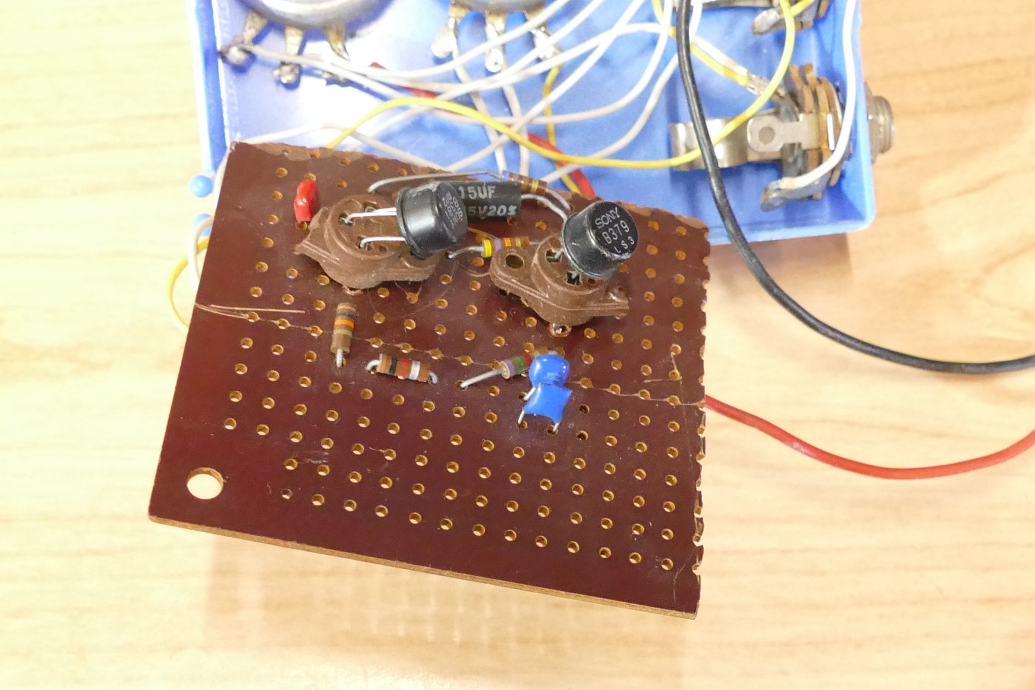

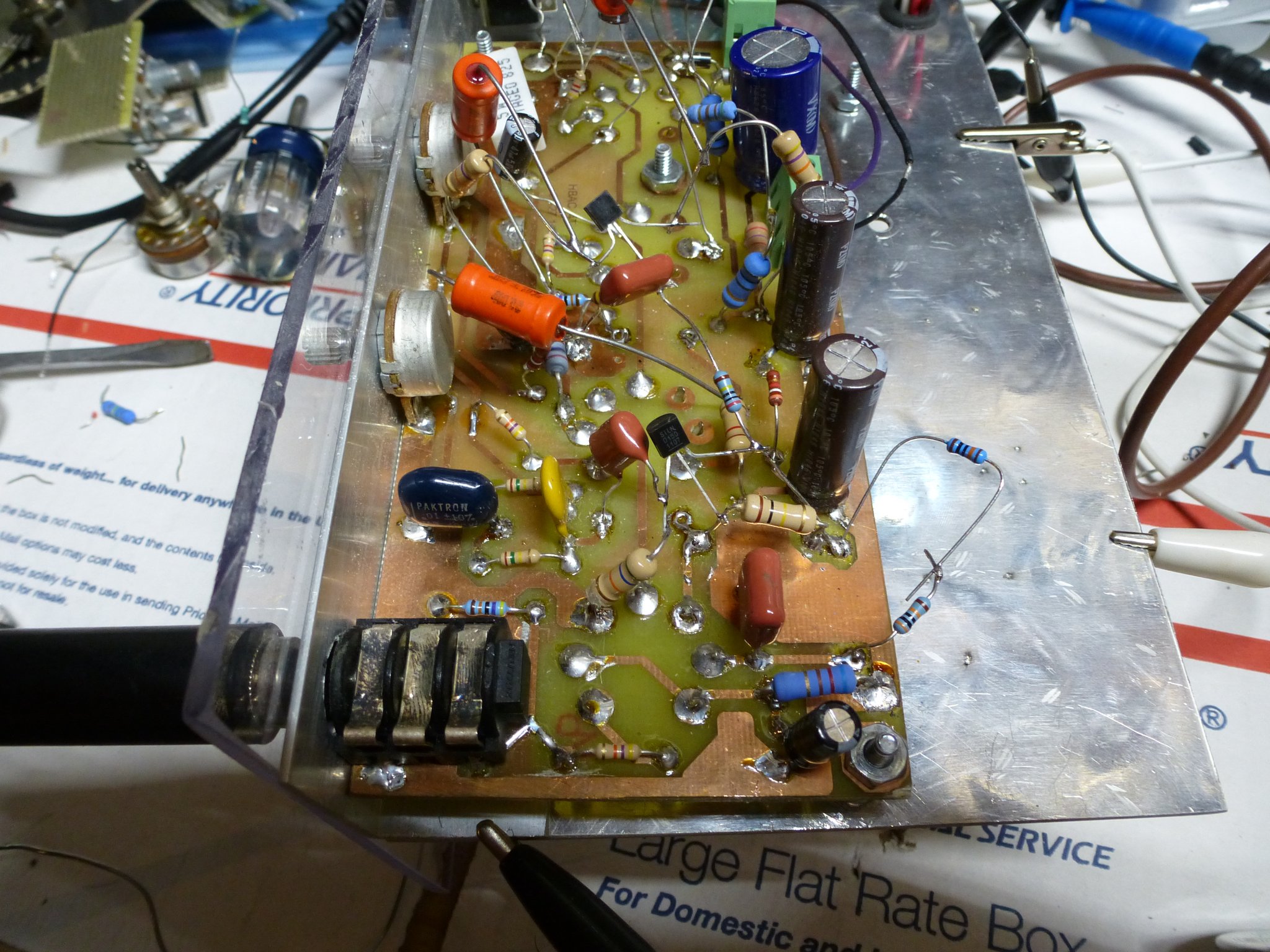

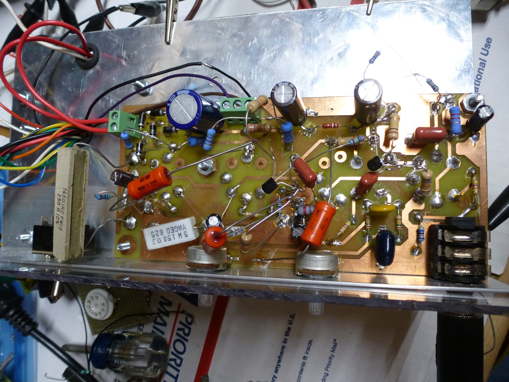

Another guitar playing friend had a Vox Tone Bender fuzz pedal, which I circuit traced. It used European germanium transistors with type numbers that I had never seen before. I built my clone on perf board, with transistors harvested from one of those two transistor radios. It did not work. Eventually I figured out the circuit was quite sensitive to the transistors being used, so I built a quick copy with transistor sockets for testing. This led to a couple good fuzz boxes with some Sony transistors. Those are long gone but somehow the test box is still in my possession after over 60 years. I recapped it about 25 years ago since the original ceramic disk caps were physically broken. I also made several new Champ clones in the late 1990's.

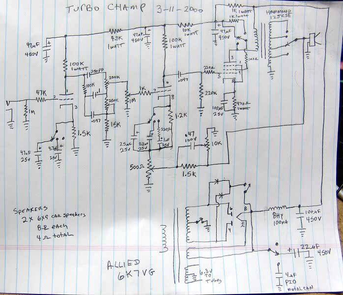

There was only one attempt at a 6SJ7 pentode input Champ, and I never finished it. All the rest were 12AX7 variants that I called the "Turbo Champ." I built a few and made them up as I built them. No two were the same. Someone asked me for a schematic after the fact, so I made this up from memory. It is a known working design, but I used whatever parts I could scrounge at the time, especially in the transformers and speakers department. A few used car stereo speakers that I got cheap when a local K-Mart closed down. The 12AX7 design seemed to be immune to input blocking since there was no cap in series with the input.

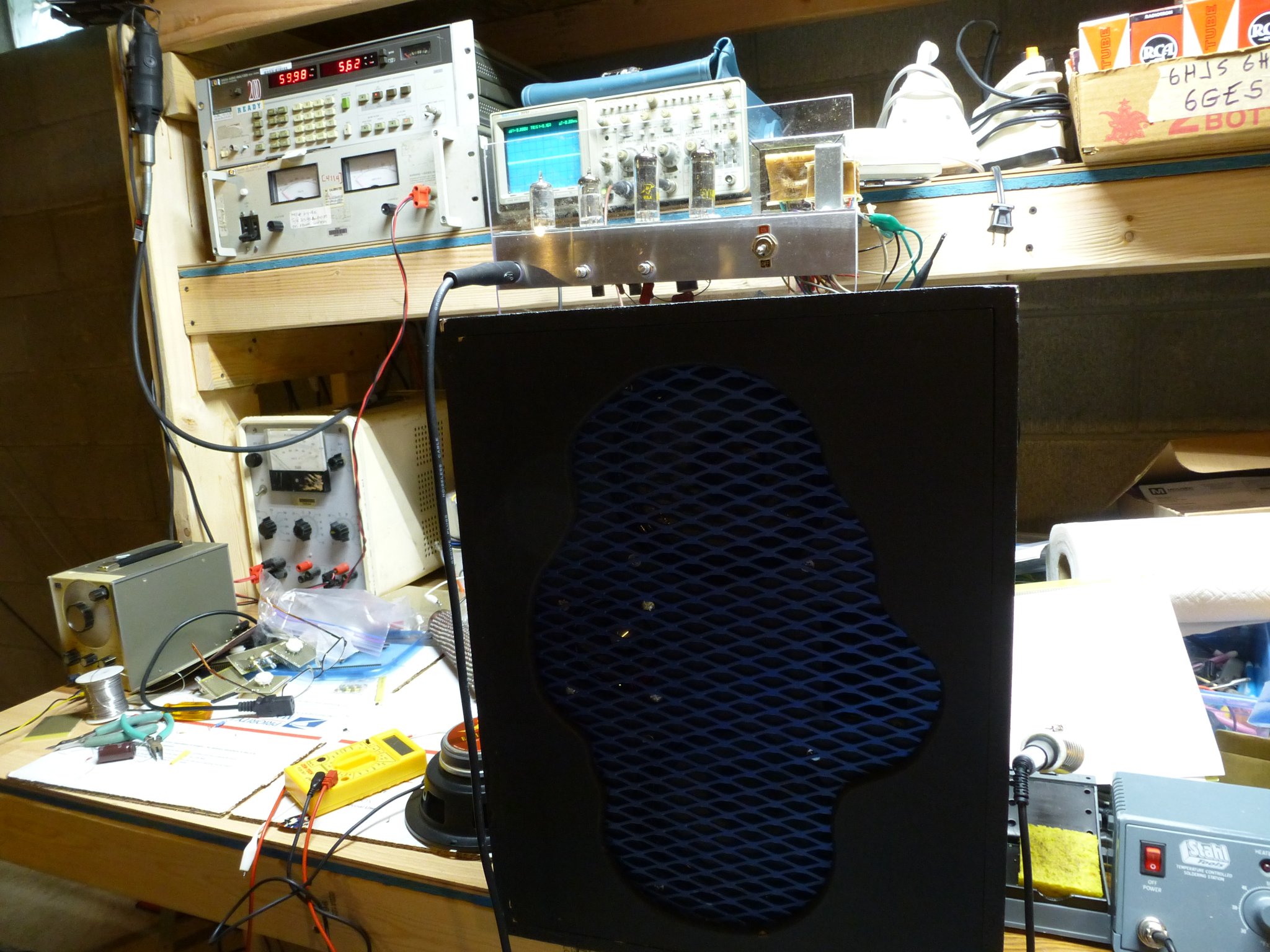

The 18FW6 input tube used in the 4 tube amp (GTA_4T-11-10) in post #4 is a "semi remote cutoff tube." It took about 2 weeks of tweaking to make that thing work with each of 4 or 5 guitars, two basses, and of course, the fuzz pedal test box. It has been the only working guitar amp that I have used for several years. That's about to change though.
