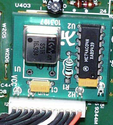

My DAC is MF X-DAC. I don't know what the use of the 74HCU04 in it.
Which one is a better replacement of 74HCU04 -- 74AC04 or 74VHC04?
Logic Families
Hi Arne,
Yes tried them all HC, AC and VHC logic. To me VHC logic sounds the best.
But you can not replace a 74HC04 by a 74HC14, of course.
For SPDIF outputbuffering I am using the 74VHC04.
In a Pierce type crystal oscillator you have to use the 74HCU04 (unbuffered version). Could be replaced by a 74VHCU04 but I prefer a real clock like the KWAK-CLOCK.
