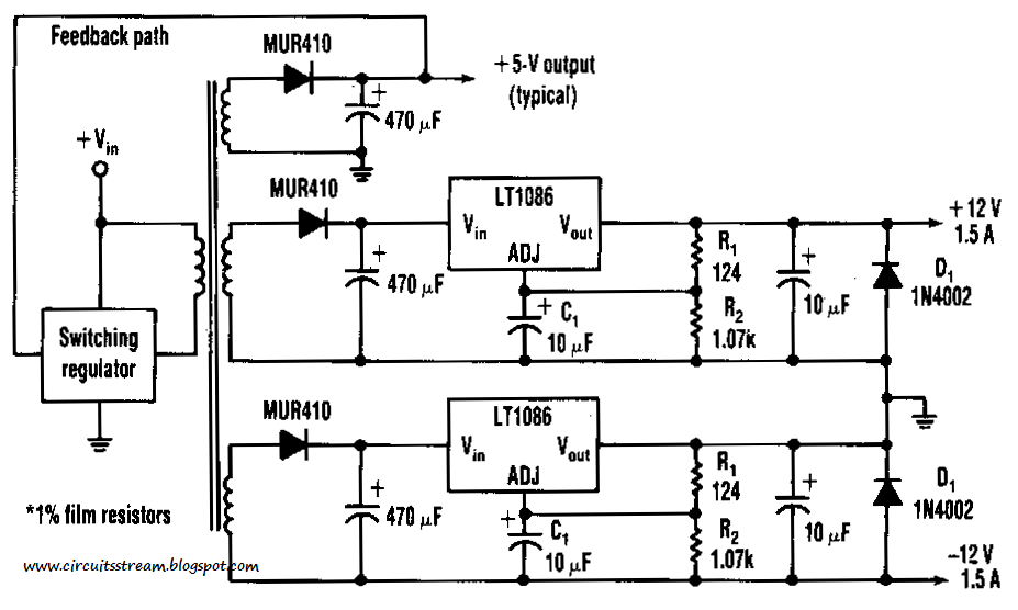

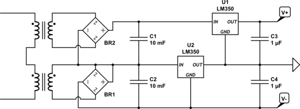

well spotted, correction should be like this ..... but is the 78xx going to work as negative regulator?
Yes, the configuration shown in the LT1086 schematic works very nicely.
The only caveat is each regulator must have its own transformer winding, as shown.

The top circuit is wrong, but the second one looks reasonableNo yield with 78xx series 'quasi-complementairy regulators with a quick scan, but this is the basic idea:
Brian
Keep in mind that these 78xx regulators will source, but not sink current.

You're right: BR1 has a shorting. Just copied from the net.Keep in mind that these 78xx regulators will source, but not sink current.
