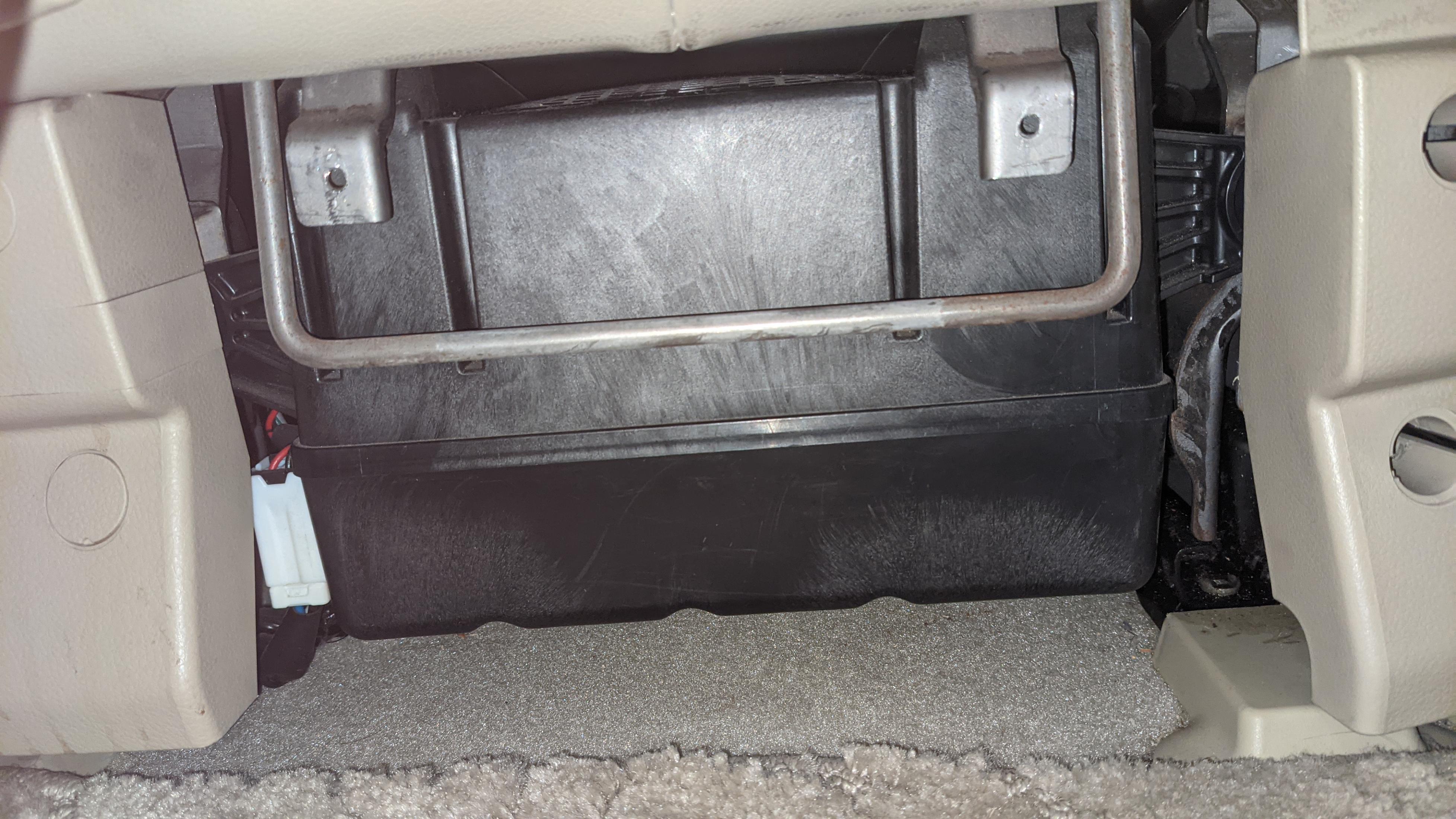

Ok so this is technically car audio but I'm looking for any other options for bass in approximately 8l of space(0.3cuft).
Firstly yes I know it's tiny and not to expect a lot. Power is around 2 to 300 wrms which should be more than anything in a box that size can use.
Aiming for 40-80hz in car. Just a little fatness in the bottom end, not window rattling.
My constraints are using an existing enclosure with room for what appears to be a single 6.5 inch driver. I AM ABSOLUTELY open to modding the enclosure with bigger cutouts etc or even glassing in a baffle of some sort.
Enclosure is mounted under a seat and is an odd shape. There is room for a passive radiator by the looks, but at most an 8". Woofer depth is limited to about 125mm (5") and above baffle maybe 3/4 inch including surround excursion.
Really keen to see what driver choices are tucked away. I probably could just find a small enclosure 8 and shoehorn it in (Even an Alpine R 8 says as small as 0.15cuft sealed). Also eyeballing the tangband drivers too. Kenwood shallow 8? Even a pair of 5" subwoofers mounted on the front with the existing hole glasses shut? Pic attached of front side of enclosure, OEM woofer is behind grille on too side. Top is approximately 21.5cm square. Bottom is bigger/longer and front is 22cmx14cm
Open to suggestions for crazy small box drivers🙂

Wel recently i installed a Tang Band W6-2253S in a 8L sealed cabinet for the cabin of his small truck of a friend. He uses it with an amp with dsp altough but hits 30Hz with it (with dsp eq). 2 of those cabinets are hidden behind the seats of the driver and the passenger in his truck. Tops are Focal coax car drivers that replace the shitty speakers in the doors of this (Renault Master) truck that he uses for his gardening bussiness. Amps are a 4 ch Audio Control device with dsp. That guy listens to oldskool dubstep, steppers dub and dnb and has now all the bass he could wish for in his truck...

I don't need to calculate the vehicle. The sub box is fixed inside the seat. It won't change. Also it's a subwoofer, wavelengths are long enough that trying to calculate seat foam is a massive waste of pedantic time.
All cars have odd acoustics but with wavelengths longer than the cabin, it becomes more about cabin gain than a seat position change.
I would like to know which drivers people would recommend for such a small volume. Not a FEA measurement of cone deflection in proximity to a seat cushion.

Do you know speakerboxlite?
SpeakerBoxLite. Subwoofer box calculator, Sub box calculator
It´s an online tool for a quick loudspeaker sim but most importantly it has a pretty big database with drivers.
Instead of choosing ("choose") the driver directly, click "choice" under "speaker",
then say closed/vented and give the volume.
Afterwards you can filter for certain diameters and sort the results by f3.
By conincidence it brought up a driver I once used in a sealed linkwitz-transformed "fast",
the Reckhorn D-165 but that needs vented to get as low as you wish.

Could you stretch for enough physical space to fit a baffle for a 10", most 10" pancake subs only need about that volume if going sealed

The Tangband W6-2100 doesn´t look too shabby in 8l sealed for such a small driver.
Negative, the top or bottom of the enclosure is 22cm roughly across. Either side of that are steel seat rails etc.
I'm starting to consider a possible 8 inch driver in that box and an easily removable second 8 or even larger in a similar sealed enclosure in the back. I'll be overlaying phase responses etc to make sure they both function together.
We're still talking about a people mover, not an analytical HIFI environment haha. Wife just wants some bottom end for her favourite tunes.

Sikver Flute W14 in an 8 litre miniOnken is good to near 40 Hz F10 anechoic so should be flat below that given the cabin gain in a car.
The driver is 75mm deep so should easily fit.
