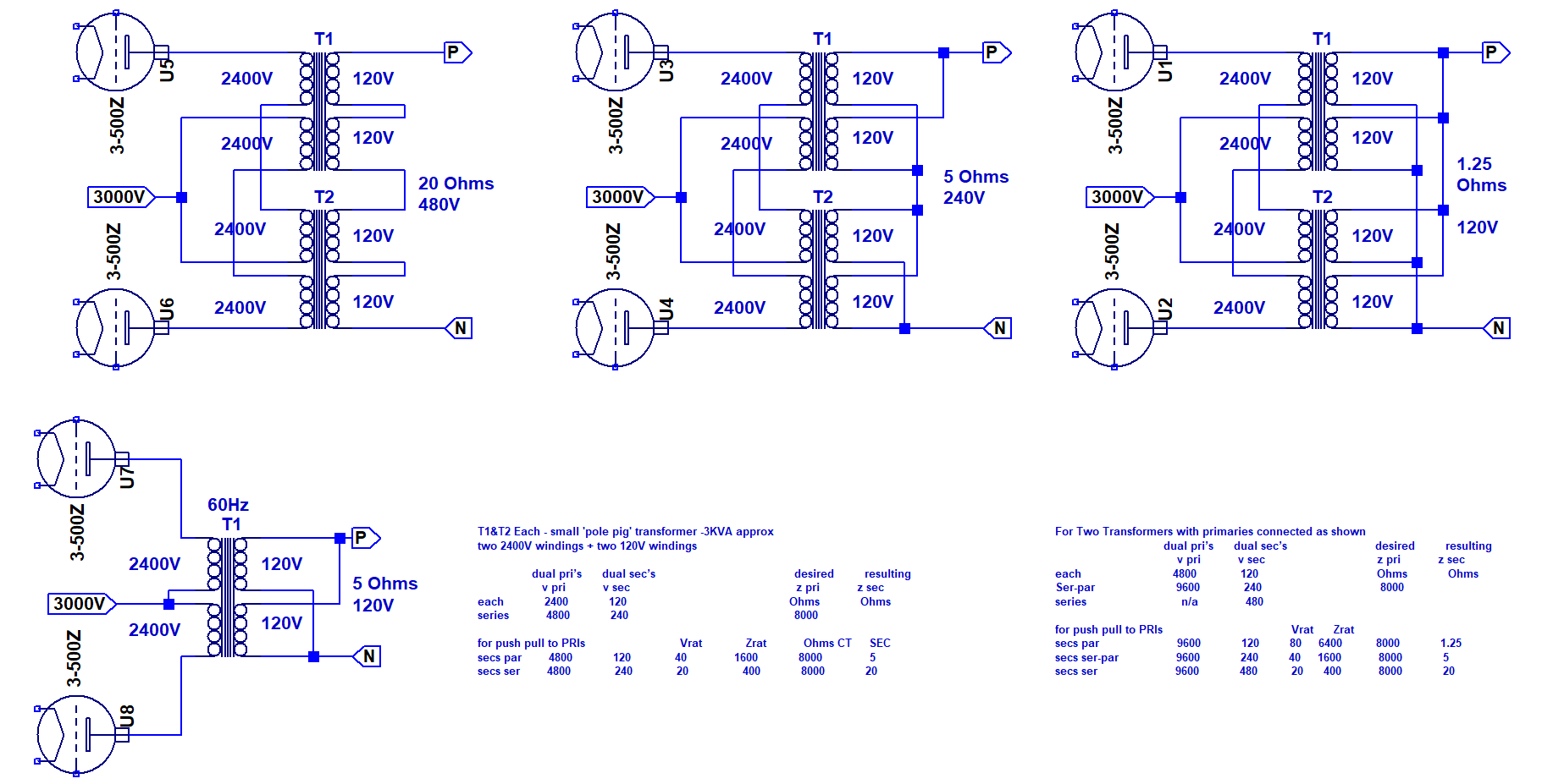

Could you share 833A and 3-500Z Circuits,is it possible ? We decided to do that amplifiers but we cant find anywhere this circuit.Please could you help us about that ?

All you need is a proper output transformer.
Also do a search here, there are discussions of these tubes, and other similar tubes.
It's just another tube, nothing particularly special other than the high high voltage which makes for a very high impedance to match to, special sockets and the requirement of air cooling. You'd also need a proper amount of swing in the driver circuit. Other than that, nothing particularly special to be done.

Thought experiments are safe enough though. Something I have been wanting to try for a long time is a subwoofer amp using 3-500Zs. There is probably little advantage to using a tube amp over solid state in that application, the only one I can think of would be the generally softer clipping.
I have some Ling TP850 solid state 'vibration table' amplifiers rated about 930W for use as sub amps, but why not think about some tubes instead.
I have seen old frequency changers using tubes. Their output transformers are designed for limited range and so their defects are not exposed as they would be over the full audio spectrum. Some of them for changing 60 to 50Hz I would swear are nothing more than power transformers.
This leads me to think that it may be more practical to try a 3-500Z sub amp than a hi-fi amp where transformer cost is concerned.
I suggest that an old 60Hz 3KVA 'pole transformer' of the type having two 2400V HV windings and two 120V windings would be useful. I also suggest that two of them could be used by connecting the primaries in series in such a way that each is seviced by both tubes, and then making the appropriate secondary connections to match the low impedance load. The reason for using two of these 3KVA transformers is so that the full power of the tubes, about 1500W, can be passed at 30Hz. The low frequency power rule for transformers is that they can deliver half the power at 0.707 * the rated frequency and 1/4 the rated power at half the frequency. Therefore a 6KVA setup for 60Hz should handle 1.5KVA at 30Hz.
The size of 'pole pig' units on hand here may not be comon any more seeing the distribution is now usually 7-14KV, but it is possible to get a 3 phase 2400V (or whatever) unit and restack it using two windings for single phase use.
