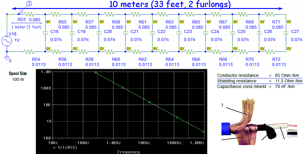

The "85" ohms (really 96 ohms) is a series loss for exactly one kilometer. They won't even sell you a whole km, and I think you don't have the 100m reel? And 100 meters of even the best unbalanced cable is begging for radio and fluorescent interference, we normally work audio coax at 1 to 10 meter lengths.
The 50 or 75 ohms is a shunt impedance at infinite length or frequency. It does not matter at audio.
Curious, I ran a 10-lump approximation for a 10 meter cable. Inside the audio band it is always >10,000 Ohms. Out at 3MHz it approaches 100 Ohms, and the asymptotic Z is surely 50 to 200 Ohms, but deeply swamped by the relatively huge 96r/km copper loss (which of course is insignificant against the 10k audio impedance).

As a non-engineer, I cannot follow. However, it looks like a cool simulation.Curious, I ran a 10-lump approximation for a 10 meter cable. Inside the audio band it is always >10,000 Ohms. Out at 3MHz it approaches 100 Ohms, and the asymptotic Z is surely 50 to 200 Ohms, but deeply swamped by the relatively huge 96r/km copper loss (which of course is insignificant against the 10k audio impedance).
I have no intention of simulating anything, but the inductance can easily be calculated from the type of dielectric and the capacitance:
v = 1/sqrt(L C) where v is the speed of propagation and L and C are the inductance and capacitance per unit length
Hence, L = 1/(v^2 C)
C is specified as max. 70 pF/m. The dielectric is described as cellular PE. If that means polyethylene foam, then v is about 80 % of the speed of light in vacuum, if it is solid polyethylene, v is about two thirds of the speed of light in vacuum.
Hence, with 70 pF/m, L is about 248 nH/m for foam and about 358 nH/m for solid PE. The high-frequency asymptote of the characteristic impedance is sqrt(L/C).
