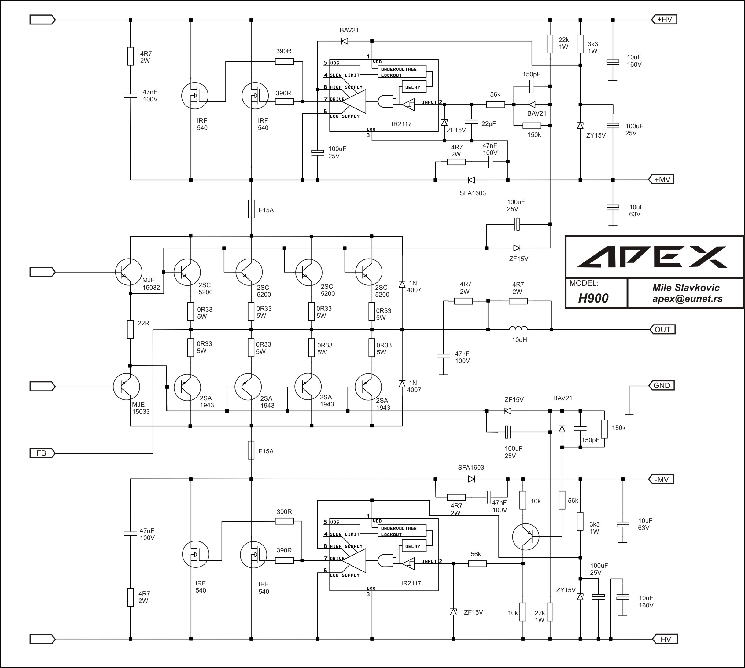

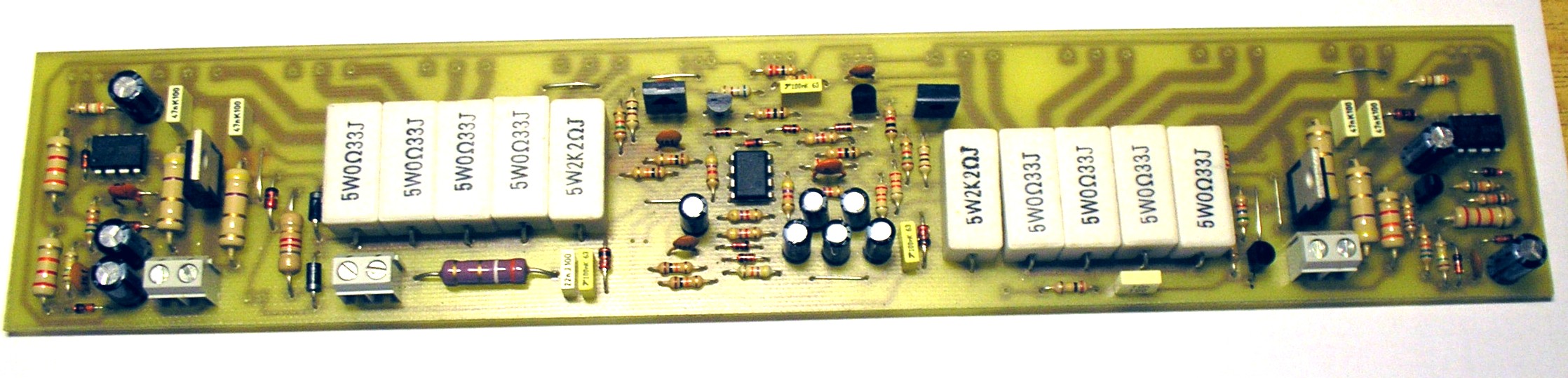

On this PCB I use IRF540 in paralel for step higher voltage, and LDR for limiter. Output stage with 2SA1943/2SC5200. Step driver with IR2117 and NE5532 on balanced input stage.

It doesn't look like your commutating diodes are on the heat sink.... Are you expecting them to run stone cold? I wouldn't. BTW - which ones are you using? Looks to me like a 2-lead TO-220.

Commutating diodes are SFA1603 TO-220 without heatsink, not cold but no need extra heatsink, maybie small TO-220 heatsink.It doesn't look like your commutating diodes are on the heat sink.... Are you expecting them to run stone cold? I wouldn't. BTW - which ones are you using? Looks to me like a 2-lead TO-220.

I will post schematics. I dont espect any interested about that kind of amplifier in DIY.Well lets just say that seeing how it is built would be interestingI'm sure that a good few people could find use for a powerful & more efficient (than AB) amplifier

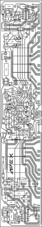

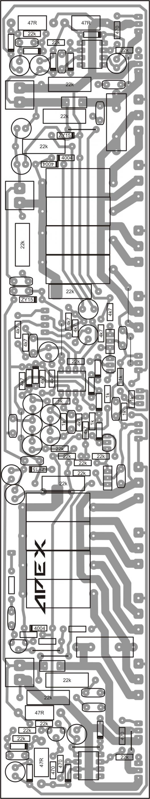

could you post an etch-able pcb layout too?
is it really 900W @ 8? i'd guess at 4 ohms or less with only 4 pairs of 1943/5200..
Power suply 0,+/-60V,+/-120V. THD 0,03% 20-20000Hz on 900W 4 ohms. All new brand amplifier use 4 pairs of 1943/5200 evan for 1900W 2 ohms in their specification. I dont want to go tnat much.actually, i do. i love high power amps, repair almost only pa stuff or heavy hifi and love to learn more.
