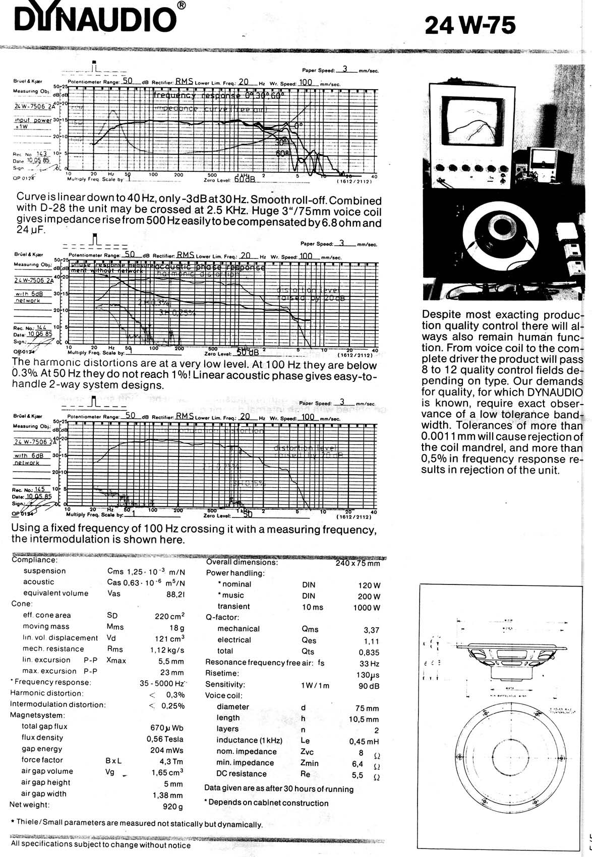

a pair of old Dynaudio msp 110 The woofer is a 24w75Which speaker do you have?
https://www.fanutza.net/Images/24W75-spec-150pp.jpg

The good woofer was the 24w100 Bigger coil diameter bigger magnet lower Qts and much higher cost I guess it is discontinued

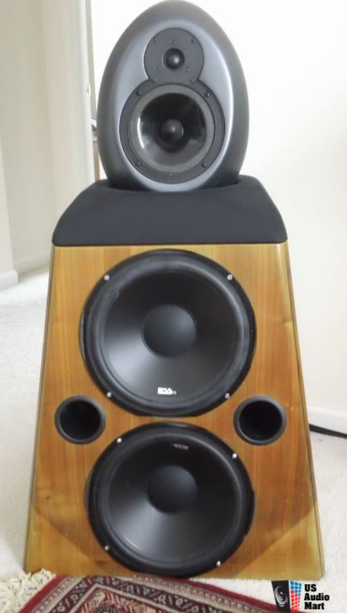

😳 i do not understand Sorry The concept i have in mind is quite common for commercial monitorHow about a Linkwitz transform circuit or some other type of minimum-phase equalizer?
a head for mid high above a bass cabinet Nothing exotic

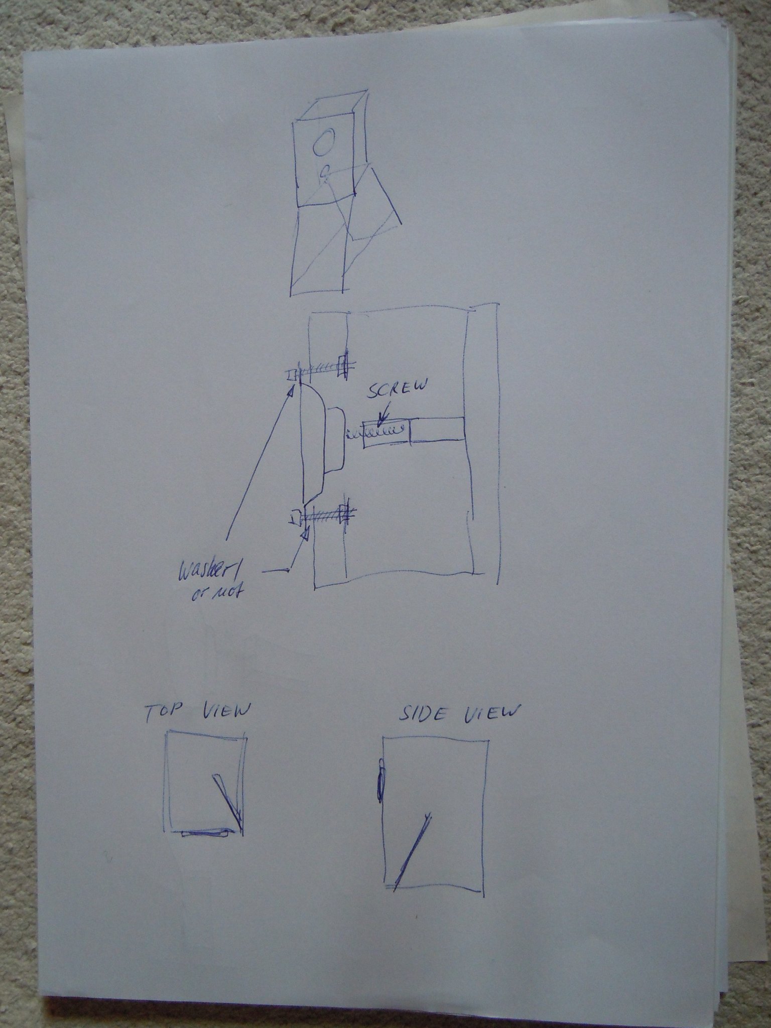

Here are a few more mechanical, physical facts about loudspeakers in diy audio;-)
If you have compacts, then I would advise you to use such stands. Even then the bass will bubble less.
The woofer should be decoupled and installed clamped. A whole lot can be tuned here in terms of sound, including the treble and mids! A minimal version is shown here. Don't forget to seal the woofer then;-)
Thirdly, a small board on the inside is enough to damp the woofer almost completely. Simply clamp it in a wedge shape. A few attempts can lead to an ideal tuning. Then not much will bounce back onto the woofer cone too.
These are three short and sweet tips that will help this woofer achieve a clean sound. But you have to do it first: diy audio;-) And no experience without doing;-)

These ones sound lazy Not involving Now the woofer covers up to 2kHz A very big portion of the audio range
The fast bass is at around 100-200 Hz So the idea is to use another faster smaller midwoofer to cover the mid bass and the mid Like a driver with a paper cone
But looking at the datasheet i see the very high Qts I guess that this could provide some info about the mechanical behaviour of the driver ?
Like low Qts fast cone High Qts slow cone Just i did not know this
Instead the distortion looks quite low They have saved too much on the magnet And the magnet strength is very important

Working inside the cabinet full of lead will be a little unsafe I want to limit the rework to a minimum
Just a new inductor wiring connectors and stop Usually very low bass are also slow They hang in space for seconds
