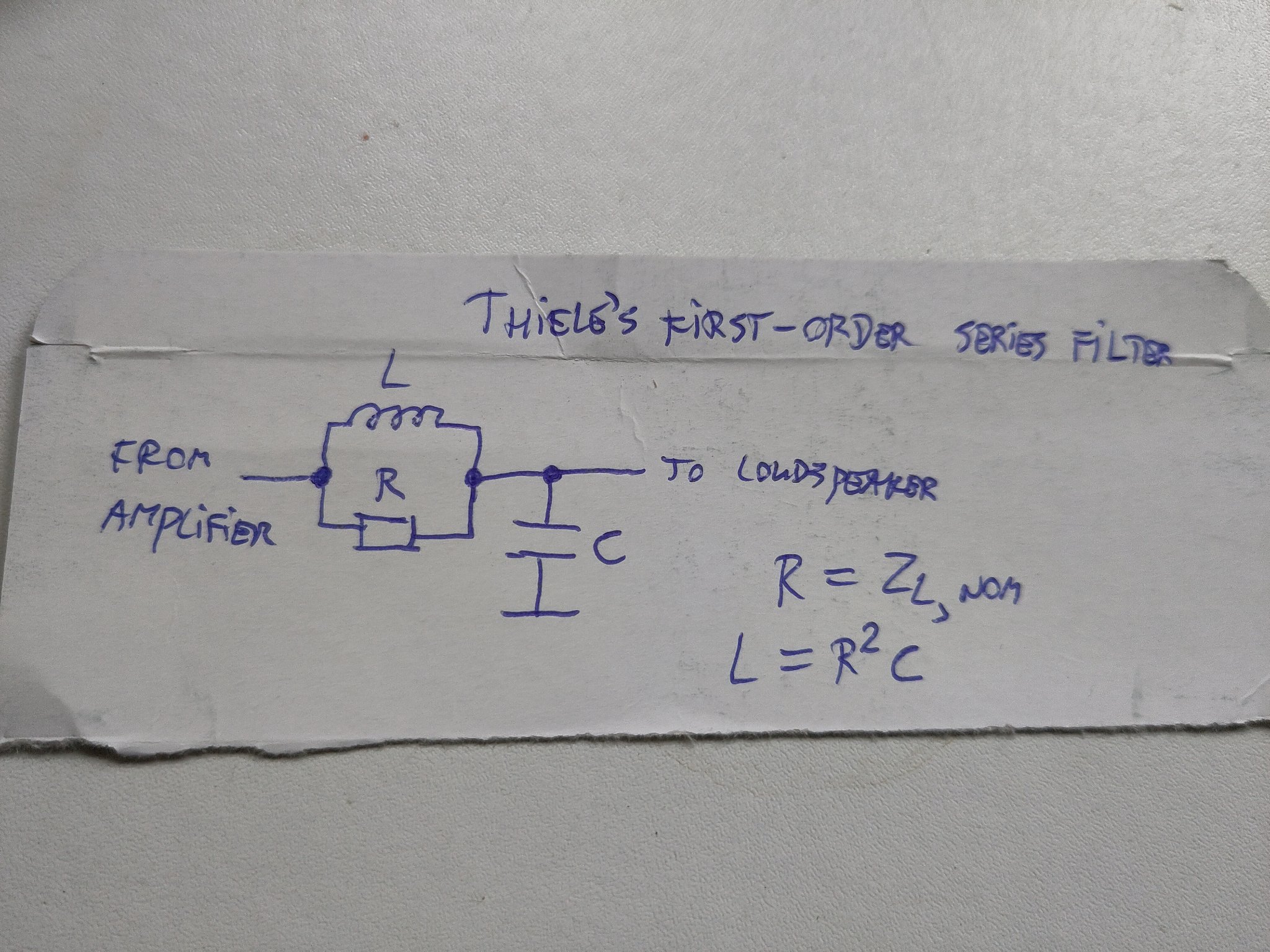

Depending on what you want, you could argue that C is useless or that C is essential. It's essential when you want to use this to keep RF signals picked up by the loudspeaker cable out of the amplifier. It is useless (in theory anyway) when you want to make the real part of the output admittance positive at all frequencies to ensure small-signal stability with any passive load, as the capacitor only changes the imaginary part of the output admittance.

The LR network in series with the load prevents the impedance (as seen by the amplifier) from becoming too low at ultrasonic frequencies. The RC network that shunts the output prevents the impedance from becoming too high at ultrasonic frequencies. Depending on the amplifier, one or both may not be needed.

Thiele's series filters do both and suppress RF interference picked up by the loudspeaker cables, as long as the output capacitor doesn't get tuned out by a high-Q inductive load.

There is some anecdotal evidence that series filters help against RF interference in Thiele's paper, which has apparently been posted here by someone: https://www.diyaudio.com/community/attachments/7386-pdf.741268/

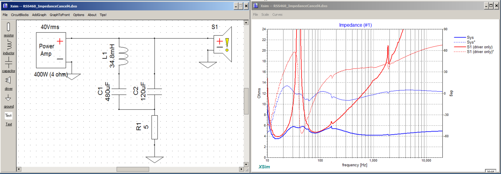

I've had decent results with conjugate networks on subwoofers (haven't yet tried mids or highs). This one seemed to add definition between bass guitar and kick drum, along with giving more sense of the beater on the drum. Think of it as being less "thooom" and more "thwamp". I'll write the thing up eventually, but for now note the load phase angle has gone from +-60 degrees to +-10 degrees, showing a reduced reactive component, which could have bearing when actual cables are used. Without baffing at the math, at a first glance EDPR would be improved, a useful point for class-AB amps where output transistor SOA is a consideration.
Test records: Rush Moving Pictures, Donald Fagen The Nightfly, Tori Amos Under The Pink.
Please ignore the kank at 160 Hz, that's a cabinet issue under scrutiny. The impedance peaks out at 45 ohms at around 38 Hz.
