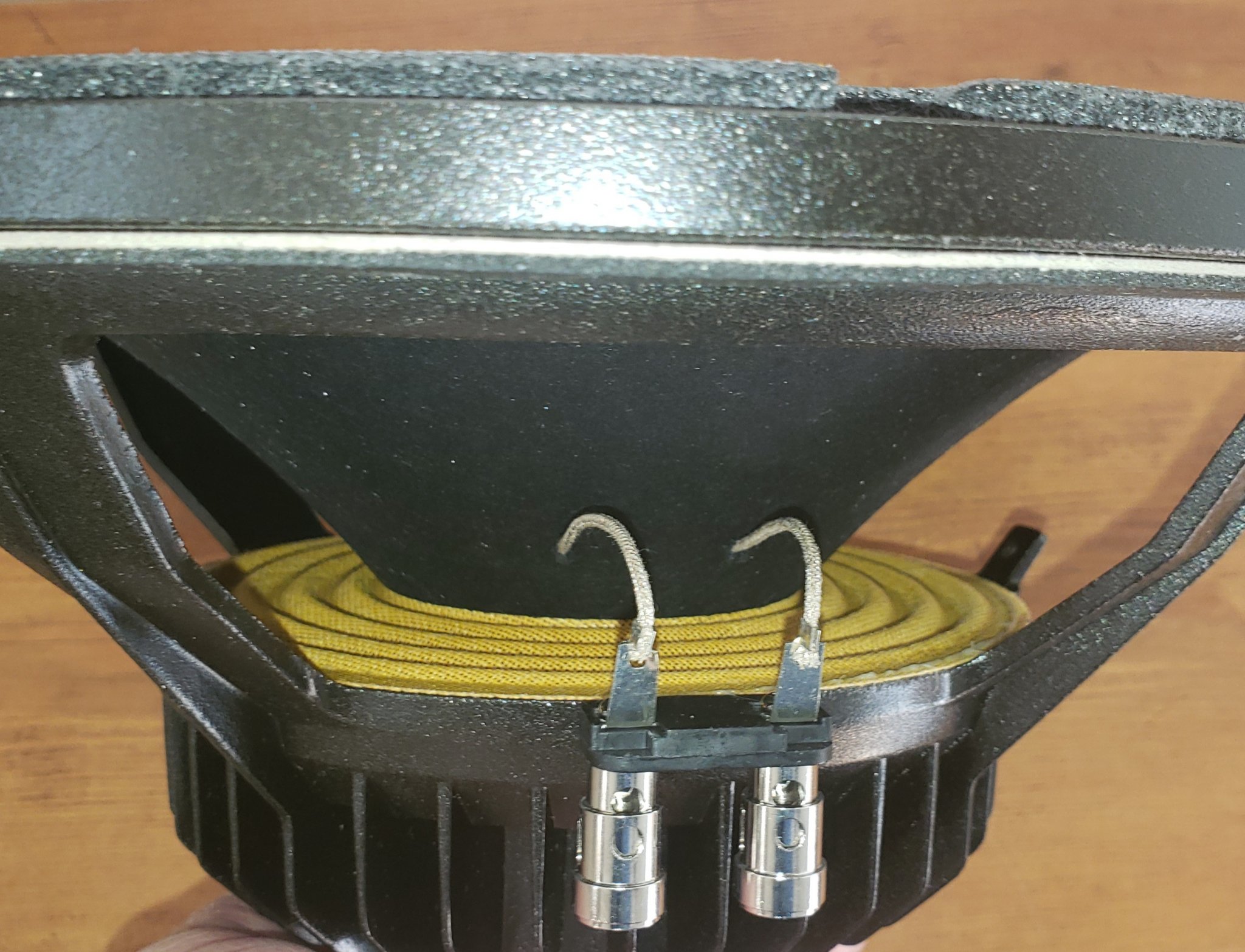

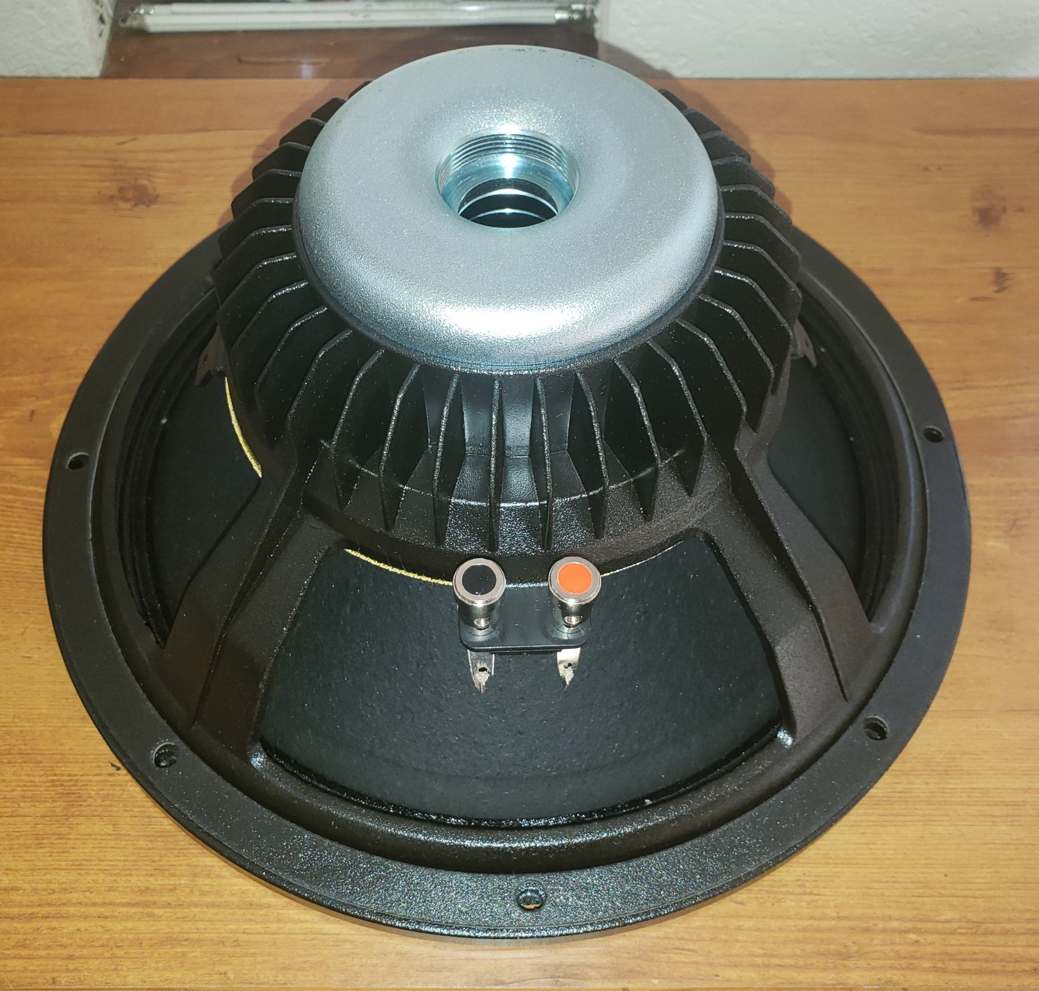

I believe that I finally found a good 12" neo coax that doesn't cost a fortune and has the build quality of a more expensive driver.
I ordered a pair of Eminence KL3012CX8 and was pleasantly surprised when I examined then a bit closer.
One of the key things critical to a good coax that uses the cone as a horn flare is a smooth transition from the horn throat to the cone. The KL3012CX8 has a smooth radiused pole piece that provides a very even tapered transition. I dont believe this was always the case for this model driver. Reason is that I recall Erich from Diy Sound Group working with Eminence on a new coax design for his Vortex line. The machined pole piece section looks almost the same on the stock Eminence KL3012CX and the Vortex 12 driver. Its possible Eminence adopted this design feature for they're drivers as well. I tried taking a picture of the pole piece through the screened dustcap. Hopefully its visble enough.

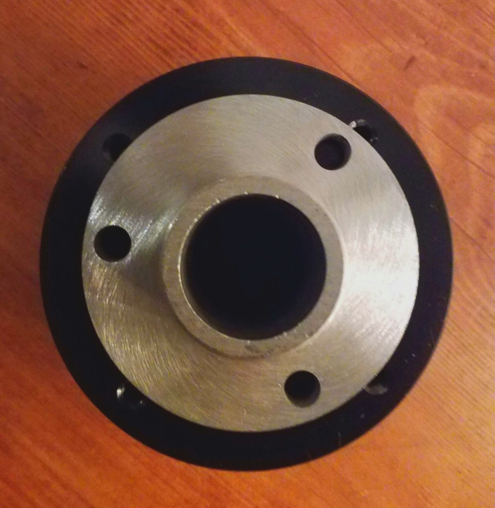

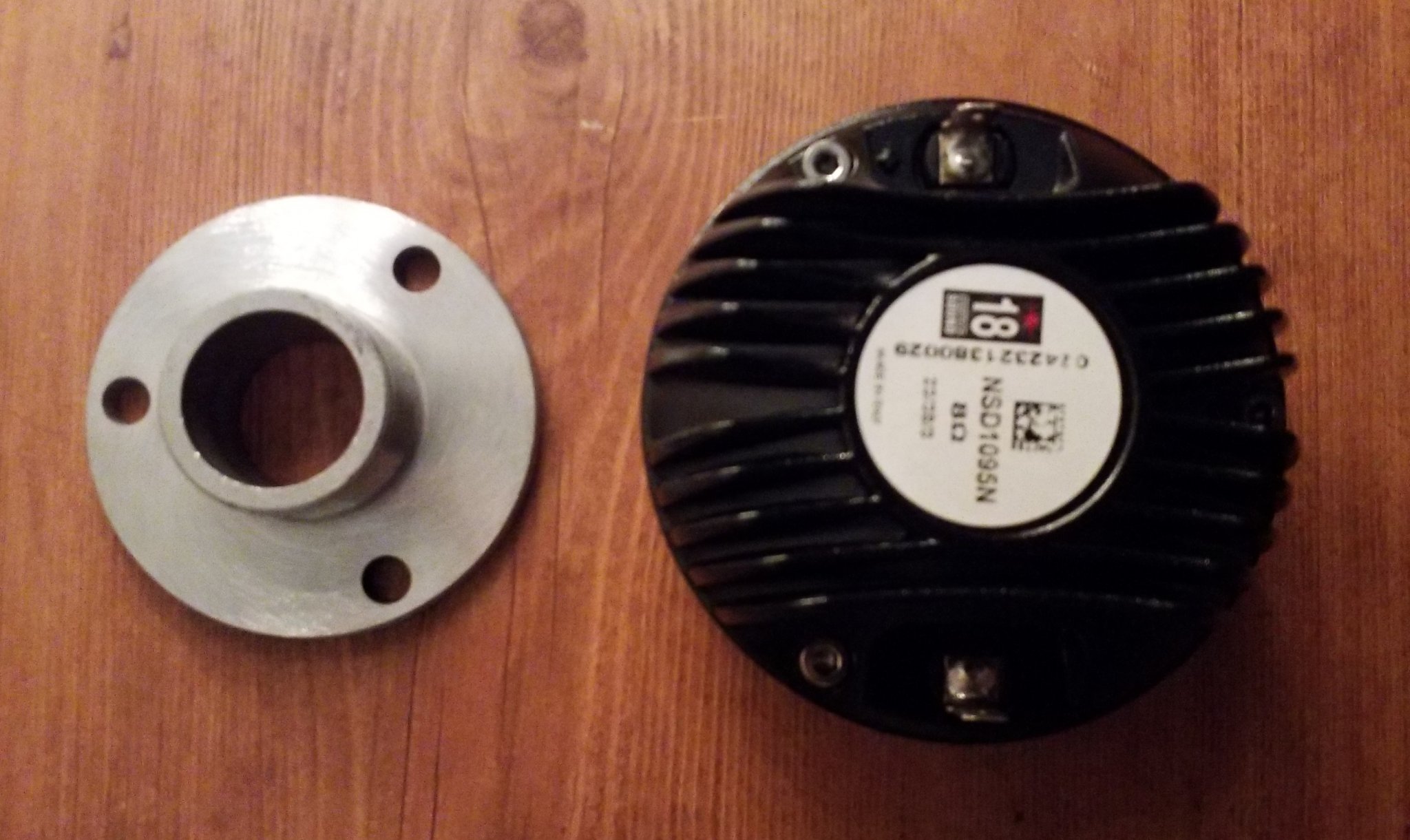

I'm trying to find a good adapter that will accomadate my 18sound NSD1095N. This driver uses that smaller 4 bolt pattern and the adapters I have which fit nicely in throat diameter are all drilled for 3 bolt and not large enough in flange diameter to be used for the 4 bolt pattern. The DE250 and CDX1-1745 both fit fine on the adapter, but the studs are too long to fully screw it on the coax driver so it bottoms out on the coax magnet asy. All the other adapters I have are drilled slightly too large for a smooth transition into the pole piece to avoid abrupt steps in the internal horn flare. I wish doing a 3D printed adapter wasn't such a big fuss with the thread being a complex model to create in CAD. I've never had decent luck doing this in the 3D design realm. A custom adapter would also bring the driver as close to the coax as possible for best time alignment.
When you factor in the issue of needing a suitable adapter, it becomes a challenge to find one that works with the driver's exit angle and mounting format. It does help with getting the transition as smooth as possible m, which to me is more important than most other potential issues which occur on driver's that have a set type of CD you're stuck with. I have a plastic adapter that has the correct bolt pattern but runs on the large side and will cause issues in the throat.
BMS! https://www.bmsspeakers.com/index.php-366.html?id=5531nd_overview0that is why I asked about CDs. the good ones don't just bolt on...
