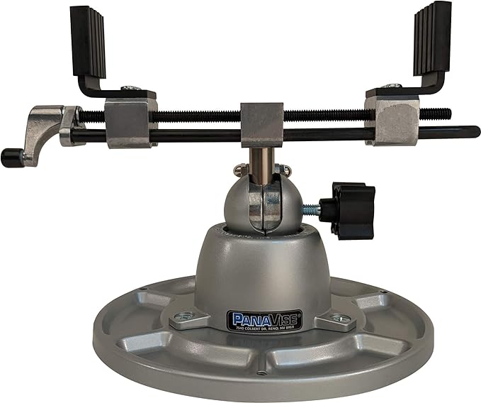

4. When soldering it is often helpful to have a third set of hands, and this is where "Helping Hands" come in handy. There are many to choose from, but I prefer relatively cheap ones of this type, for much of the work I prefer Magnetic Adjustable Circuit Board Hold.

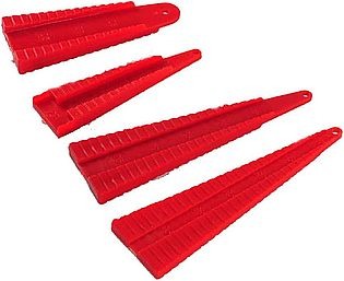

5. THIS is potentially less known but incredibly useful, Lead Bender, these will help get consistent, properly spaced bends in the legs of resistors etc., which not only adds to the aesthetics but likely the overall performance.

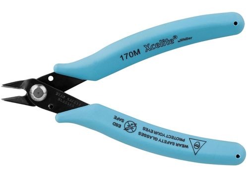

6. A "Shear Cutter" Diagonal snipper, Xcelite 170M, is what I have had for decades.

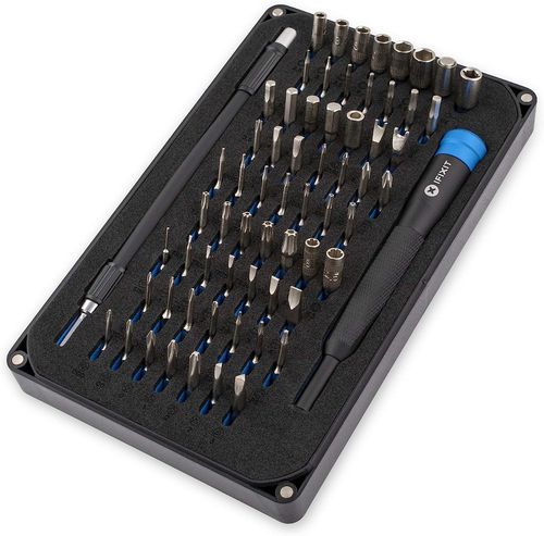

7. Obviously an assortment of screwdrivers and various bits, iFixit, is an outstanding driver set w/ a very nice aluminium
, handle and a nice assortment of bits.

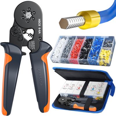

8. Preciva Ferrule Crimp Kit, something that I was unaware of until @ItsAllInMyHead, thanks, suggested it! This is inexpensive, good quality and makes connecting wires to euro blocks more secure. What more could you ask for? It was recently pointed out to me that the ferrules come in 2 different shapes, thanks @vanofmonks, square and hexagonal. Apparently the square ones are designed for the euro blocks on my Aleph Jzm, but the hexagonal when tightened down flattens out and works beautifully.
