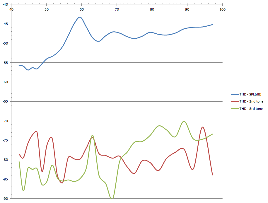

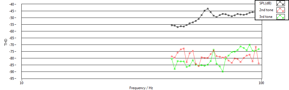

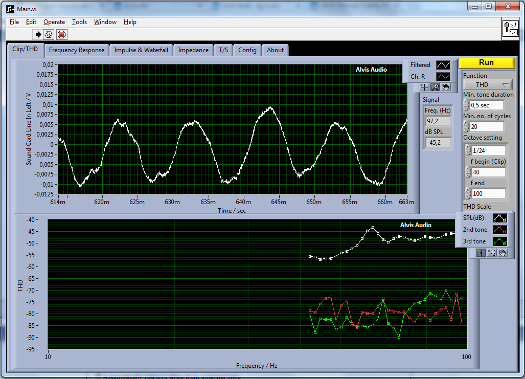

Hi
It is possible to convert the complete application into a .exe file. Than you do'nt need a LabView version running on your pc. Of course it is not possible to make any changes in the application.
I have running such an .exe file on my pc and it is working.
At the moment I'm discovering how to attach an picture, it wil come later
