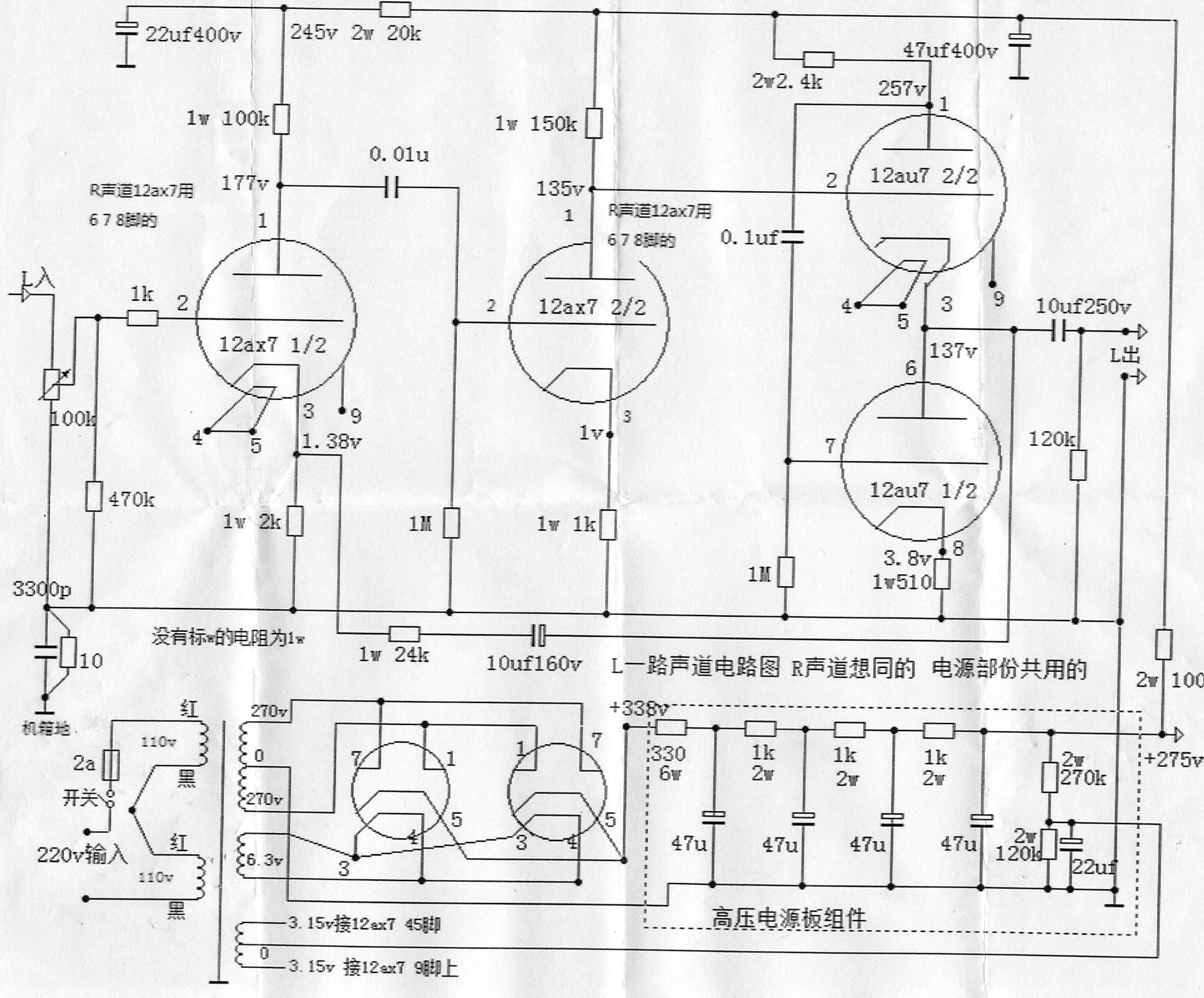

Thanks for posting this! I just started on this "kit" and have several questions. Kit is in quotes because this is very far from a Heathkit to put it mildly.
1. I assume I can connect a turntable to this, but don't pre-amps for turntables have some kind of "RIAA equalization"? I don't see that on the diagram and it has 4 different inputs anyway with no signs of one being for phono. My turntable has in internal pre-amp that can be switched in and out, but not all do and I wanted to not use it if possible.
2. It also has no tone controls at all. Is there an easy way or even semi-easy way to add them?
3. This has me a bit concerned:
you’ll see a spike in output voltage of about 150V as the tubes warm up. This does settle to zero but 150V would blow your power amp if connected.
I am not sure how this is possible, the output runs through a capacitor:
It should not be possible to see ANY DC voltage on the output, let alone 150 volts 😱 Are we talking DC or an AC pulse? This is feeding a Douk 5 watt tube amp I just finished, so maybe 150 volts briefly won't hurt it, not sure 😕
Guessing it's that 10uf output cap charging as circuit voltages stabilize. Depending on the amplifier's input impedance replacing it with a 0.22uf or 0.33uf film may be worth a shot.
I'll get the scope on it once I get it built, I might try your idea or maybe stick a Zener or neon light across the output.
Two series 12v zeners will solve your problem across the output. Its quite normal on cathode followers if the tubes are warm and HT is applied. The output will jump to HT/2 before the output coupling cap charges up. Changing the output cap value may affect the bass response depending on you amp input impedance.
A -3 dB rolloff at 20 Hz with a 10 uF output cap requires a ~800 ohm output load. Plenty of room to maneuver.

This is the overall diagram minus the switch. I may try and engineer in a tone control or two. I have been a ham forever but this kind of thing is new to me and so far very fun 🙂 Thanks all for the help!
It has 4 sets of inputs that feed into a 4-way switch, so it either has RIAA on all of them or none.
I am not sure how important that is, right now my turntable has a pre-amp built in, but I am guessing many do not.

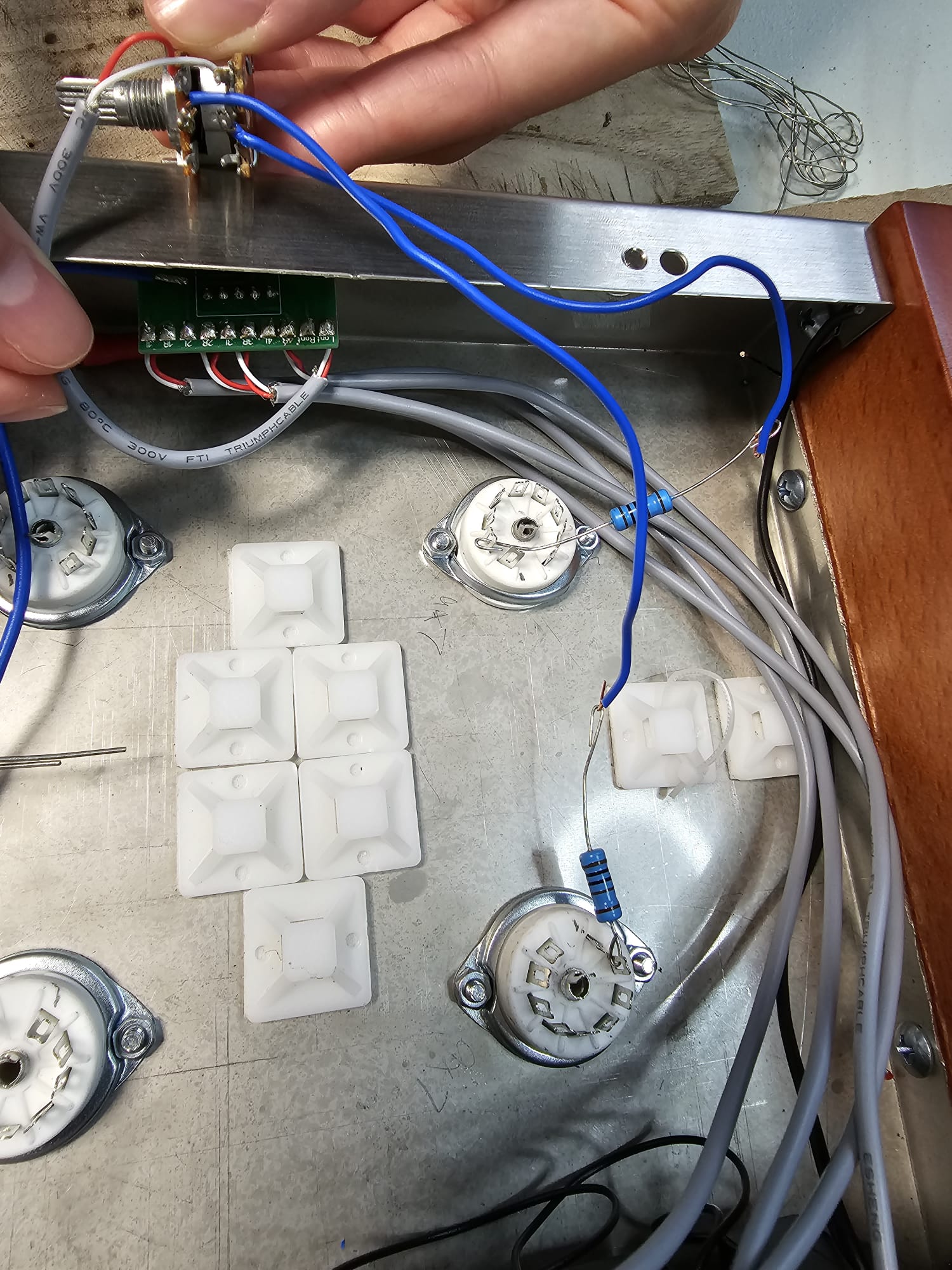

Thank you very much for the extremely useful tips. Please may I ask if the circuit diagram shared for the left channel, when you mentioned that it is to be replicated, it means that the same connections are to be super imposed on the other set of 12ax7 and 12au7?
Meaning that one pair of 12ax7 and 12 au7 is used for the left channel while another pair is used for the right.
For example, I have attached an image of me connecting the left channel coming out of the "volume control" to pin 2 of 12ax7 and the right to pin 2 of the second 12ax7.
Thank you all in advance for your kind advice.
