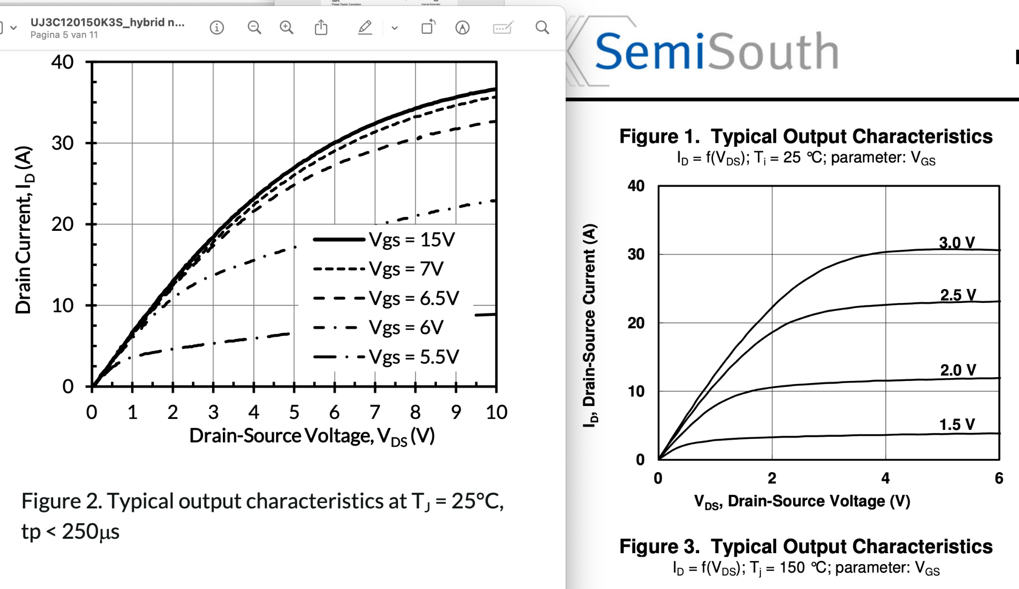

1200V. 10A. >120W. zero input capacitance (sorry I dream: Ciss is actually rather high, then can't they handle that embedded driver better??). But at least: the curve is that of a jFET.This SiC FET device is based on a unique ‘cascode’ circuit configuration, in which a normally-on SiC JFET is co-packaged with a Si MOSFET to produce a normally-off SiC FET device. The device’s standard gate-drive characteristics allows for a true “drop-in replacement” to Si FETs, SiC MOSFETs.

audio . . . because this "SiCFET (Cascode SiCJFET)" device, in the lower left of the curves, matches/is sort of similar to a SJEP120R100 . . . and is just made more universal (that is, commercially), not needing a negative bias.
and if you don't mind, a C3M0120065D looks promising in comparison of those curves too. A UF4C120070K3S is more hefty and cheaper.

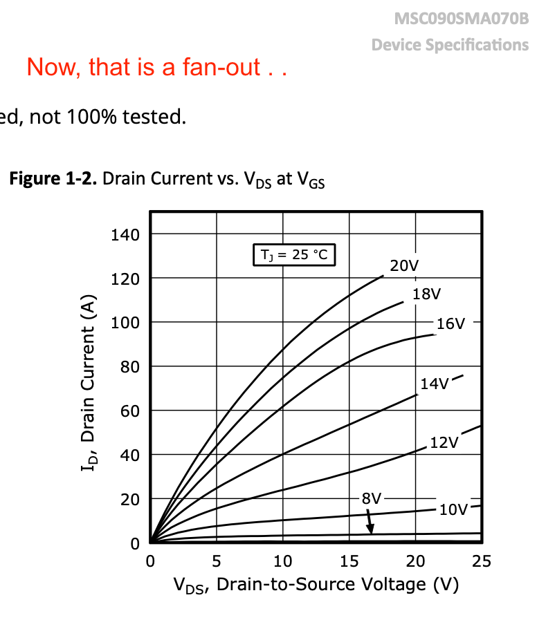

But MSC090SMA070B looks like a killer.

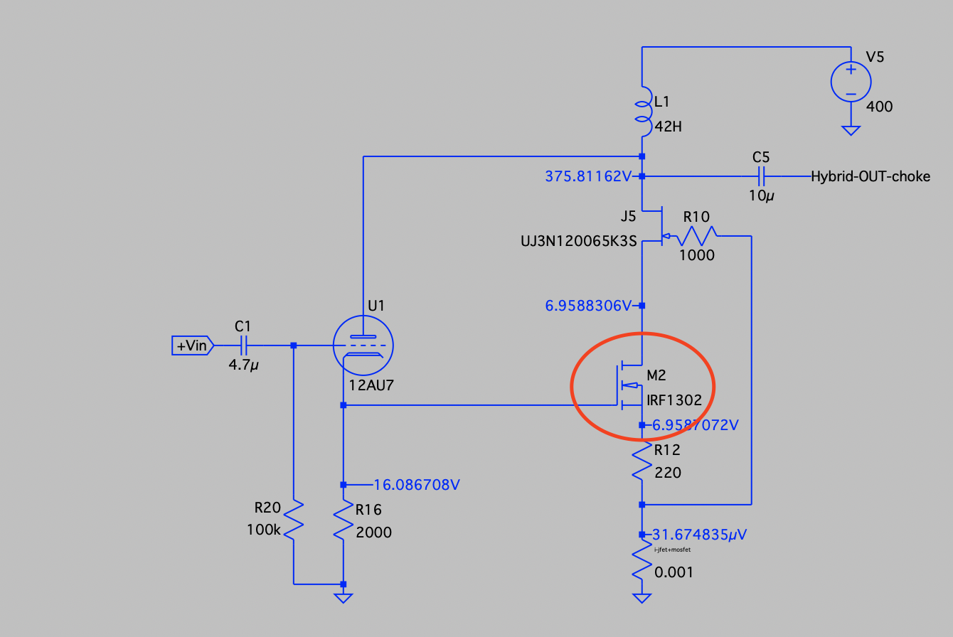

I have been working last year on designing a tube-based SE amplifier, where the cathode current of a 300B or even 6SN7 will drive a mosfet, such that the combo is a servo. Could also work into choke to get e.g. . 30V or 40Vpp with ease and hence to a follower circuit.. Or a transformer with some appropriate secondaries.
A normally-off SIC-jFET would be ideal as it would just fit in with a cathode resistor of 1000Ω. And drive the mosfet nice. (I saw that the SJEP models are great for such servos).

For analogue audio, I am more interested in Id Vs Vgs.
Id Vs Vds doesn't tell me a lot.

This is sort of the concept: a cathode follower driving a jFET while the anode is also connected to the load - such that there is some 'triody feedback' going on.I have been working last year on designing a tube-based SE amplifier, where the cathode current of a 300B or even 6SN7 will drive a mosfet, such that the combo is a servo. Could also work into choke to get e.g. . 30V or 40Vpp with ease and hence to a follower circuit.. Or a transformer with some appropriate secondaries.

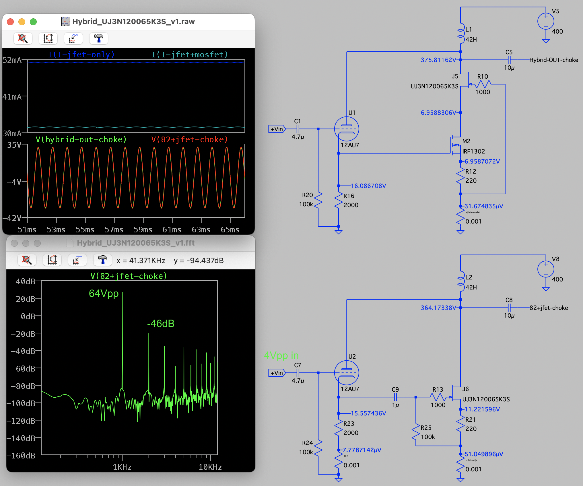

Note there are two curves visible in the bottom panel.
The other one is a hybrid mosfet/SIC-jFET - I have seen an article explaining schema's with such a configuration as the concept of the single-house combo to get a high threshold Vin. There is almost no difference in the amplification nor in the distortion . . .
- maybe the 220Ω source resistance does all the work of creating the harmonics and amplification, without decoupling.
Anyway, statically the idea 'works'. It has rather high residual distortion right now - the feedback?
A follow up can be a combo with a pure driver tube - such as a triode-connected power pentode - like the one on my avatar, used as preamp - or even a 300B.
Looking at the SIC-jFET curves, a hybrid with a mosfet on top forcing the jFET in the non-lineair/resistive region is more interesting for triode curve lovers.
