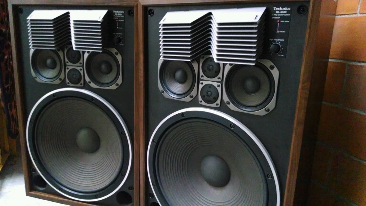

Hi ! i have a curiosity about this kind of drivers
i wonder what kind of advantage provides the use of those little lenses around the dome
Clearly they limit H and V dispersion But what are the benefits versus normal domes ?

these are conical waveguides, for the drivers being mounted from behind the baffle.
they (slightly) increase the directivity and thus the directed output while reducing distorsion.
they also allow easier matching of acoustic centers of drivers.
it also provides some protection to the domes.

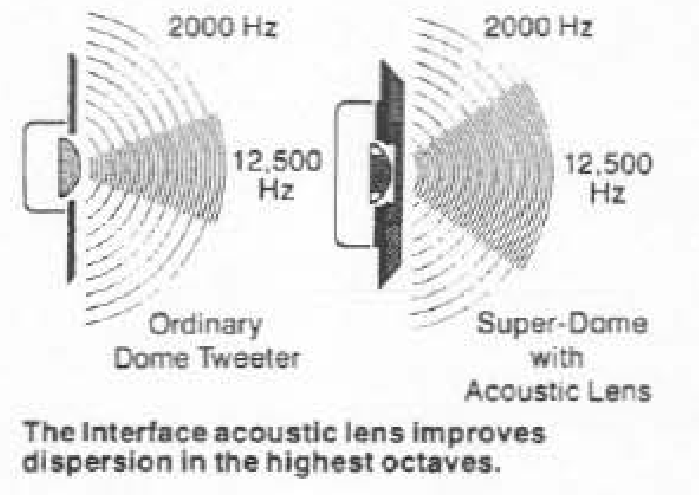

The drivers you show are midrange domes and the "waveguide" is relatively small. So the directivity increase is probably only effective in the upper frequency range. That might not be desirable for some designers, as TNT mentioned.i do not know why the solution is not more popular
Electro-Voice with their "Interface" series of loudspeakers used either felt or foam acoustic lens over dome and cone (Peerless 2.5" cone tweeter in Interface B) Active HF EQ may be of benefit.
Sound quality was very good and the Interface series a showcase of knowledge with 6th order reflex alignment with passive radiator.
https://products.electrovoice.com/binary/Interface A EDS.pdf

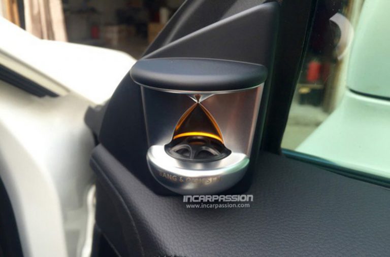

Any experience with this type of lens on a tweeter?
Saw Bang Olufsen used it for tweeters
the bo design will collect dust
