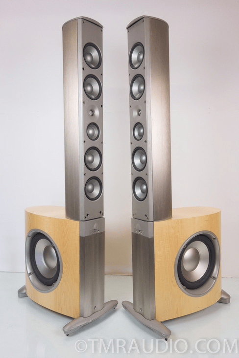

The systems more interesting to me are those with a line array above a bass cabinet
Like this one i listened in a dance room I was shocked by the power and cleaness of sound
It's also possible to build these but it's much more difficult. They have specialized drivers and enclosure with angles and small dimensions which need to be precise and you need a DSP. If you haven't developed speakers yet, that's a really big task.
These speakers can sound very good but their dispersion is usually very wide and don't have a well controlled dispersion, so room treatment will be important for these too.
Why don't you rent such a system for a weekend and try if you like it? That costs something but after that you can definitely say if it's worth for you to build or to buy it.
PA type line arrays are really too BIG, even for a large home. No, those little Bose things don’t count as they are not actually real line sources. You get wonky low midrange thats hard to correct, too, because the mains just can’t get low enough. A line of 8”/1” that’s 12 or 16 feet tall is probably TOO MUCH, unless you are talking about hotel ballroom size. Then it would be damn nice. Won’t work well in a 20x30x9 space, and anything even bigger even less so. Those work well in art houses, although I have heard them hit their limits with Tori Amos performing through them. She was able to make poor 1” CDs scream in pain, but only on one song. Unmistakeable sound of diaphragms hitting the phase plug. HT use doesn’t have that much midrange.

There are also some hifi pasive speakers very similar Like the Infinity Prelude MTS

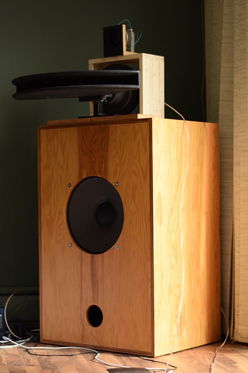

I have started a journey of using home built Danley SH50s (voiced for hifi) as left and right channel.
I have 2 Tapped horn subs (also originally a Danley idea). These can shake the room do explosions etc.
I am really enjoying the sound these Multi Entry Horns give for music reproduction.

If you have a big enough room and can build, full on MEH surround system with multiple subs placed would be great.

To me, I don't really care about imaging. What I want are dynamics, and pro-sound speakers can do that without huge amplifiers in the home environment. It's the dynamics which make me feel like I'm there in the music venue.
Also, with my setup, I don't have to sit in a certain spot to enjoy the music. The music fills the room and I can be anywhere, like in real life.
