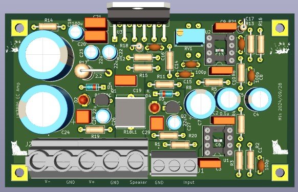

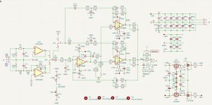

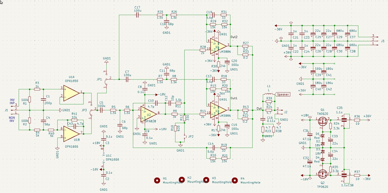

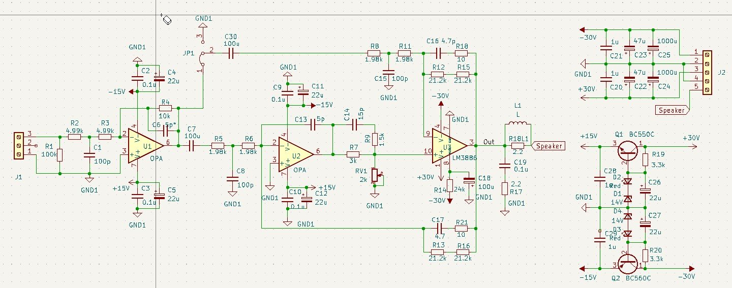

This Error-Correction/Composite Combo amp is based on Mr Evil "Unnamed feedback method explored" and Nickolay Shvydky "My ZD-50 ultralow distortion chipamp"

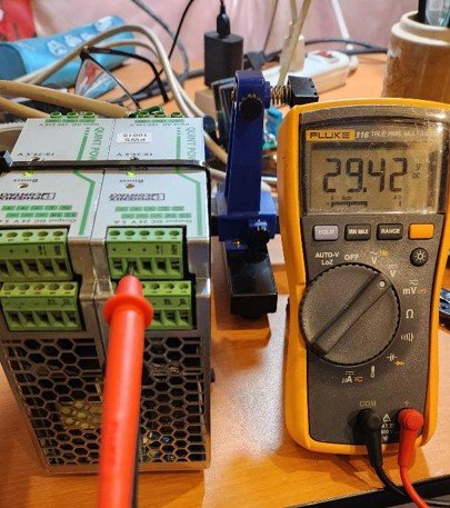

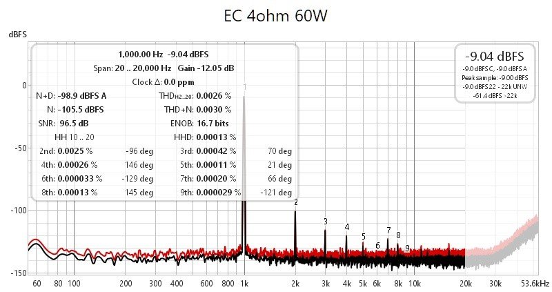

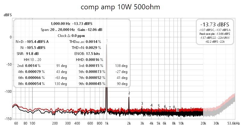

Output power at +/-29.5V: 8 ohms clip at 42W, 4 ohm clip at 65W. It is very stable in both EC and Comp mode. Ans it behaves very well after clipping.

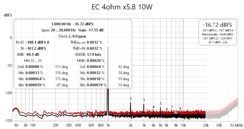

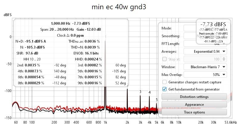

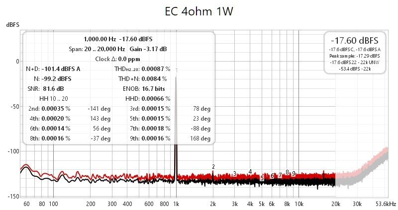

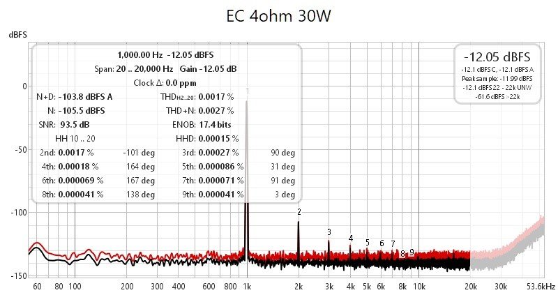

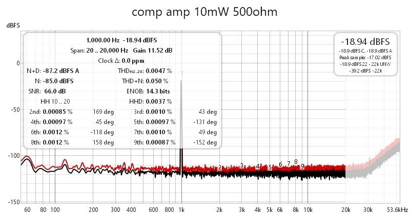

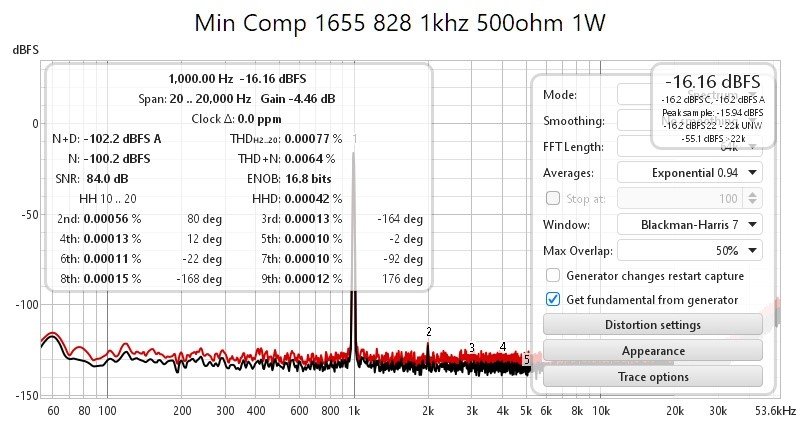

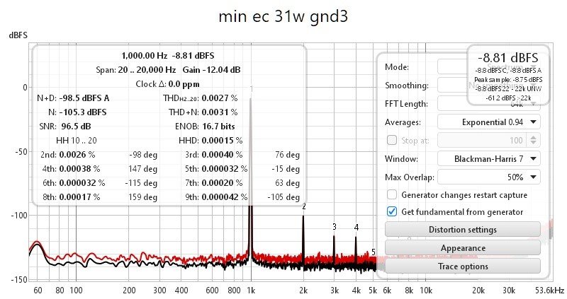

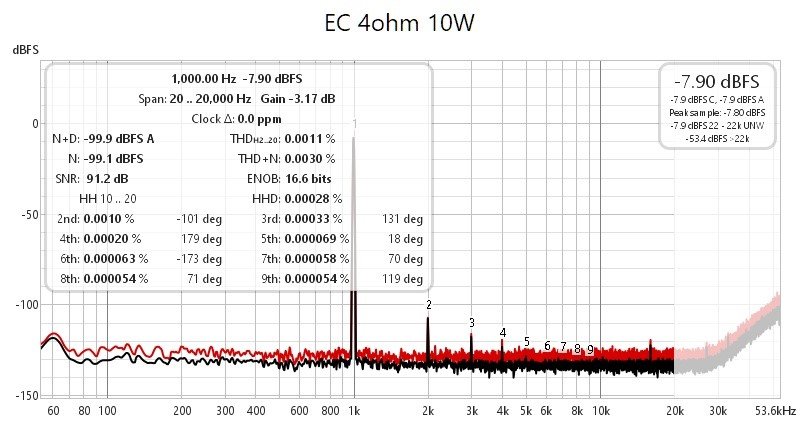

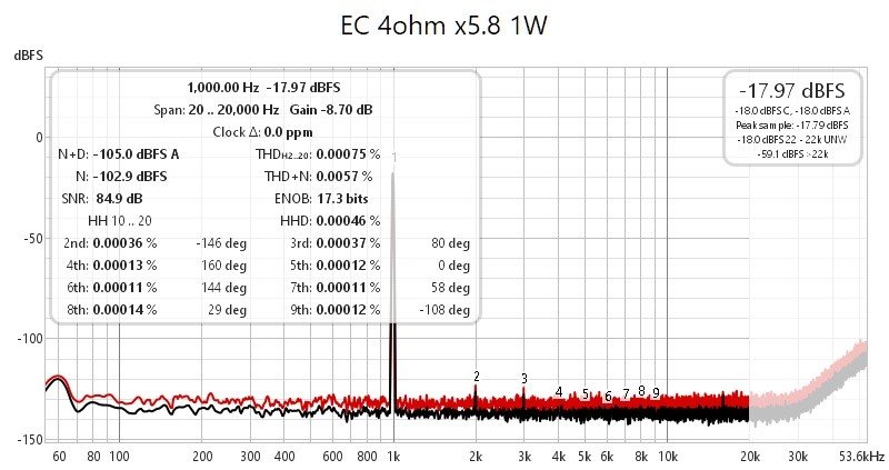

I could only measure its THD+N very roughly using Focusrite Solo 3rd, which has a minimal line-out and line-in THD+N of 0.002%.
U1 is OPA1655 and U2 is OPA828. For error-correction(EC) mode, RV1 was set at 330ohm. For composite (Comp) mode, RV1 was set at 680 ohms.

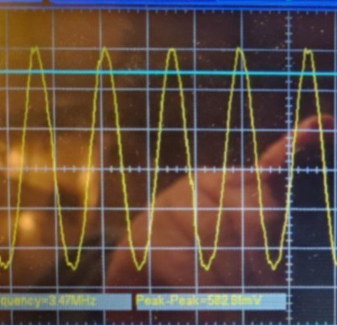

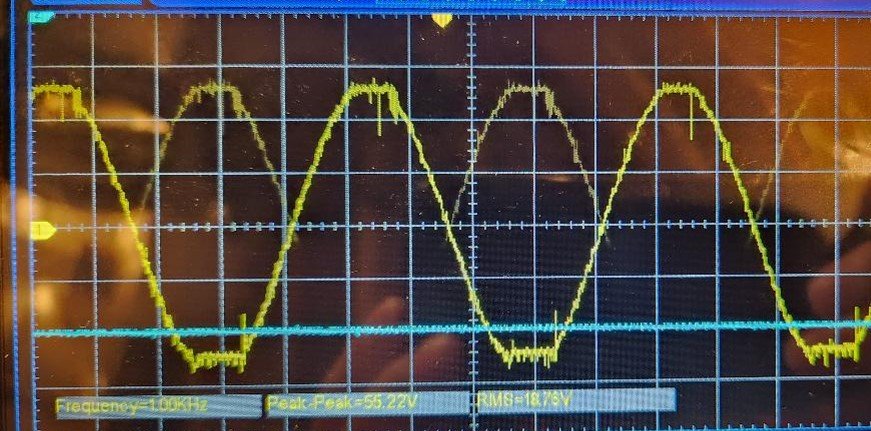

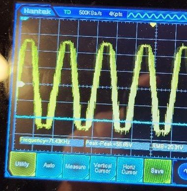

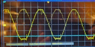

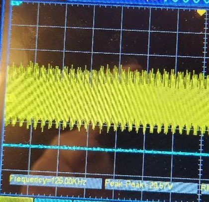

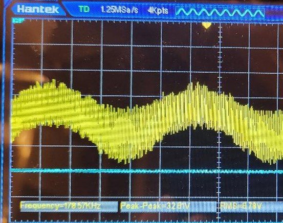

At beginning of the design and testing, there were oscillation all over the place. It also was met with oscillation after clipping.
From left to right: 3.5Mhz 500mV oscillation, clipping at output 18.75Vrms, oscillation after clipping, oscillation after reduced input signal, oscillation with no input signal.
But thru few days intensive testing and adjustment of the compensation capacitors, it has been finally successful.

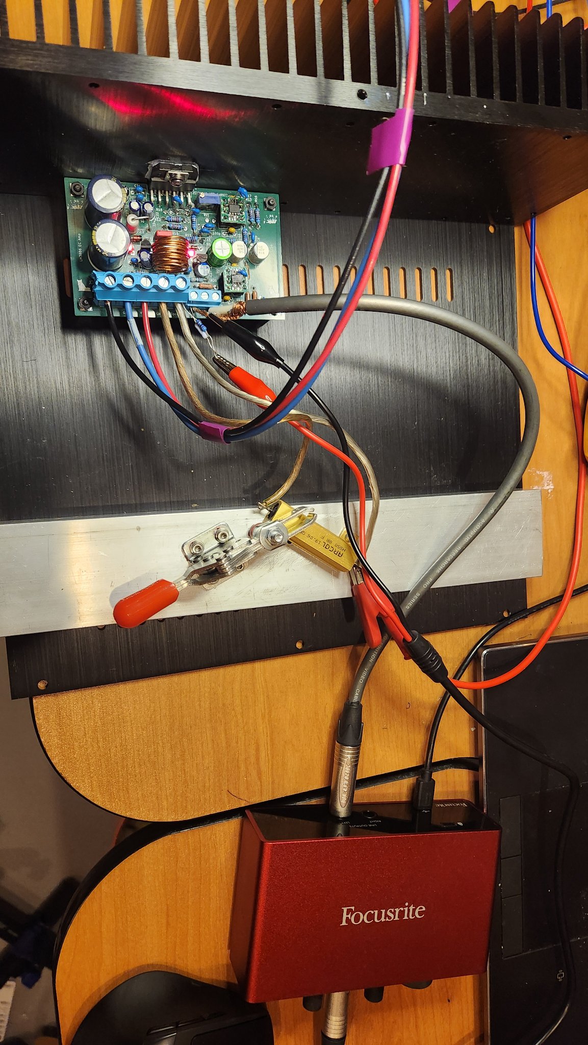

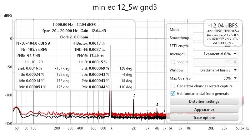

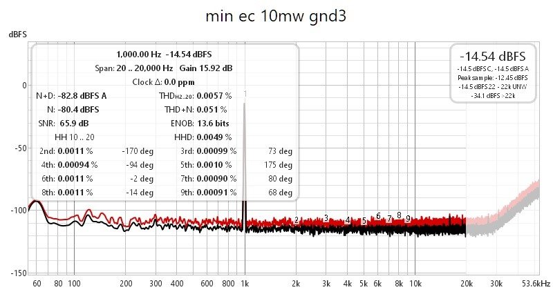

THD+N on benchtop. It was open, with high testing components rising high.

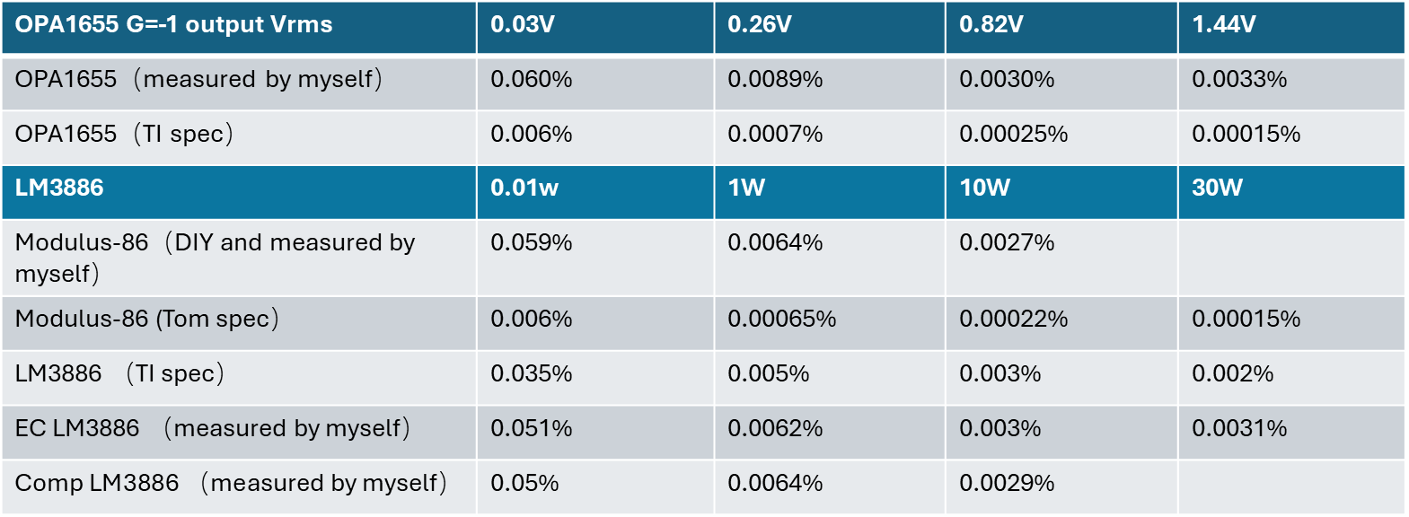

My measurements are 10-20X worse (20db) than TI spec and Modulus-86 Spec. That's the problem of my measurement setting up.
EC mode low gain 5.8X. Since Focusrite Solo can only have 2.4Vrms output, so high output power was not measured. It was done by put a 49.9K resistor parallel to 21.2+21.2K resistors in FB loop (in both brunches).

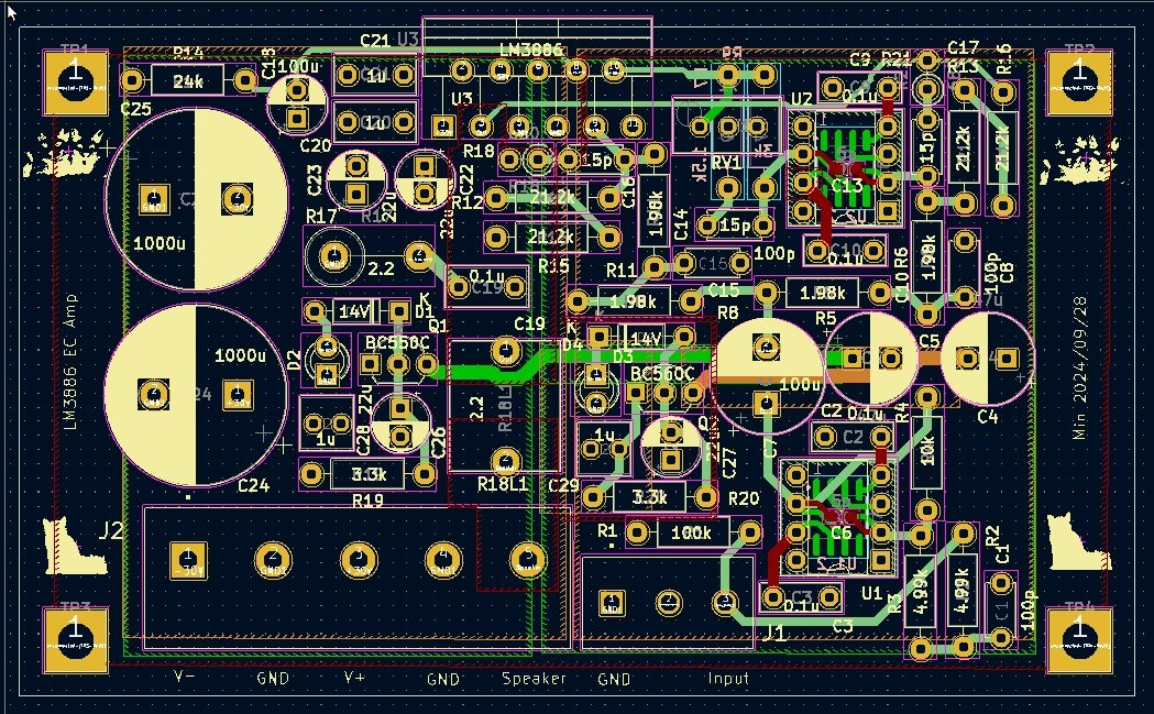

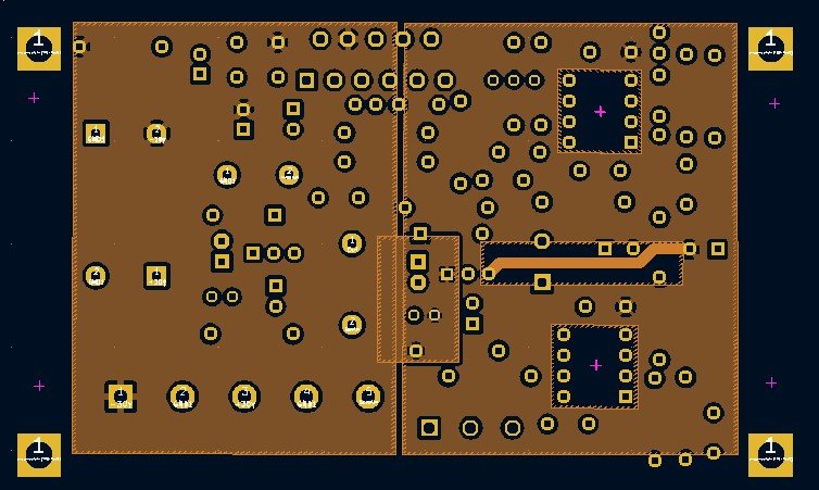

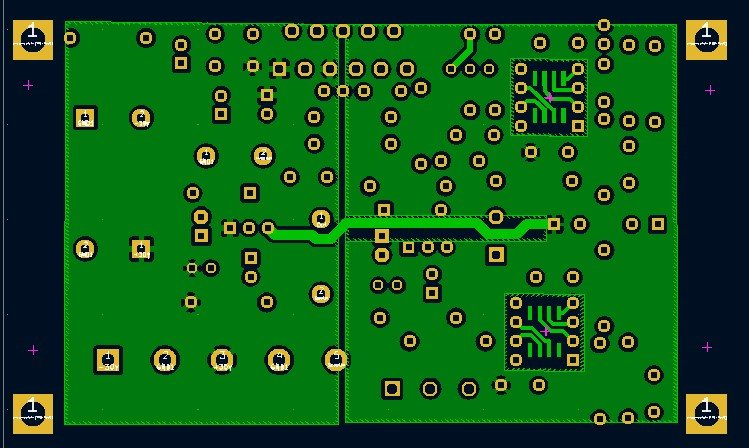

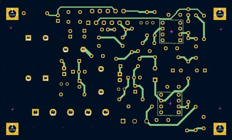

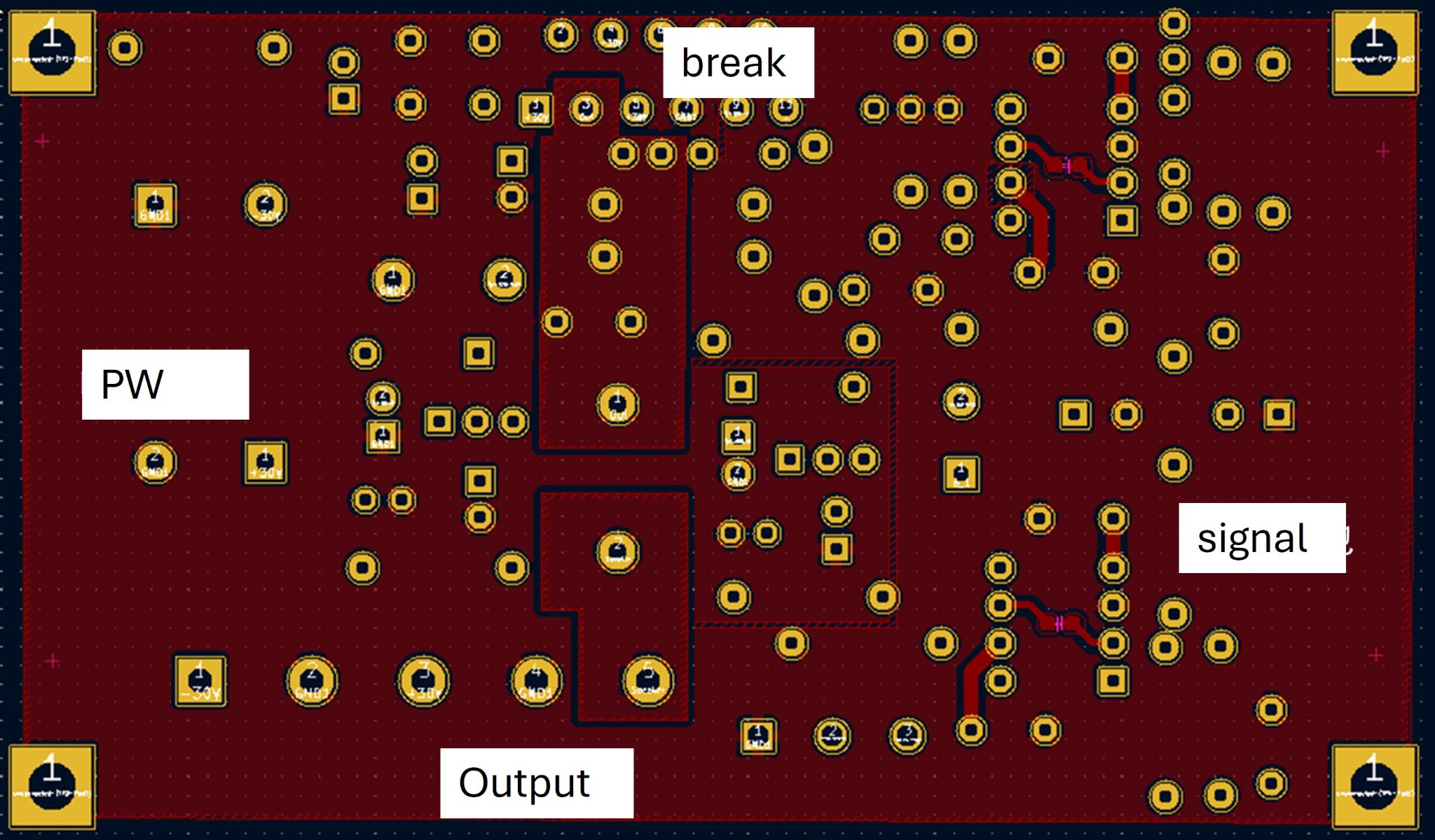

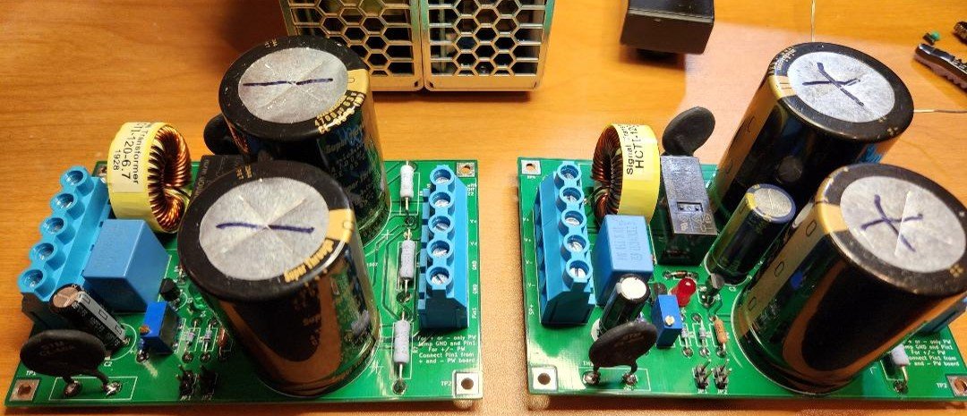

PCB layout
Top: GND, Output
Inner 1: signal
Inner 2: negative -30V/-15V
Bottom: +30V/15V
Top: GND, Output
Inner 1: signal
Bottom: +30V/15V

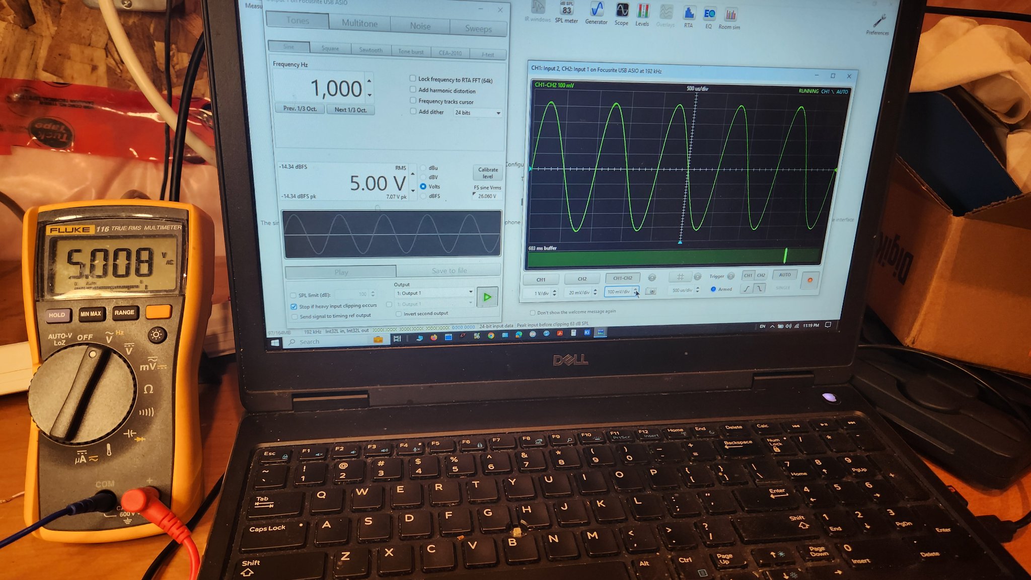

What does that mean?The single LM3886 version was tested with excellent stability.
Did you look at the step response with increasing capacitance across the load? How about clipping behaviour with a sine wave input?
Tom

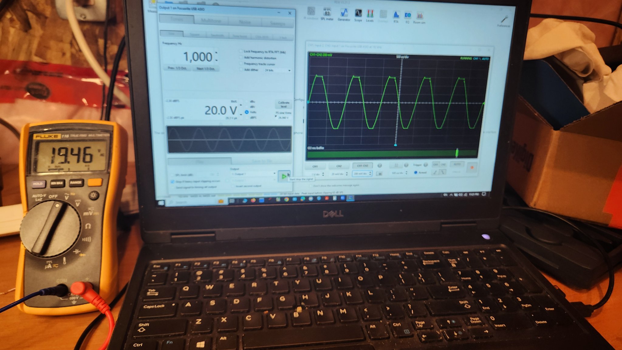

With the value in the schematics, the clipping behavior is excellent. I can increase the input to bring the amp to clip, then reducing the input bring it back to normal. No oscillation.
I haven't done the capacitor load test yet. I will try it shortly.

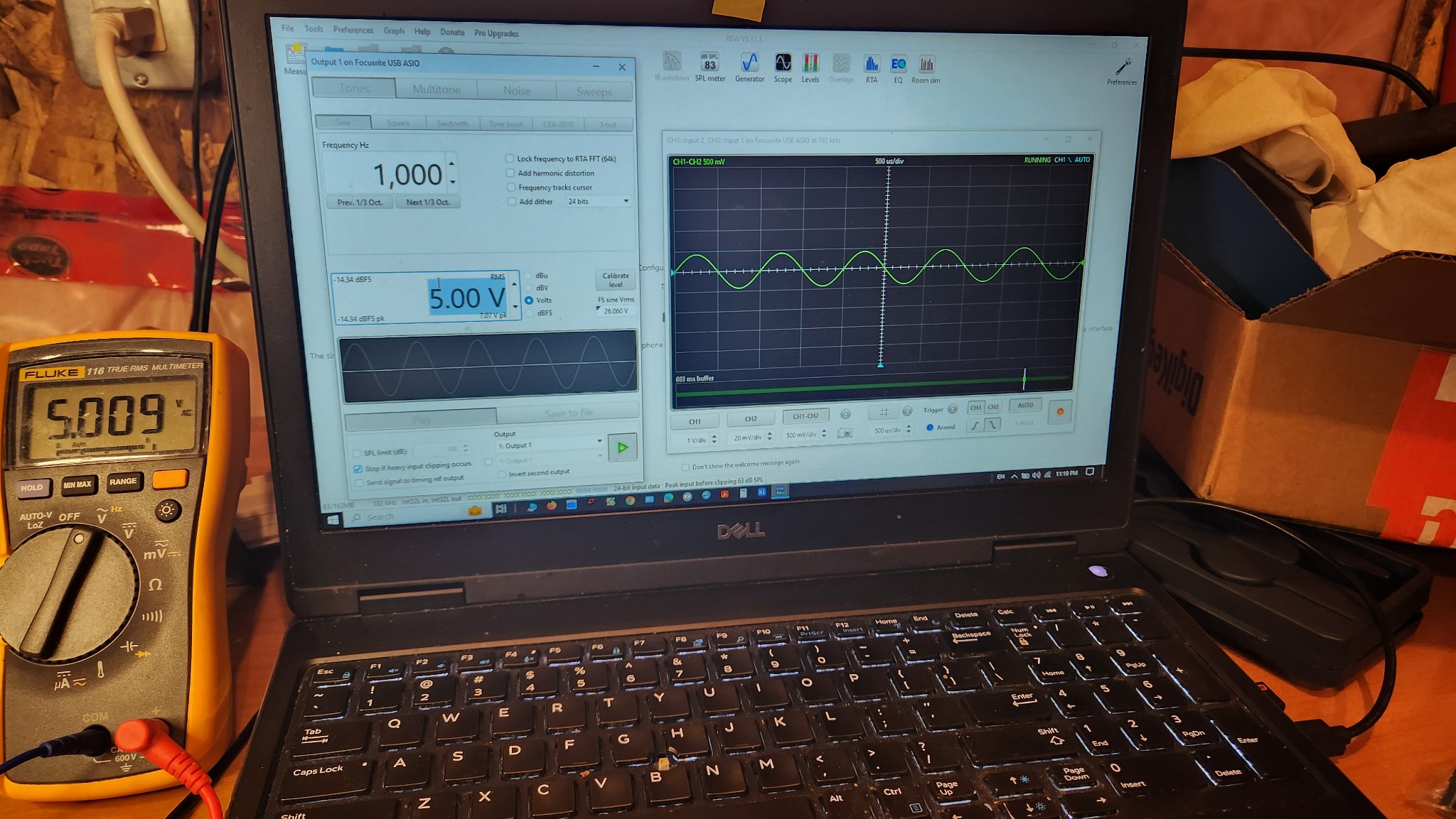

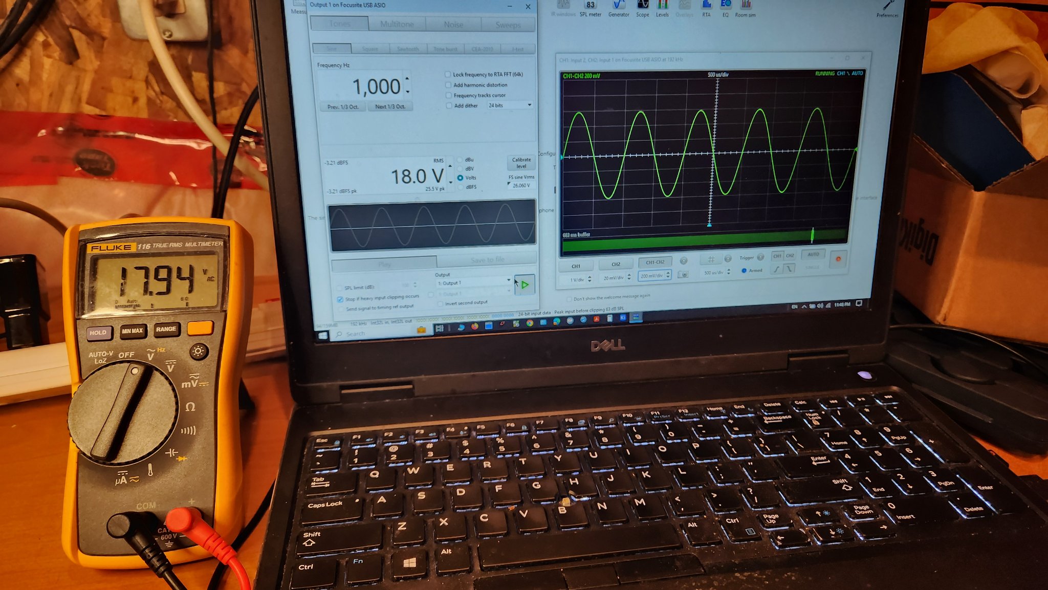

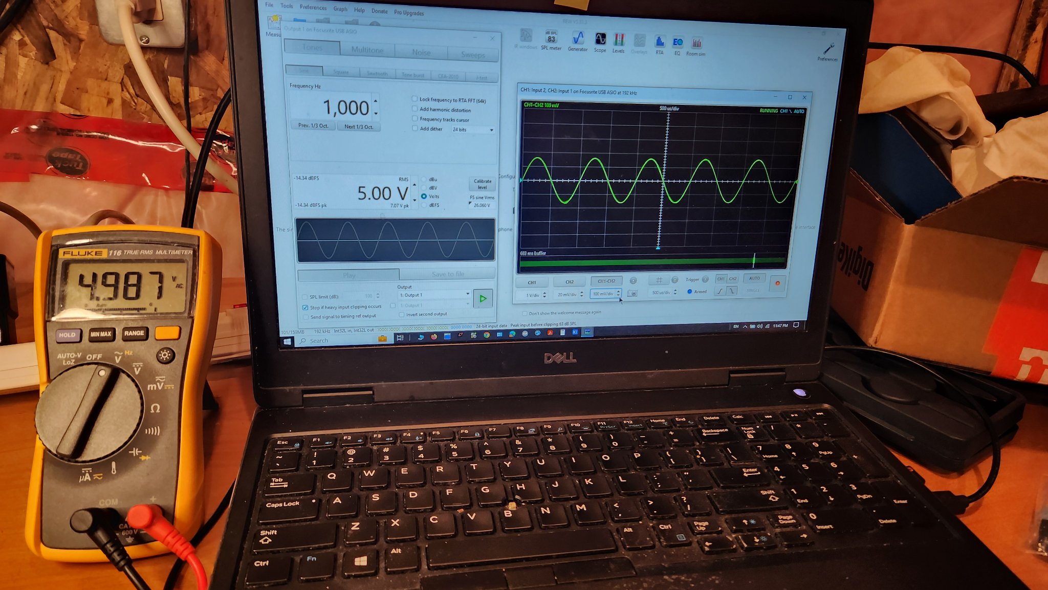

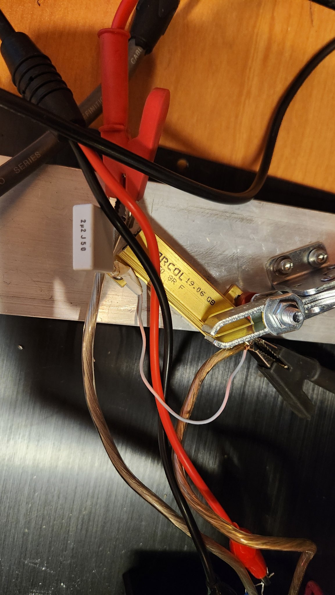

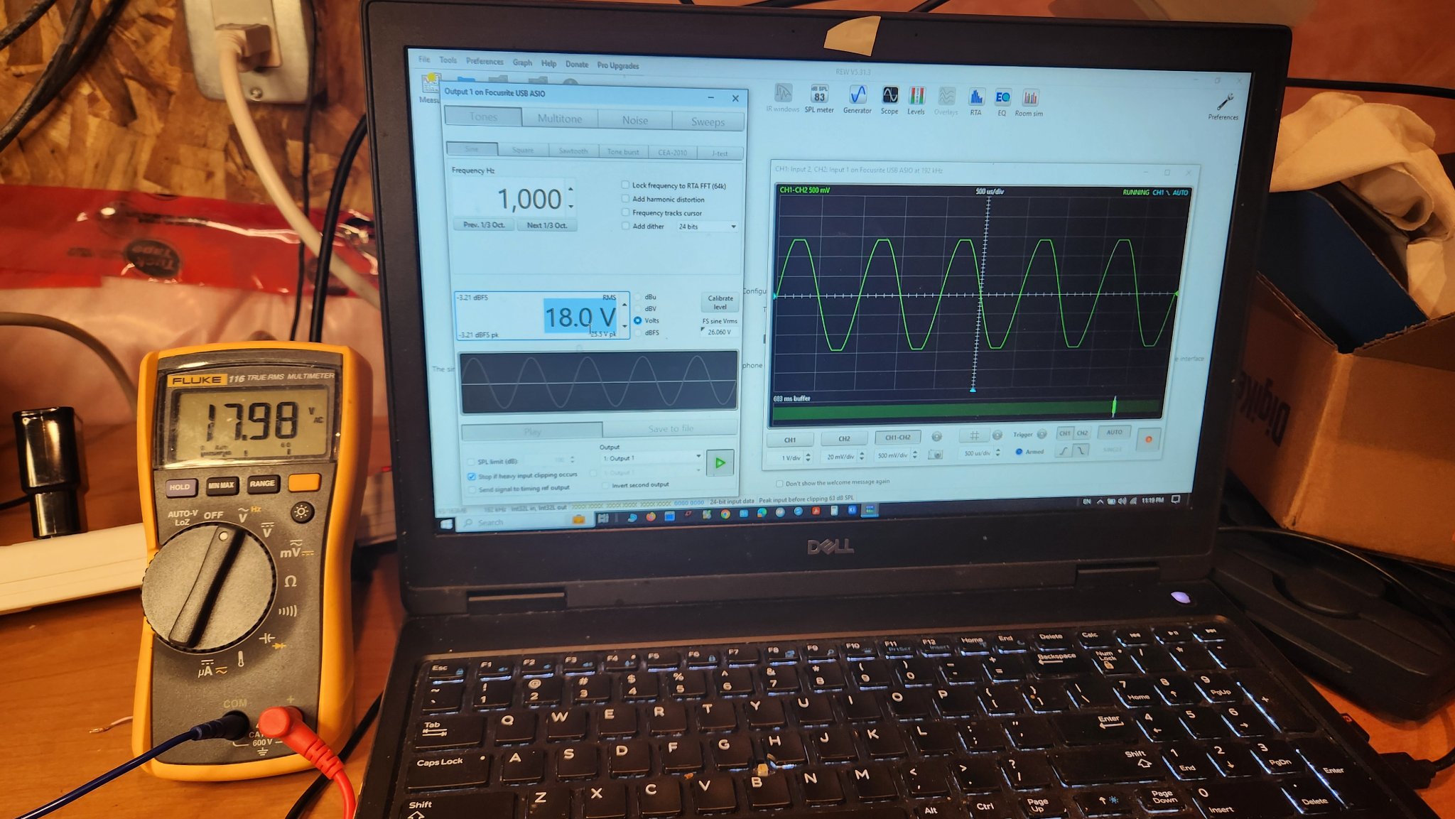

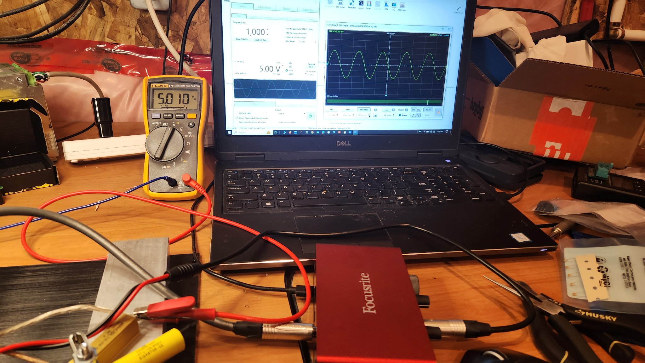

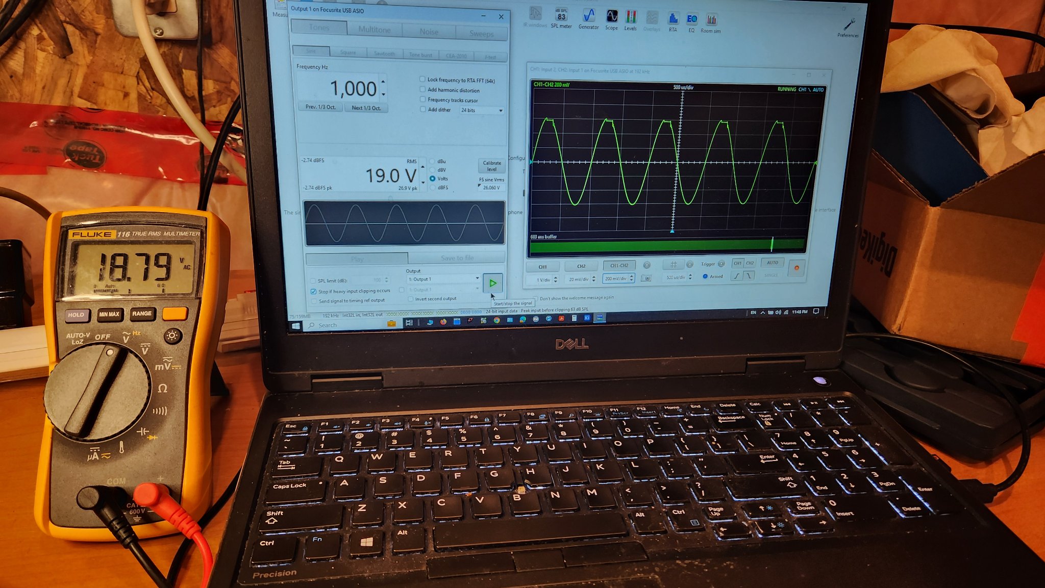

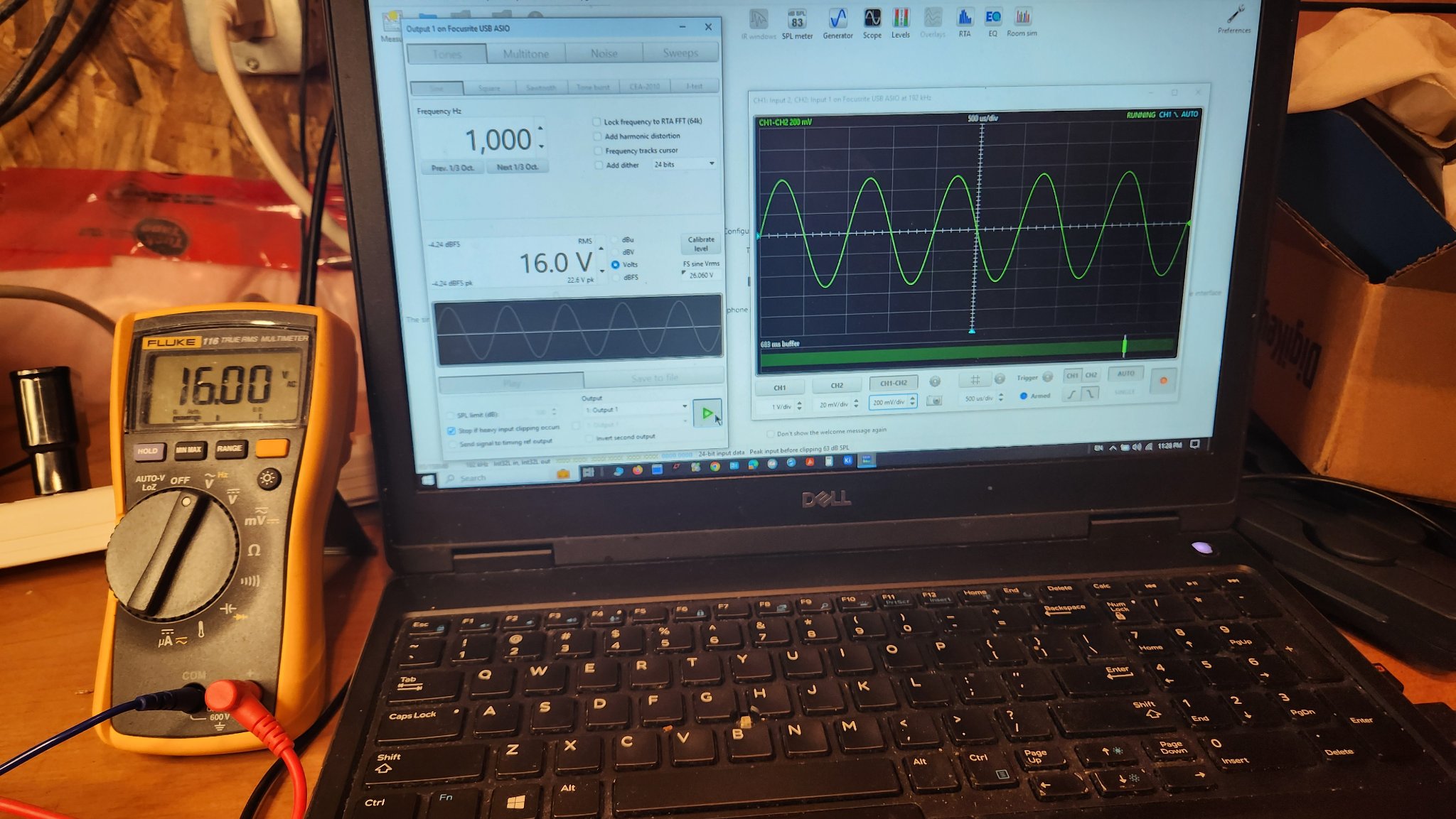

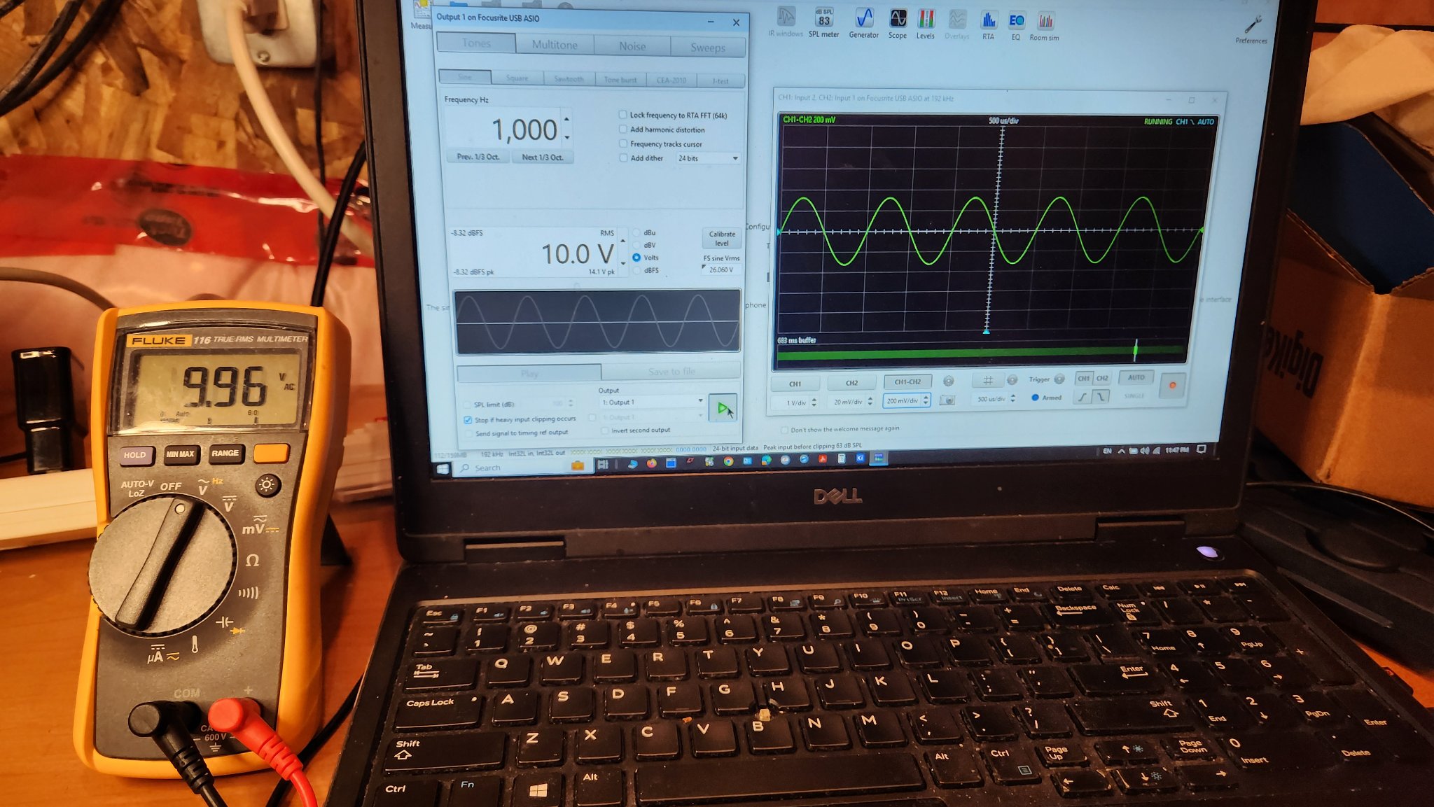

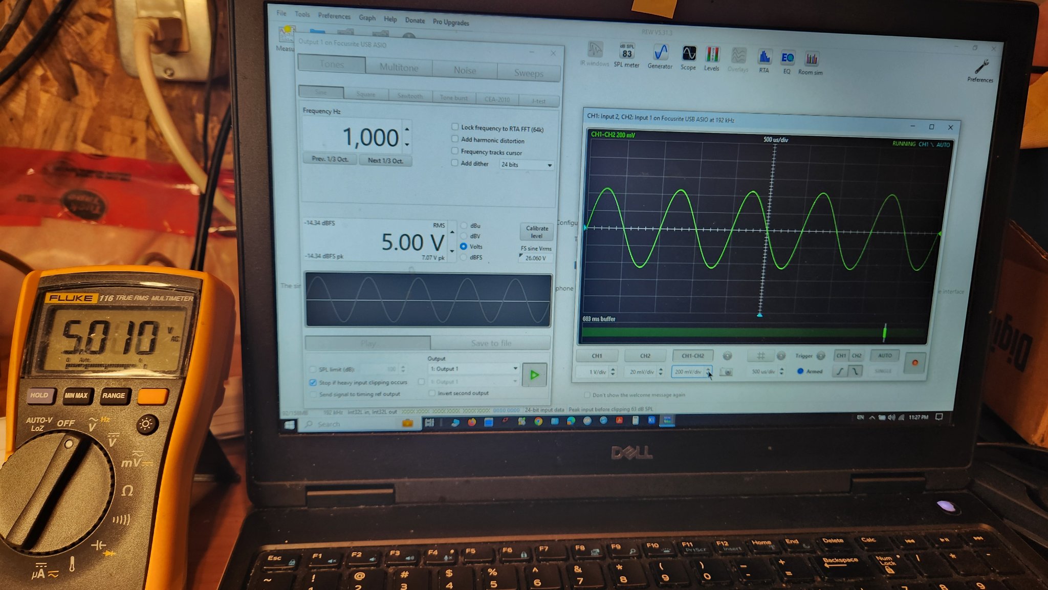

Clipping clipping behavior: PW +/-29.5V, 8Ohm resistor, 1Khz sine wave.
1. setup
2. 5Vrms output
3. 18Vrms output, clean clipping
4. reducing input back to 5Vrms output
5. hard but clean 20Vrms clipping
1. setup
2. 5Vrms output

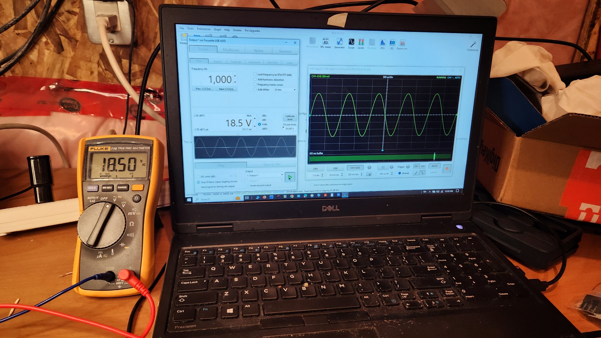

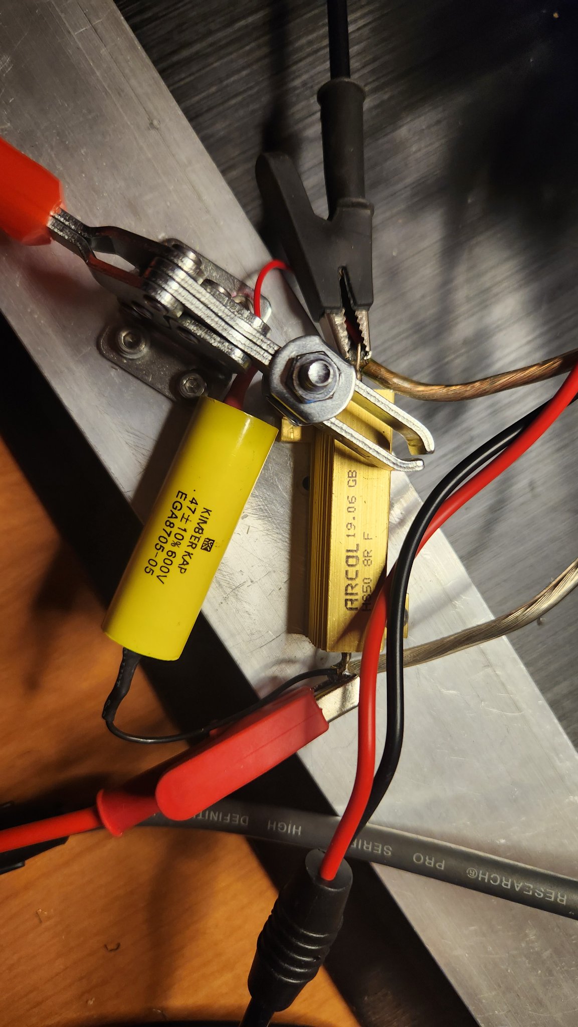

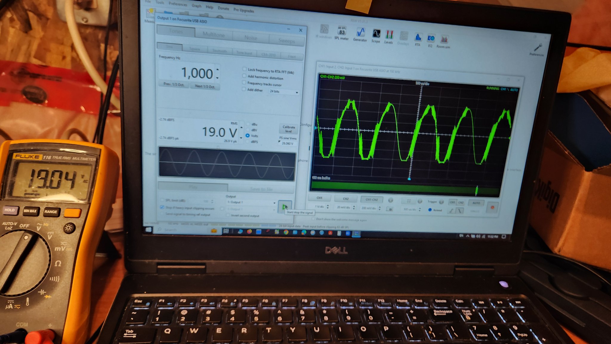

capacitance load and clipping behavior at small capacitor load: PW +/-29.5V, 8Ohm resistor//0.47uF capacitor, 1Khz sine wave.
1. setup
2. 5Vrms output
3. setup
4. 16Vrms output
5. 18.5Vrms output, looks like with a small capacitor, clipping at higher output voltage
6. 19Vrms output, the amp clips and lost stability.
But by reducing the input, the amp becomes stable again.

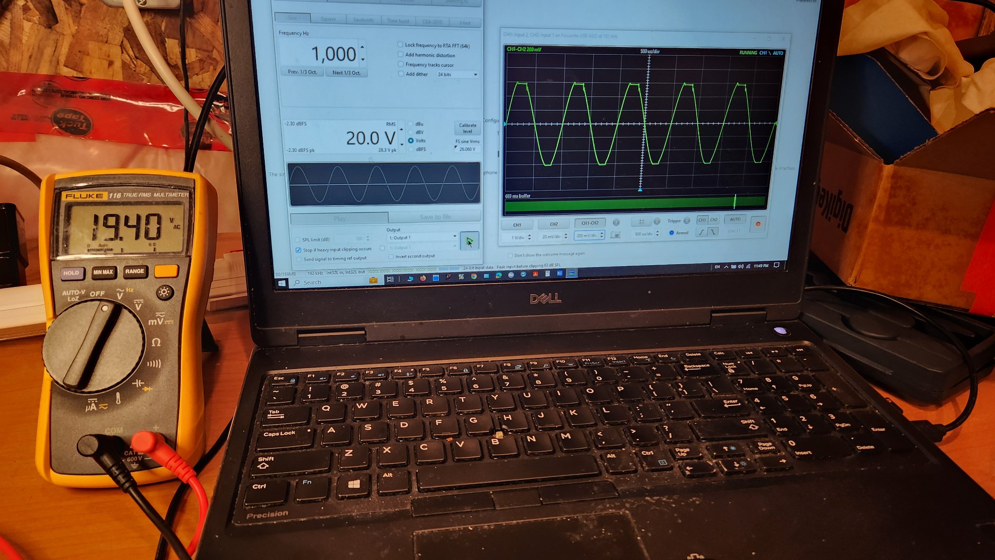

capacitance load and clipping behavior with large capacitor: PW +/-29.5V, 8Ohm resistor//2.2uF capacitor, 1Khz sine wave.
1. setup
2. 5Vrms output
3. 10Vrms output
4. 18Vrms output
5. 19Vrms output, it starts clipping but stable
6. 20Vrms output, the amp clips but stable
