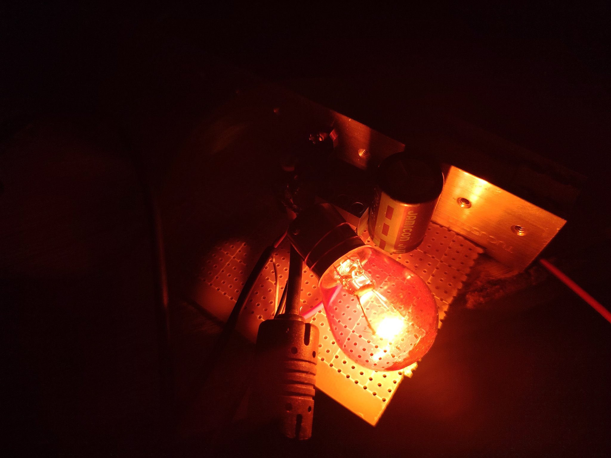

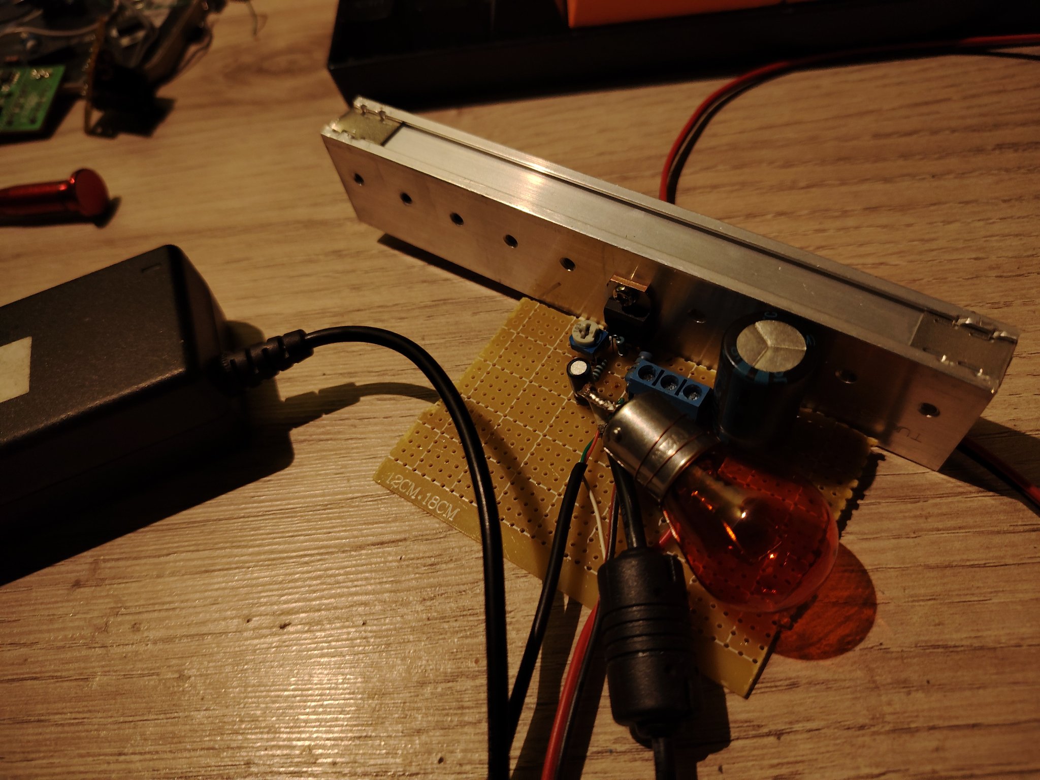

I'll start and i present you the "De broke" an cost cut version of the delite using a darlington transistor and a car turn signal lightbulb (that was cheaper than a headlight one and has a diffrent glow) and running on 12V making a whopping 1,5W of power at 8 ohms.
The schematic is taken from this video except for the power resistor being replaced with a lightbulb.Video with the schematic
