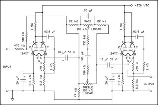

Really good tone controls are complex. The provided Max Robinson design requires (sic) 2X 12AX7/ECC83s per channel. Also, few recordings benefit from the use of tone controls. Most of the time, tone controls should be completely out of the signal path. The provided setup is "unity" gain, which greatly assists the defeat feature.
FWIW, I suggest you forget tone controls, this time around. You said a small amount of gain would be good. There are quite a few 12B4 based designs in the archives, which should meet the need. Don't worry about a PCB, as these are simple circuits. "Monkey see, monkey do", will get you to a satisfactory end point.

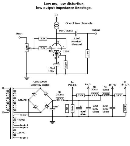

The signal circuitry is simple, in my version of a 12B4 preamp. The PSU in the schematic I'm providing is somewhat involved, but using it is not essential. I worked up that design to accommodate what "Buzz" had on his parts "pile". Well filtered "150" VDC and 10M45S plate loads will be fine into the "friendly" I/P impedance of the "Aleph".
BTW, you don't need pricey Mundorf O/P coupling caps. too. "Buzz" likes "boutique" parts. 😉 Given the high I/P impedance of your "Aleph", 0.22 μF. Soviet surplus K40 paper in oil (PIO) parts will be FINE.
Thanks Eli, could you recommend a transformer that would work for me here in Australia with 240Volt mains?
Eli, my eyes aren't what they used to be. Can you provide a larger image than the one in Post 4?
Triad magnetics offers inexpensive stuff with dual primaries that work in both "120" & "240" VAC zones. 🙂 A Triad N-68X isolation trafo will be fine for bridge rectified B+. A Triad VPL24-400 will take care of heater power. Use 1 of the paired secondaries in each channel.
Maybe the provided upload will help. Also, install IrfanView on your PC. That freeware is great for manipulating all sorts of graphic files.
So I only need one of each transformer to make stereo? And the white lead of the isolation trano is earth? In your schematic what are components 9H and 5H please? Chokes?
Yes, those are chokes and they can be costly. The unit of inductance is the henry. "Buzz" already had them and that's what I designed around. The schematic shows a pseudo choke I/P filter and pseudo dual mono. That = $$. You can get away with a "simple" CLC, AKA Π section, filter. Once again, Triad offers a suitable, inexpensive, part for the L. It's the C-7X. Constant current source (CCS) loading of the 12B4s will give you a pretty good power supply rejection ratio (PSRR).

At this point I am attracted to Eli's design, I have the good schematic for the preamp and I have the correct transformers however I am not at my stage able to design or source a nice little well filtered power supply that fits.
I feel that if such a schematic or kit were available this could be a reasonable project and I would be prepared to order the bits and have a go. I have come to a stalemate every time I look hard at any of these projects for my lack of downhome knowledge that you guys take for granted. Fair enough,I know how dull it can be teaching people how to repair their musical instruments as well. Aikido may come up with answers for me when they get my email.
