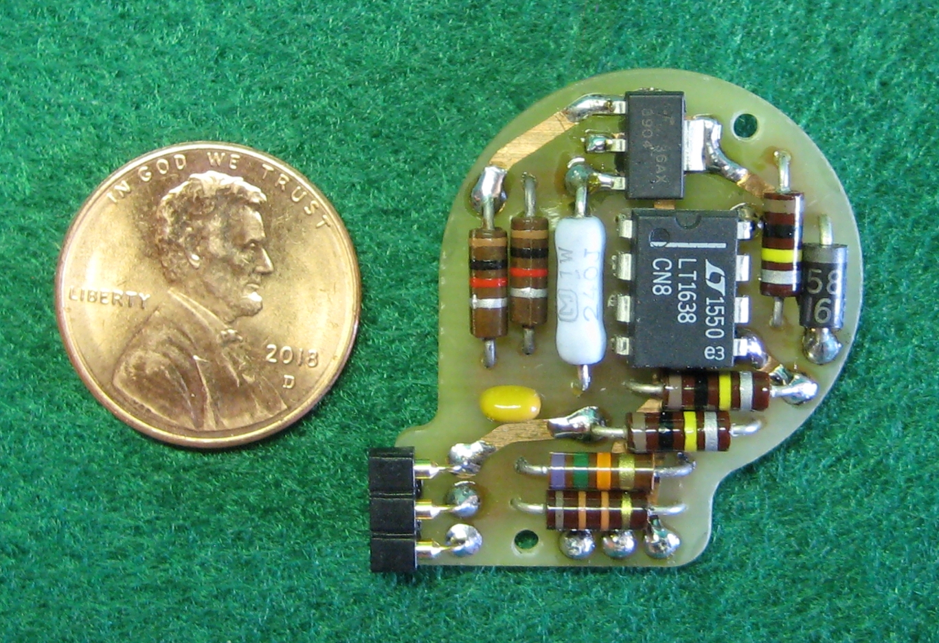

My original 2017 servo’s printed circuit board (PCB) utilized “through-hole” components. In 2018 I redesigned the PCB to utilize “surface mount devices”.

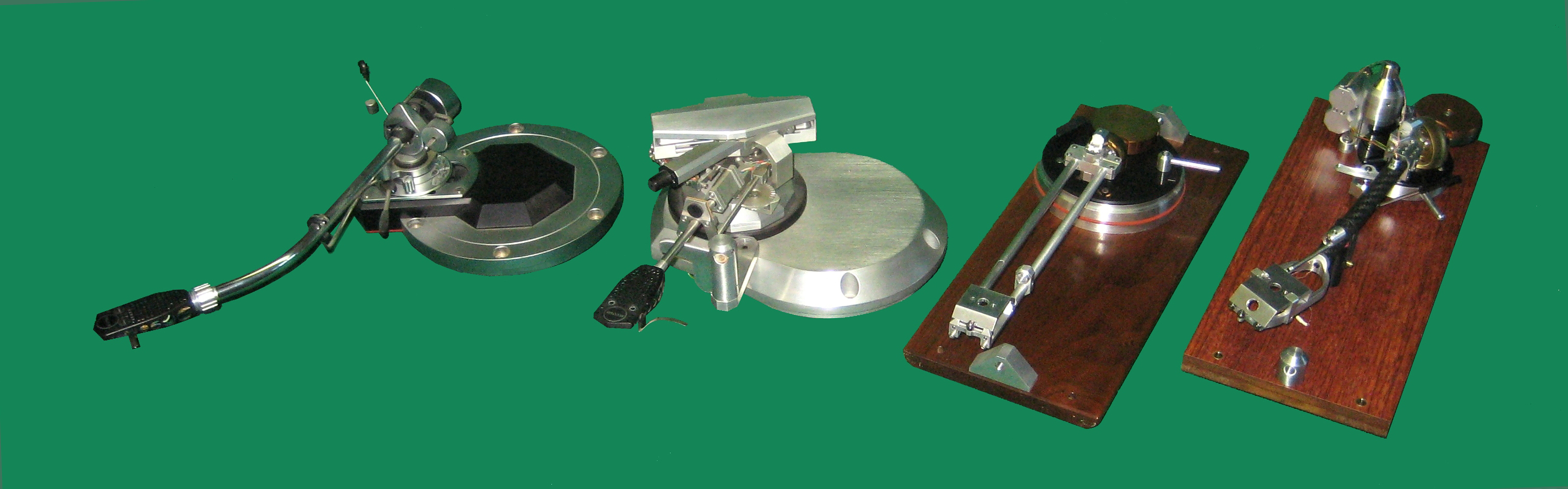

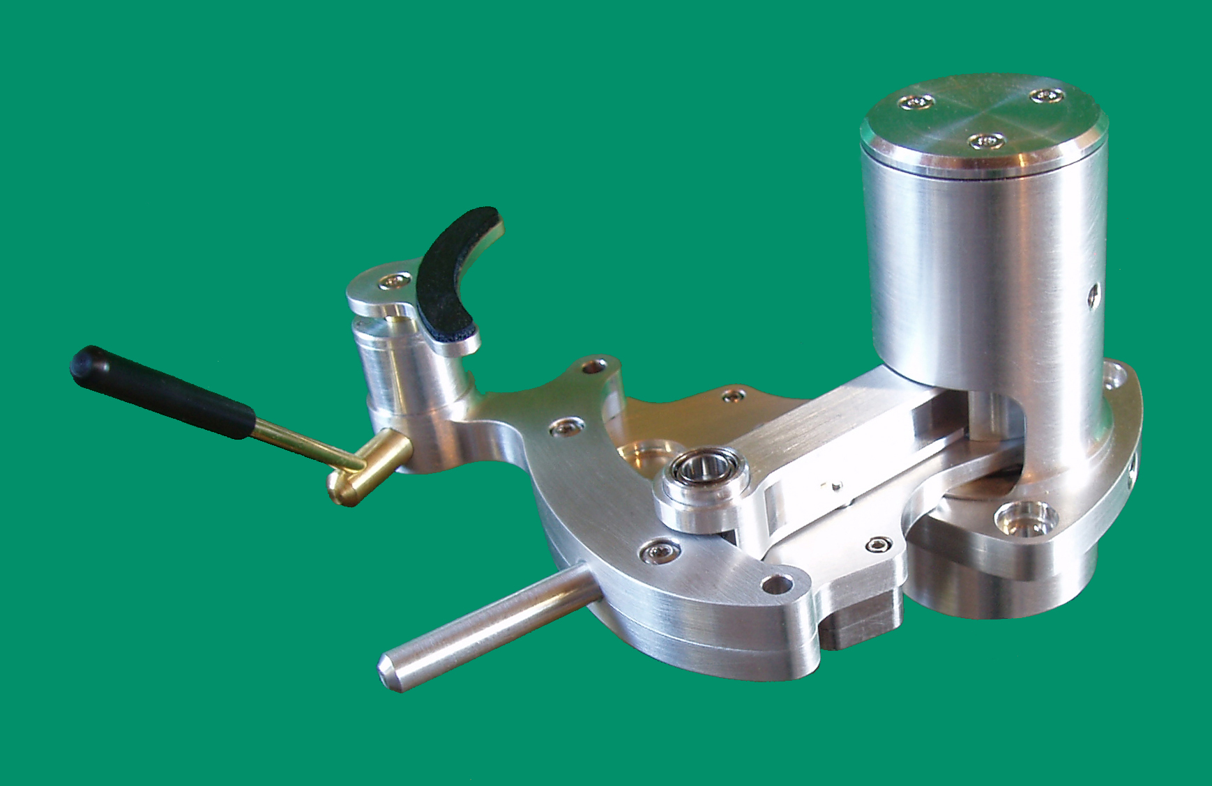

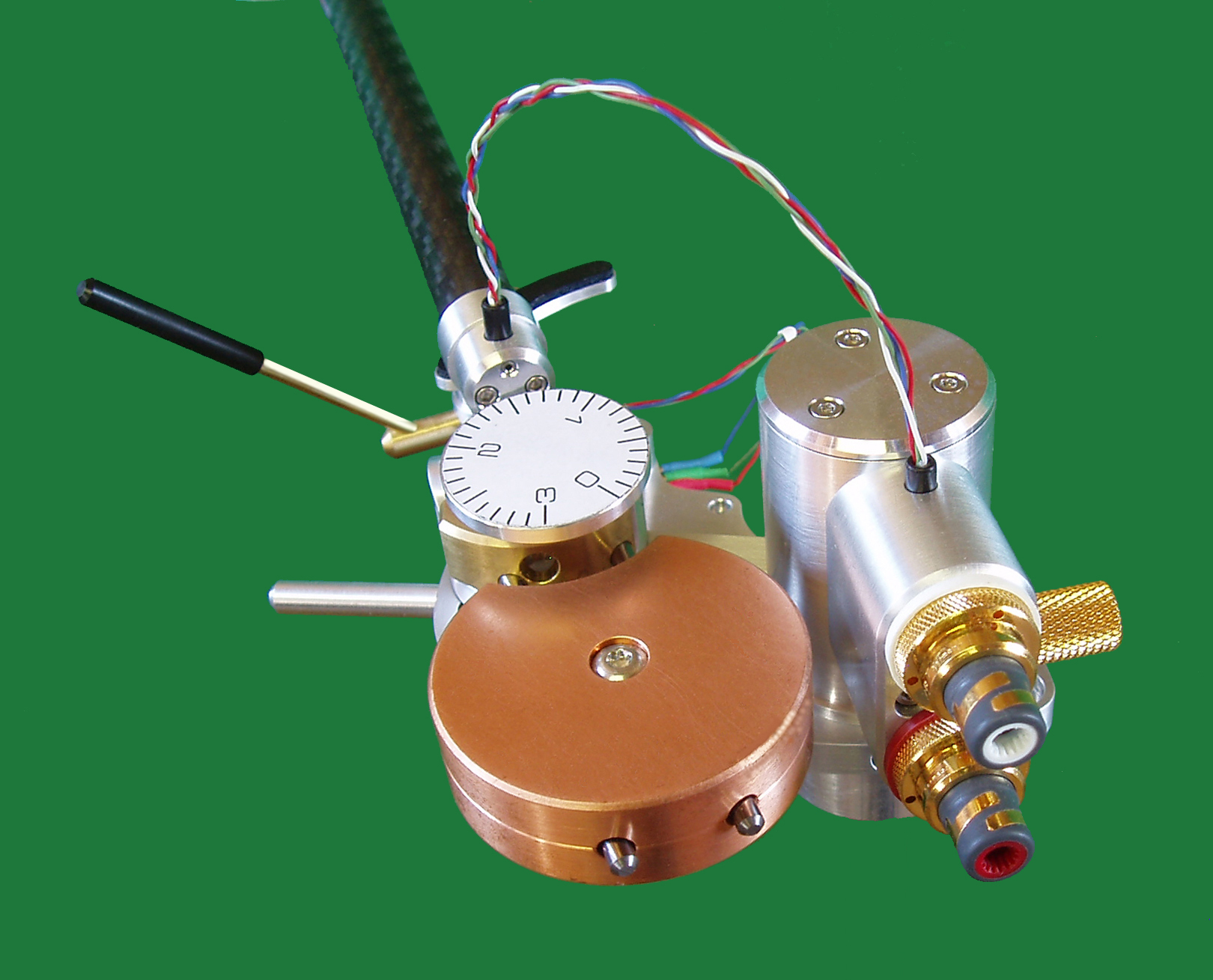

1. GROUP 1980 – 2018
A. SME 3009/S2 improved.
This is the one that started my fascination with tone arms.
B. My first attempt at tone arm design. Its tracking error was ±.1°. It had
an optical sensor by H.P. and was driven by a stepping motor. I
patented it in the early 1980s.
C. My design from 2012. The first to use my invention of the “FLOATING
HEAD-SHELL”.
D. My design from 2015, having a ‘FLOATING HEAD-SHELL” and an
“OFFSET HEAD-SHELL CRADLE”

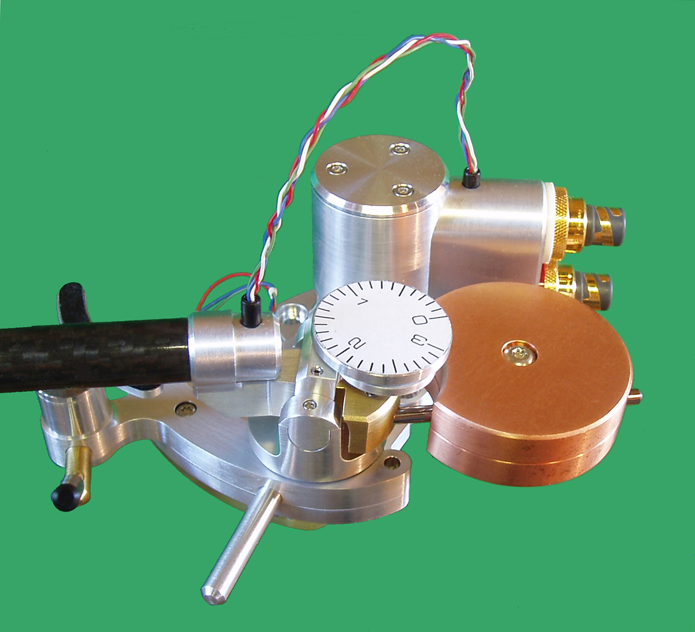

MY 2018 TONE ARM
2. CHIPS

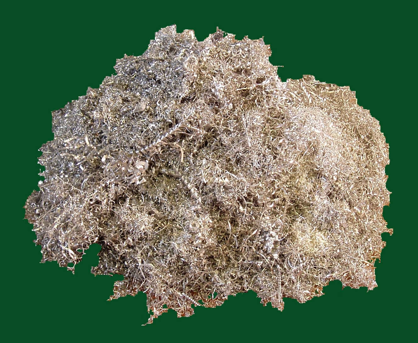

I started with a billet of 7075 aircraft aluminum and simply removed all material that didn’t look like a tone arm.

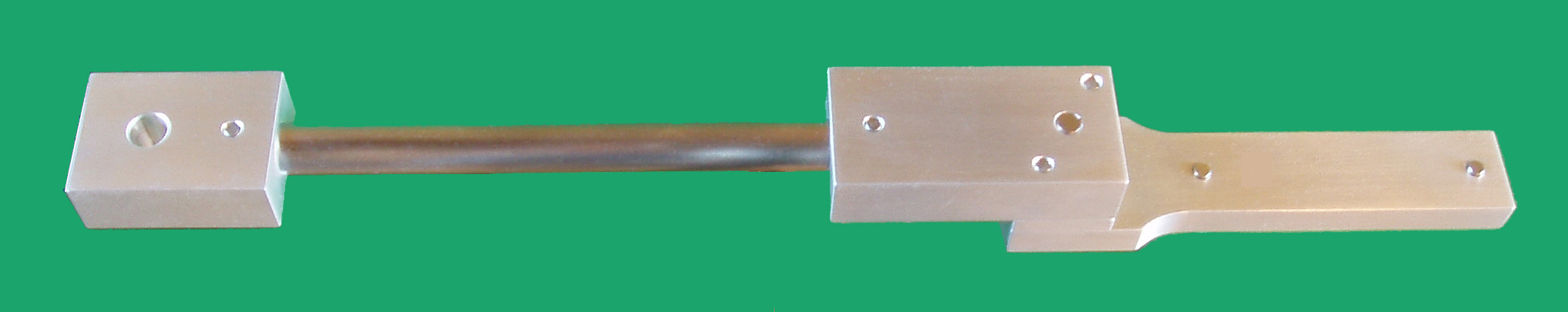

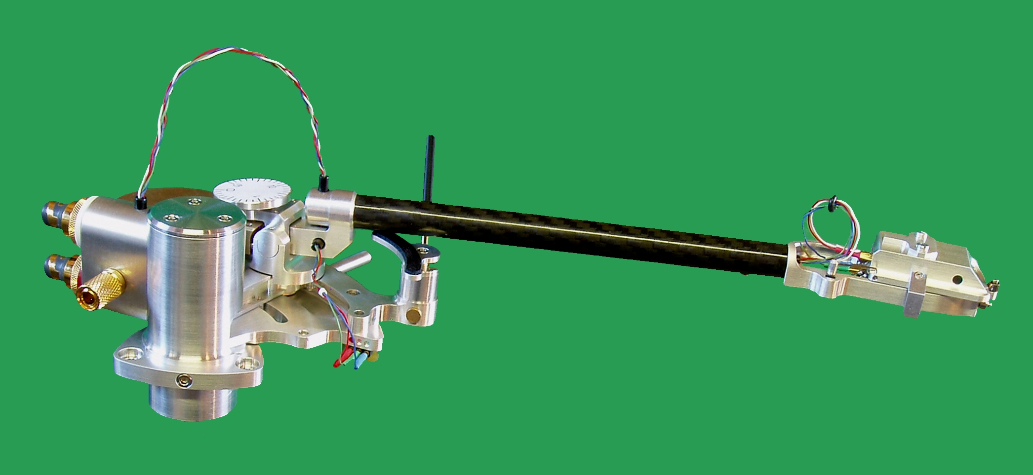

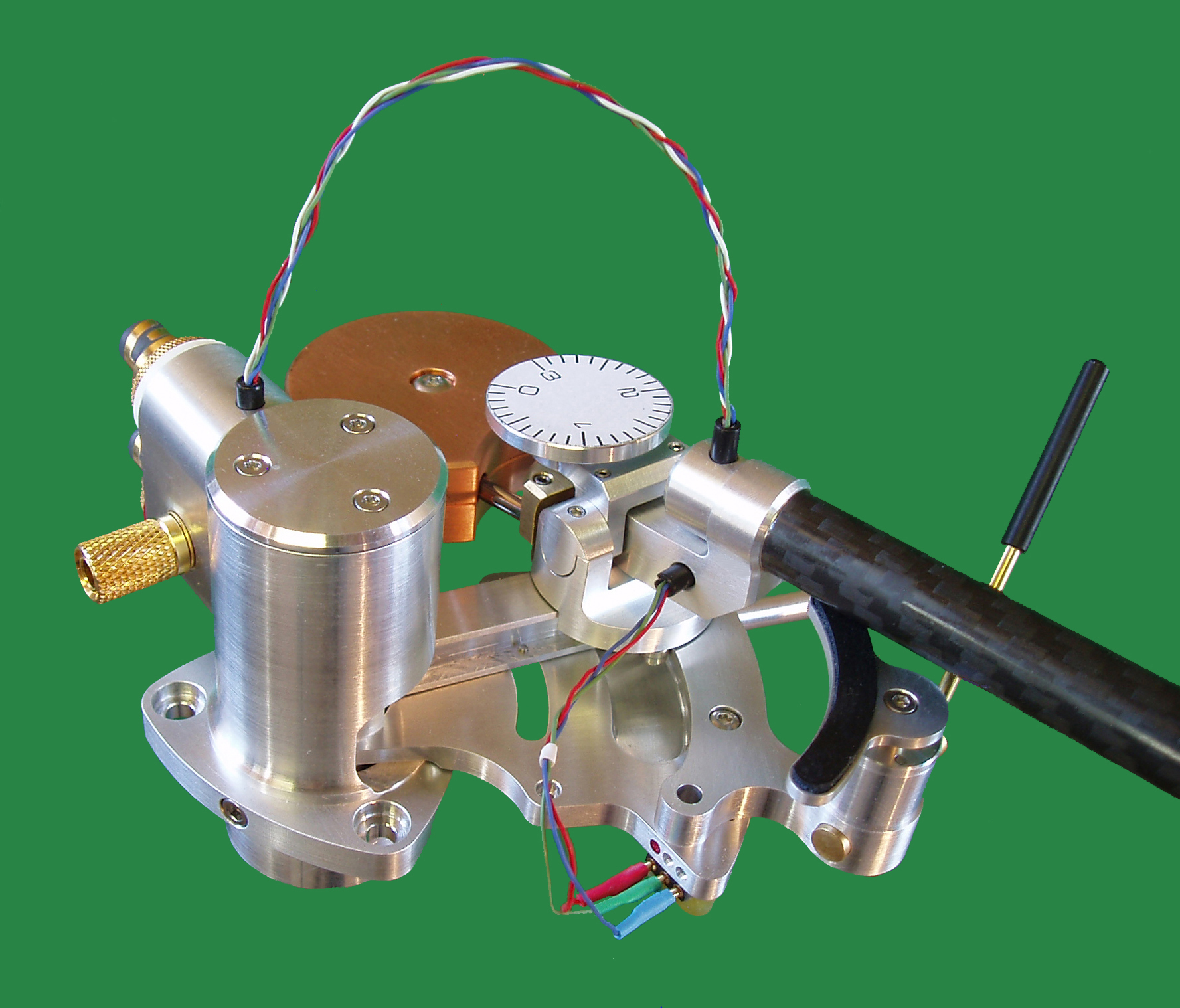

3. Right hand view.
4. Left hand view.

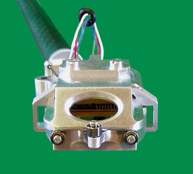

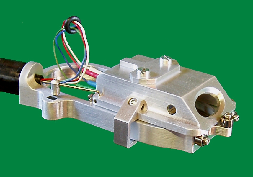

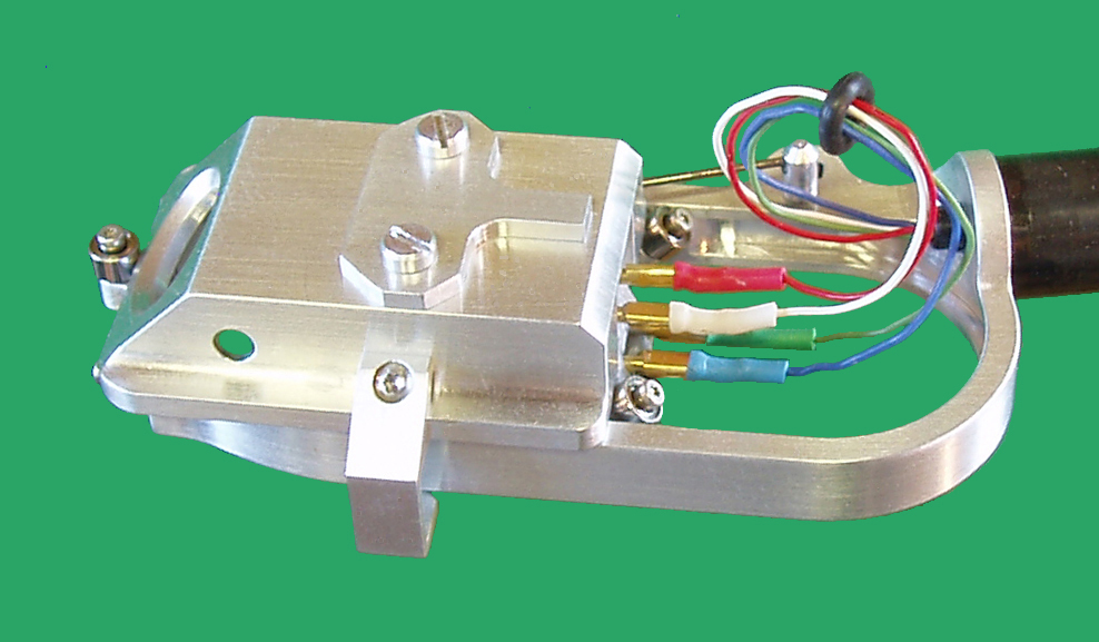

5. “FLOATING HEAD-SHELL”, right hand view.
6. “FLOATING HEAD-SHELL”, left hand view.
7. “FLOATING HEAD-SHELL”, front view.

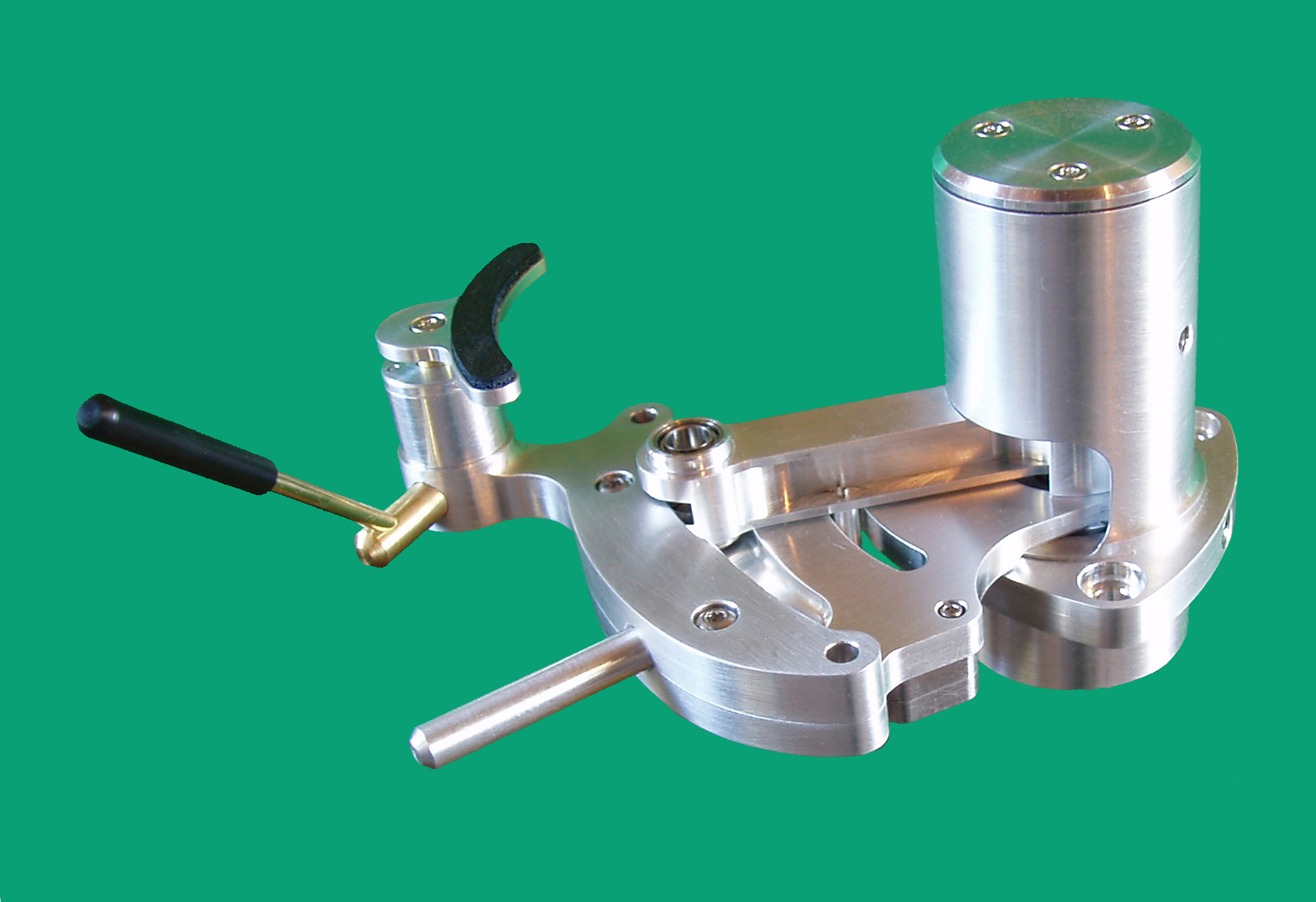

8. Tone arm base, right hand view.
9. Tone arm base, left hand view.
10. Tone arm base, rear view.
11. Tone arm base only, start of play.
12. Tone arm base only, end of play.

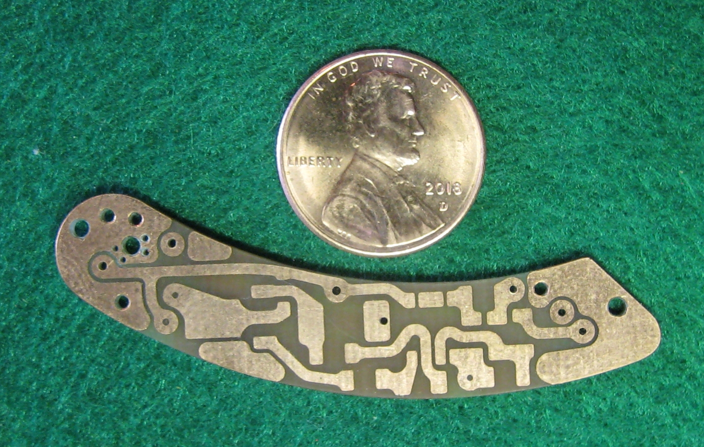

13. 2017 Servo P.C.B.
14. 2018 Servo P.C.B.

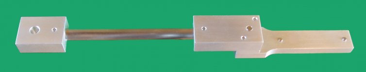

15. Alignment gage.

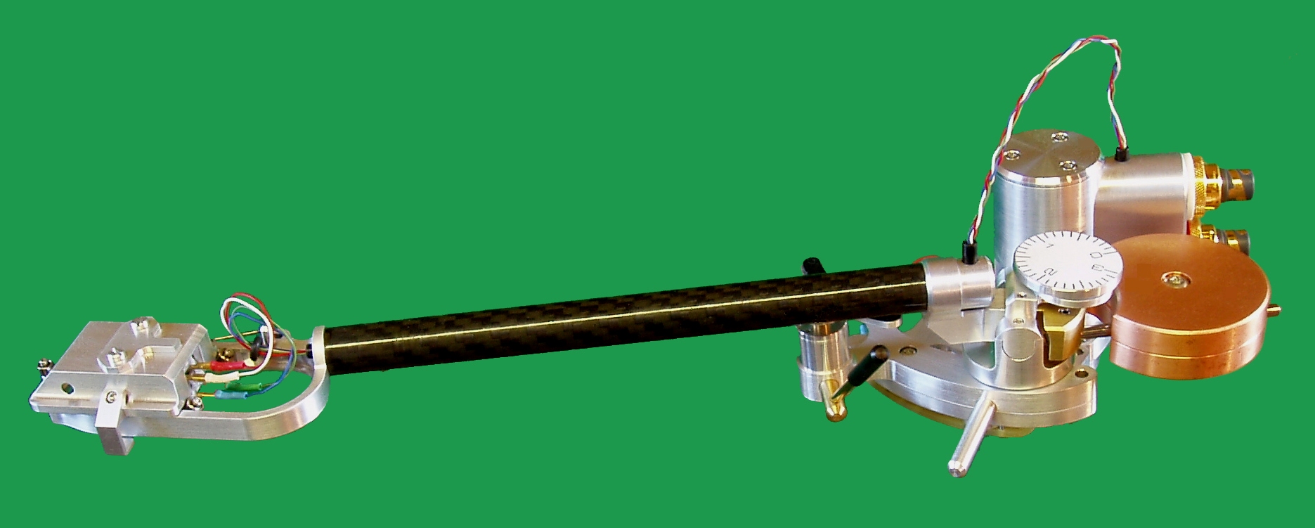

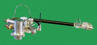

TONE ARM 4, MODEL 7
Specifications
- Pivoting tangentially tracking tone arm with revolutionary “FLOATING, OFFSET HEAD-SHELL”.
- ZERO tracking error.
- ZERO skating.
- Head-shell tracks in a straight line for zero eccentricity wow.
- Tone arm is solely driven by the frictional drag between the vinyl LP and the stylus.
- Built-in electronic servo controls the constantly varying drag force.
- Tone arm is supported by flexural pivots for motion in the vertical plane and is dynamically balanced.
- A wall-pluggable USB power supply provides 5V DC to the servo circuitry.
- Tone arm fits into one corner of any turn table.
11. Tone arm wiring can be assembled and disassembled to and from the
tone arm without soldering.
12. Pivot to stylus distance is: 8.238” (209.24mm)
13. Tracking force is adjustable from 0 to 3g.
14. Materials used are 7075 aluminum, brass, stainless steel, copper and
carbon fiber tubing. All fasteners are stainless steel.
LIST OF PHOTOGRAPHS
HEAD-SHELL”.

What I see is a Birch-like geometry, but Straight Tracker stated, that the headshell tracks in a straight line.
He stated also that there is no skating, although the headshell is angled .
The „floating headshell” can move laterally on the „offset headshell cradle” on five ball bearings, but what for? Is the friction of the five ball bearings lower than the friction of the main horizontal bearing, attenuated by the length of the tonearm? What is the function of the small counterweight on the floating headshell? It is fixed asymmetrically. On the design from 2015 it is symmetrical.
Questions, questions…
Another question is what is the black rectangle under that small counterweight that looks like some kind of sensor mechanism?
