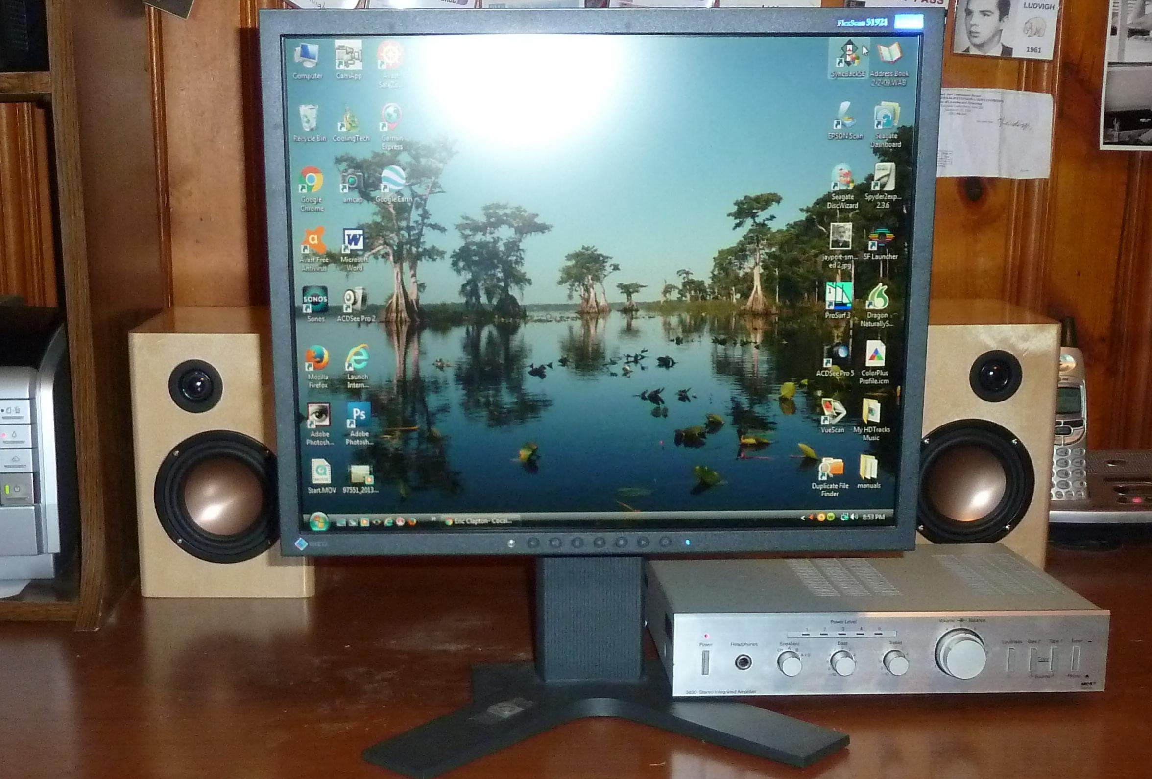

The XLS-encore uses components that add up to more than the purchase price because they are being sold at a loss. Peerless paper cone woofers, Vifa soft dome tweeters, heavy duty air core crossovers with film caps, binding posts, port tubes, wires and all hardware. $170 is tough to beat for a pair of speakers.
Yes well take a hint. your design does not include BSC and
is just as wrong as the original design for the same reason.
Conversely that makes it a far better nearfield than farfield.
so it is in fact it is best used as a desktop monitor, not hifi.
rgds, sreten.
The woofers are GR-research and the same as in the XLS classic kit,
which cost $110, which IMO is the killer value speaker kit. There is
nor much difference in the crossover quality, just dubious bypass
caps to up the ante, and your just spendi extra on more expensive
tweeters. which of course will be better, but IMO the premise is flawed,
the GR research bassmid is not so great that its badly let down by the
Classic tweeters, IMO its flannel and a bit of marketing.
They would have to be poor for it to make sense, and they are not.
YMMV but the $110 Classic kit beats the Encore hands down for VFM IMO.
Not that I'm saying the Encore is a bad buy at all, its still very cheap
for all the parts and the very high quality level of the crossover.
rgds, sreten.

No. It would be an appalling nearfield.
Sadly the original write up has been
heavily truncated, why I don't know.
Well not quite true in terms of my suspicion.
The things that make it a genuine LS3/5A
clone have been expunged to make it seem
like a "normal" speaker, whilst in fact it isn't.
Like proper details of BSC and the bass alignment.
rgds, sreten.
