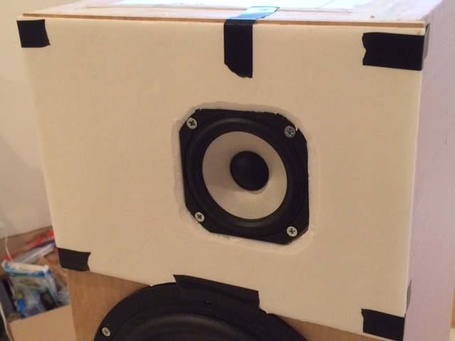

For those unfamiliar with the routine and specifics, please refer to previous thread on Round 3 and references therein. I will only point out the basics here and major changes to the setup from Round 3:
- FAST using my 10F/RS225 Reference speaker (described in another thread) but with the original full range driver removed and replaced with the driver under test. The rear chamber is a tall 3 sided pyramid or "Dagger" stuffed with fiberglass and has very low - almost zero signature and no signs of "boxyness".
- Drivers under test are fitted with sheets of foam core to permit a flush mounted driver to reduce diffraction in the high frequencies. The offset mounting in a rectangular baffle already reduces the diffraction signifcantly.
- Source tracks are converted to mono on Audacity and saved as .wav files and then three test tracks are burned into a single track on a CD. A Phillips CD player provides the music source via the headphone outs which allow volume adjustment for the miniDSP which drives two Ybdz TPA3116D2 amps with OSCON cap mod and bootstrap snubber mod. The miniDSP is using a Harsch XO set at 350Hz XO frequency. The *only* adjustment made in miniDSP between drivers is adjustment of the level of the full range to normalize for different sensitivities (typical -1dB to -4dB).
- Sound clips are recorded in stereo in 24bit 96kHz .wav files with a Zoom H4 recorder to microSD card. Files are then processed in Audacity to set consistent volume at -0.5dB peak for Clips 1 and 3, and -1dB for Clip 2, then converted to 320kbit 48kHz sampled mp3 files. Files are renamed with .asc extension to allow large file uploads to diyAudio servers. Please change extension back to .mp3 to listen.
- The answer key to the driver identities is provided to two diyAudio moderators in case anyone ever suspects identity tampering following results.

Here is a photo showing detail of the flush mounting rebate with foam core:
![502255d1441379545-subjective-blind-comparison-2in-4in-drivers-round-4-round-4-tg9fd-testing-rebate-detail.png](https://www.diyaudio.com/forums/attachments/full-range/502255d1441379545-subjective-blind-comparison-2in-4in-drivers-round-4-round-4-tg9fd-testing-rebate-detail.png)

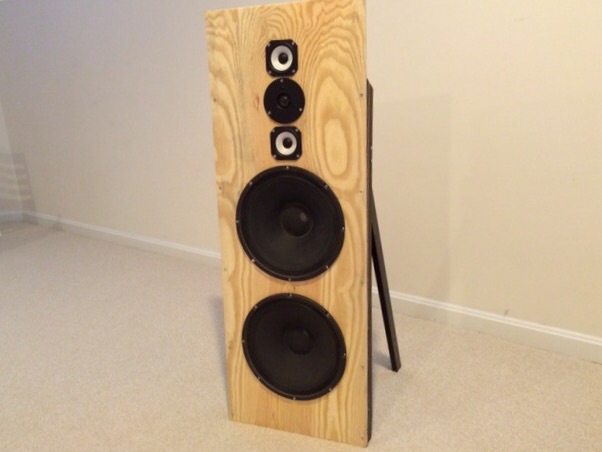

Running them wideband as a subjective comparison test has some value, but then there's the issue of how you would actually use them in a multi-way system.
The thing I like about the TG9 (which I have many of) is that it makes it easy to avoid having a crossover point between 500HZ and 16kHZ, which gives a very nice stereo effect. If you want more off axis response at the high end, you can always put in a tweeter to handle above 7kHZ. Due to inter-aural crosstalk confusing the imaging cues below about 1kHZ, most stereo effect seems to be a product of the matching of the two sides between about 800HZ and 6kHZ. A very great speaker system IMO would be a hard cone (Kevlar or ?) 8 inch woofer crossed to the TG9 at 500 HZ, with an active 4 pole (bi-amp'd) (which is what I built and am very happy with)(once you've got a chassis with an active crossover, it's easy to add low bass active EQ too, which is a huge plus IMO). I find that I don't mind the limited off-axis treble of the TG9. An abrupt off axis change in FR due to a crossover point being around 2-4kHZ would be worse IMO. If the woofer had a PP cone, you could even do well with a one pole passive crossover. It doesn't get much simpler than that.

All of these drivers can work well in a FAST with a XO between 300Hz and 500Hz. Higher frequency XO will reduce distortion due to smaller cone motion. Some of these drivers can actually even hit 20kHz. I agree that the TG9FD (and the 10F) work superbly as a wide band mid in a 3-way or 4-way system. I have used the TG9FD in a 3 way with silk dome tweeter and a 12in pro audio woofer on the bottom. Super clean detailed sound that is smooth and crisp. This was the "B&O Hole Filler XO"
Look at the bandwidth that the TG9FD had to cover with a 1st order filter on either side:
But doing this yields a clean impulse:
And transient perfect behavior with a right triangle shaped Step Response:
More info here:
http://www.diyaudio.com/forums/multi-way/88135-filler-driver-ala-b-o-12.html#post4382967
![502359d1441426435-subjective-blind-comparison-2in-4in-drivers-round-4-image.jpg](https://www.diyaudio.com/forums/attachments/full-range/502359d1441426435-subjective-blind-comparison-2in-4in-drivers-round-4-image.jpg)
