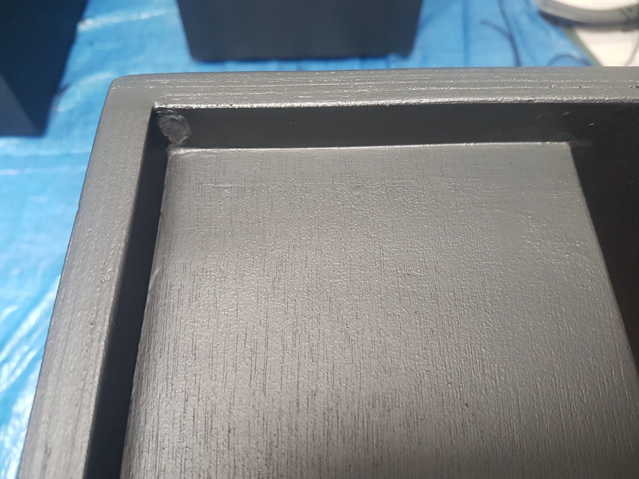

When I first started putting this stuff on (Barn Paint) I thought it was just warnex at 40% of the price, but slightly less gloopy. result. It behaved the same in terms of drying time (not quite as fast) and how it created a bit of texture with the form roller. However, once dried it was obviously different. A much more matt finish with no texture so it doesn't hide imperfections. There are a lot in my cabinets as I havent had time to really prep them properly along with running out of decent sanding belts. It goes on very nicely and seems happy sticking to filler. However, it does have the same characteristic of Warnex that when painting it over glue it allows some discolouration / greying / whitening of the paint to bleed through.
Its a decent enough finish in its own right and will do for now, but I'd say this stuff would make a cheap alternative for doing several undercoats before applying a final few coats of Warnex.
Thanks.
Not bad at all, quite usable for a rental/own use cabinet finish; one advantage is that when it ends up scratched after a few weekends you can easily apply a single cot over and not everywhere, just in the scratched area, and it´s s good s new.
At least as good as you show here.
Obviously, it´s a "paint", yet it differs from Warnex and others only in degree.

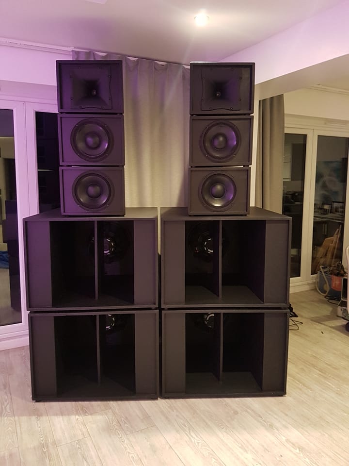

Mids / Tops are Warnex painted, subs not. Certainly from a distance / in dubious lighting you cant really tell the difference
