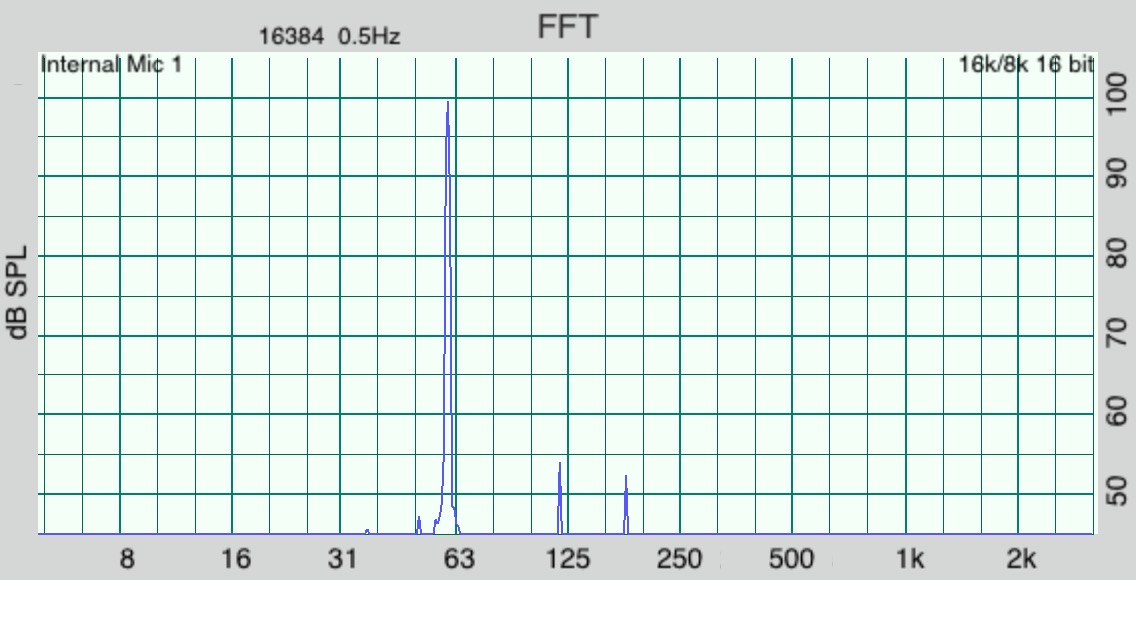

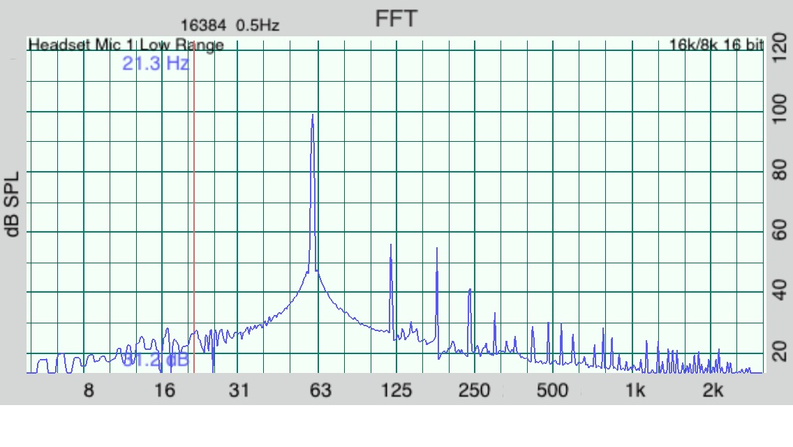

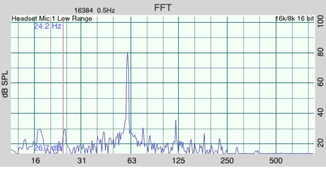

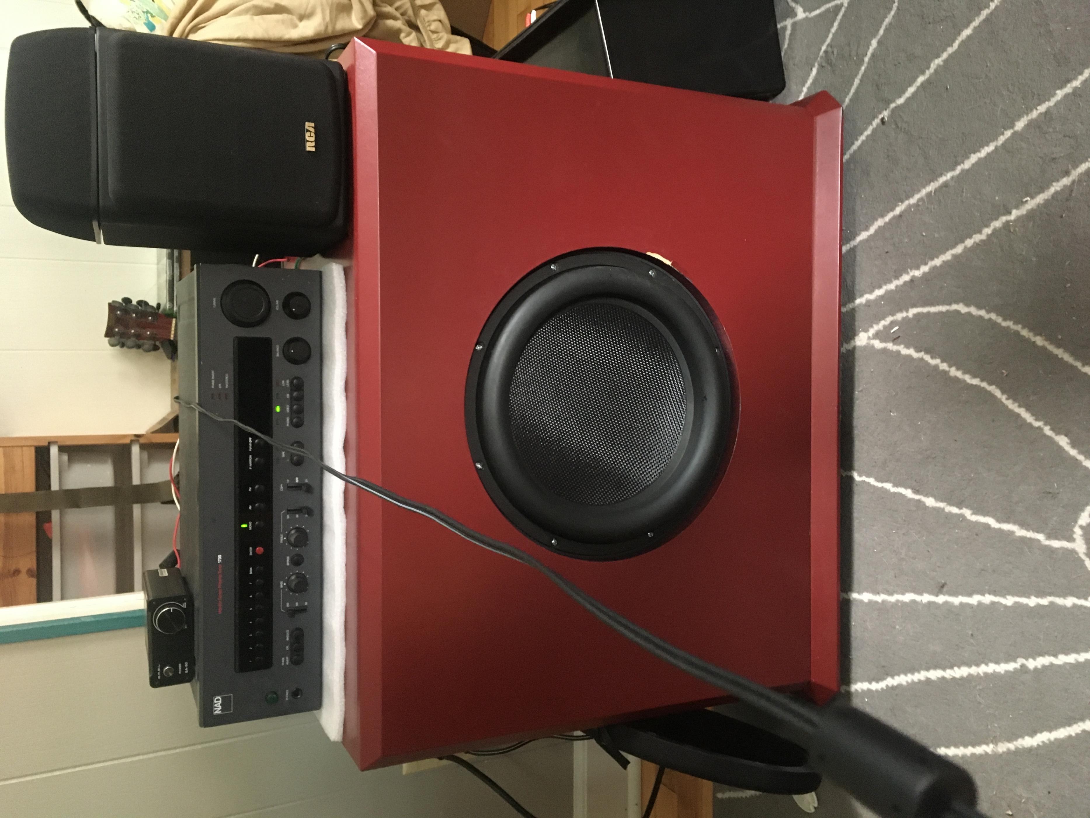

In July I picked up a dayton audio RS1202A Dual subwoofer on the used market. I was very excited about this purchase it uses two 12" dayton reference series subwoofers in 2.1 cu ft (60 liter) of airspace with a SPA1000 plate amplifier.
However, I did not really like the sound of this setup. I'm not sure if the suspension is too stiff or the inductance or moving mass is too high but it seems to miss the peak spl of a kick drum hit and can't keep up with quick notes on a bass guitar. I know there is a lot of opinions of subwoofer transient response and I don't really want to get into that discussion, but I am running these up to 100hz so I am possibly getting into territory where the ear is more sensitive to transient response.
I then decided to take distortion measurements and try different 12" subs in the box.

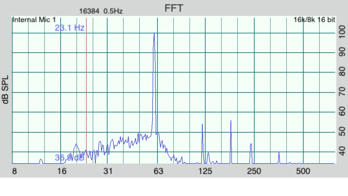

For distortion measurements I used a IMM-6 mic and constant sine waves. I then turned up the gain until a harmonic was -25db down an approximation of 5% distortion. I did these in room at 4 feet away. I realize that in room measurements are not as meaningful as ground plane but since I keep the sub box in the same position in the room after changing drivers I feel that my measurements have some value. My microphone starts to clip around 115 db so I am not always able to get a 63hz result at full volume
Below is the measurements of the original setup:
frequency Spl of fundamental 2nd harmonic 3rd harmonic
16 92 -39 -28
20 89 -37 -27
25 98 -26 -22
31.5 100 -23 -26
40 90 -18 -25
50 107 -25 -30
63 112 -30 -40
I've attached photos of the setup and the spectrum of 60hz at 80db and 100db.

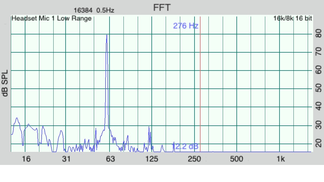

... it seems to miss the peak spl of a kick drum hit and can't keep up with quick notes on a bass guitar.
I know there is a lot of opinions of subwoofer transient response and I don't really want to get into that discussion, ...
Do you want to discuss how to make it sound better?

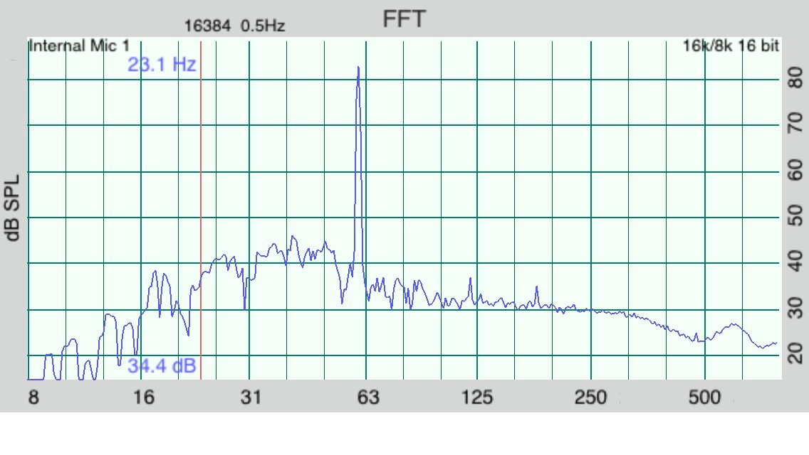

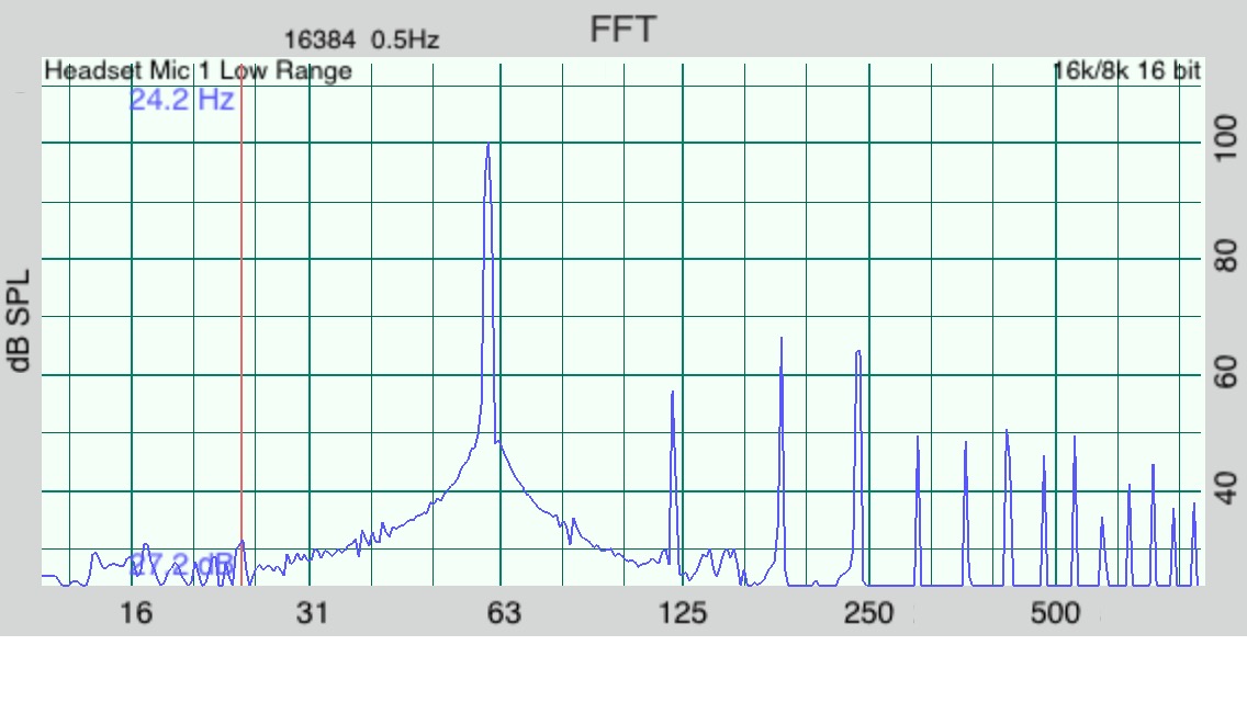

Next I removed the rear subwoofer and covered up the hole with a gasketed plywood disk. So it is now a single Dayton Audio RSS315HFA-8 12" Reference HF Subwoofer 8 Ohm in 2.1 cu ft (60 liters)
Frequency Spl of fundamental 2nd harmonic 3rd harmonic
16 81 -43 -25
20 82 -32 -25
25 86 -25 -35
31.5 81 -24 -35
40 95 -25 -43
50 103 -29 -35
63 110 -30 -44
again attached is 60hz @80db and 100db

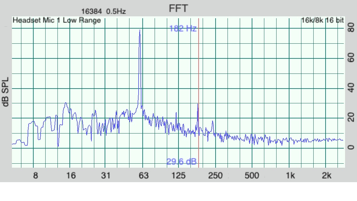

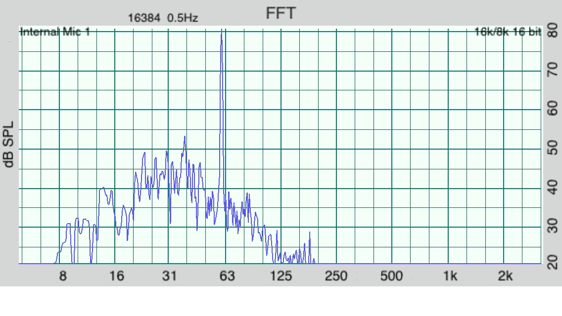

Next experiment was to use a passive radiator. The plywood disk was replaced by a ScanSpeak Discovery 30W/0-00 12" Subwoofer Passive Radiator.
So one Dayton rs 12 sub with the passive gives approximately a 20 hz tune.
This setup again seemed equally sluggish with music but 20hz sine waves were fun.
16 85 -17 -31
20 91 -24 -28
25 93 -27 -24
31.5 74 -19 -27
40 95 -26 -43
50 106 -26 -25
63 110 -26 -32
60hz @80db and 100db attached

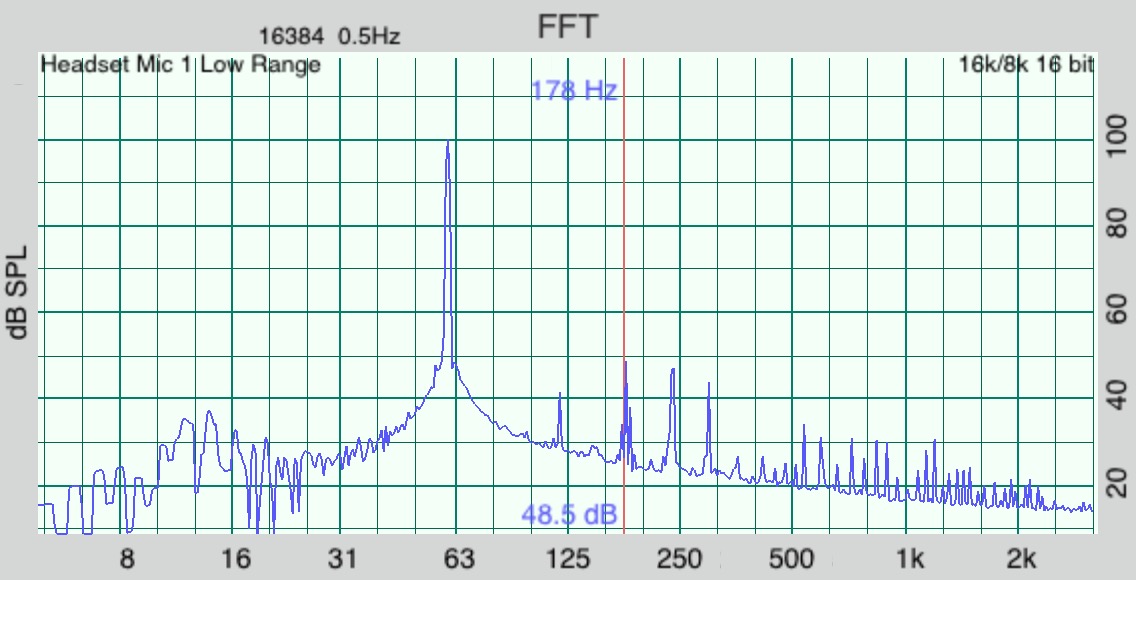

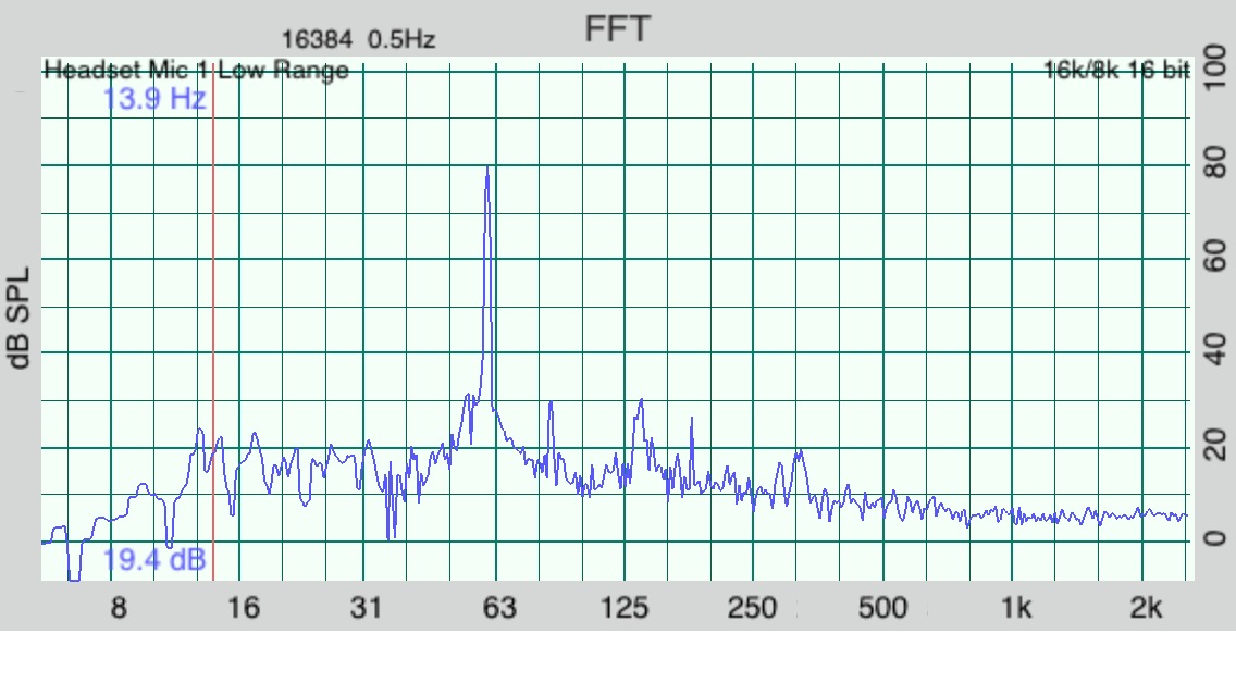

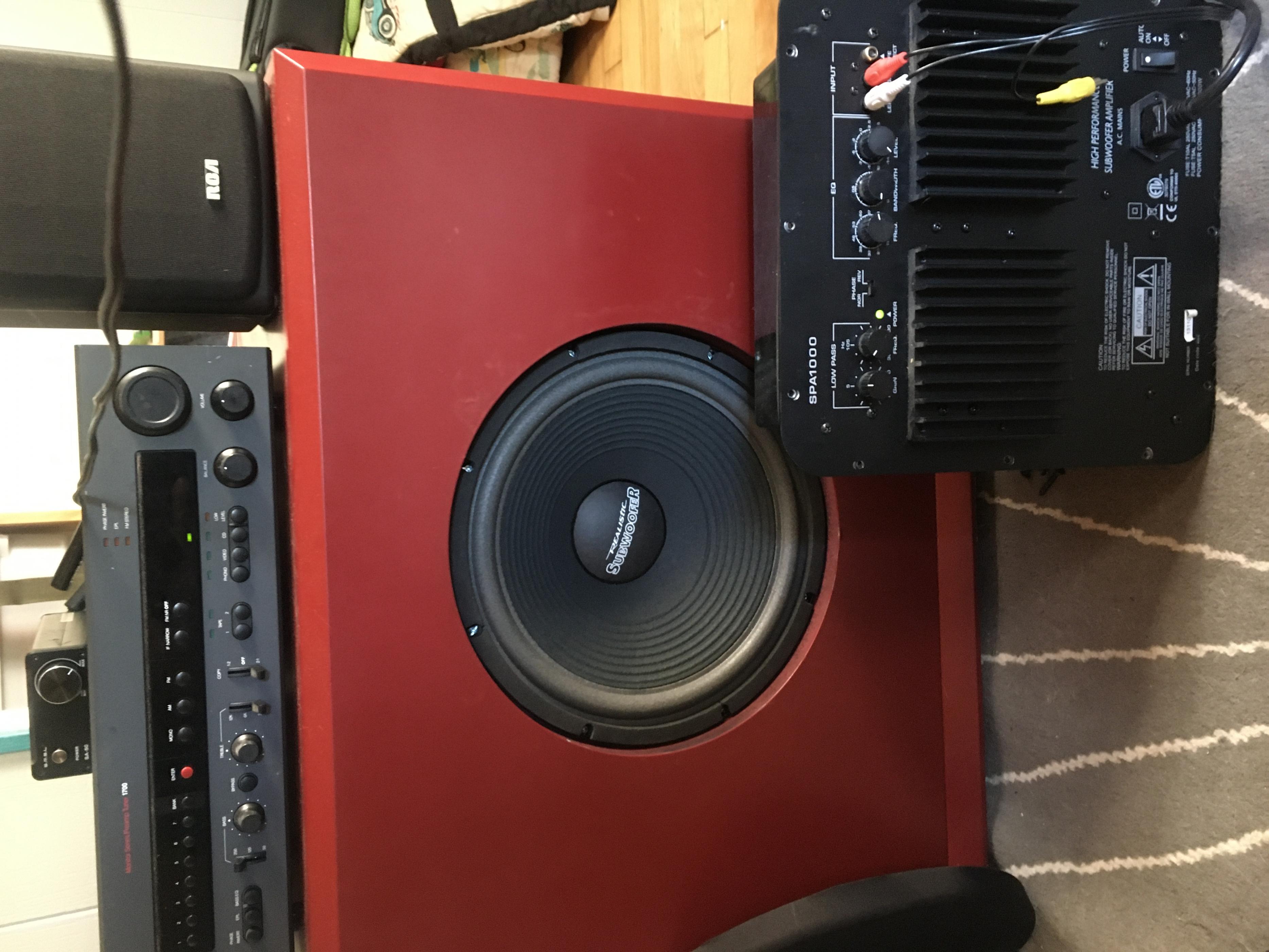

Next up the $15 special! This is new old stock radio shack 40-1350 subwoofer from the 1990s. Specs on these are great for an acoustic suspension design.
To my surprise this is the most musical sub I have listened to. It beats a dayton rs 12 a peerless xxls 10 a dayton ultimax 12 and a tang band 8 in a 8foot folded horn. To me its equal is a pair of acoustic elegance ibht15s that I have in a dipole setup. The ae subs do better from 30-50hz while the radioshack 12 does better from 50-100hz. Btw as expected the folded horn will get louder but has noticeable resonances.
I know many frown on subjective impressions but this radioshack 12 captures a very realistic kick drum on hotel california from the Eagles Hell freezes over. Bass guitar notes are crisp with great separation in the Alpha Blondy song Allah Tano.
However it's not perfect, distortion below 50 hz is high and it can easily bottom out with low bass. I guess I should say this is the most musical woofer I've heard not subwoofer.
Here's the distortion measurements:
16 71 -32 -24
20 71 -27 -22
25 67 -23 -37
31.5 59 -18 -25
40 78 -26 -45
50 101 -24 -25
63 110 -30 -25
attached is 60hz@80db and 100

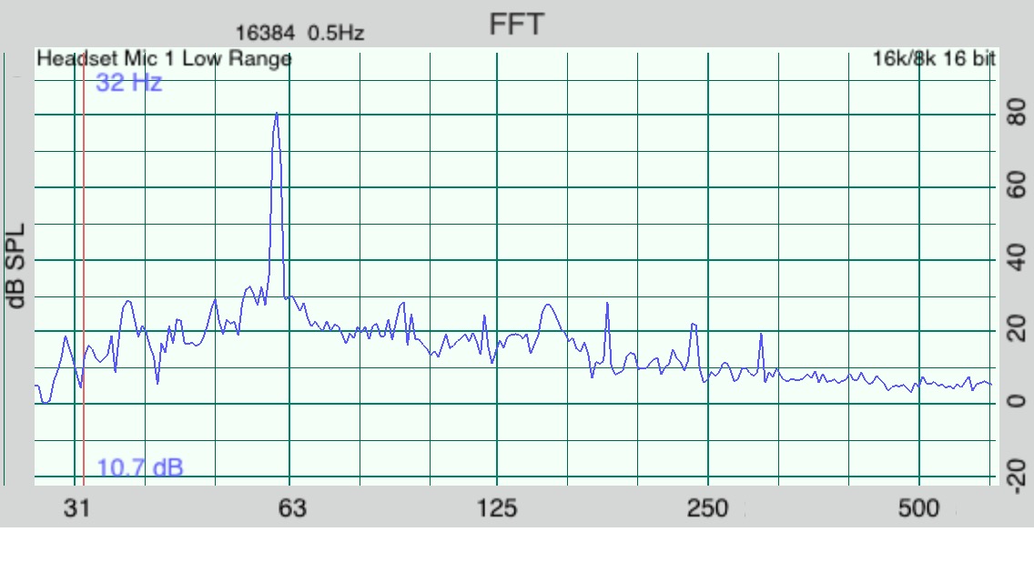

I don't think it's the distortion I like. The song I mentioned earlier Allah tano causes spikes on my FFT at 60 hz during the bass guitar bits. The radio shack speaker is running low distortion at 60hz. Especially at moderate listening levels. However, I can hear this same sub distorting with hiphop that has 35hz bass and I don't like it.
I also ran the radioshack subwoofer with the passive radiator. Modeled frequency response is very close to sealed, more max spl at tuning as expected but my ears noticed a increase in stored energy.
Couldn't get a good 31.5 hz result.
16 71 -22 -26
20 76 -26 -26
25 69 -24 -35
31.5 65 -5 -25
40 77 -26 -33
50 105 -26 -24
63 111 -26 -32
attached is 60hz @80db and 100 db

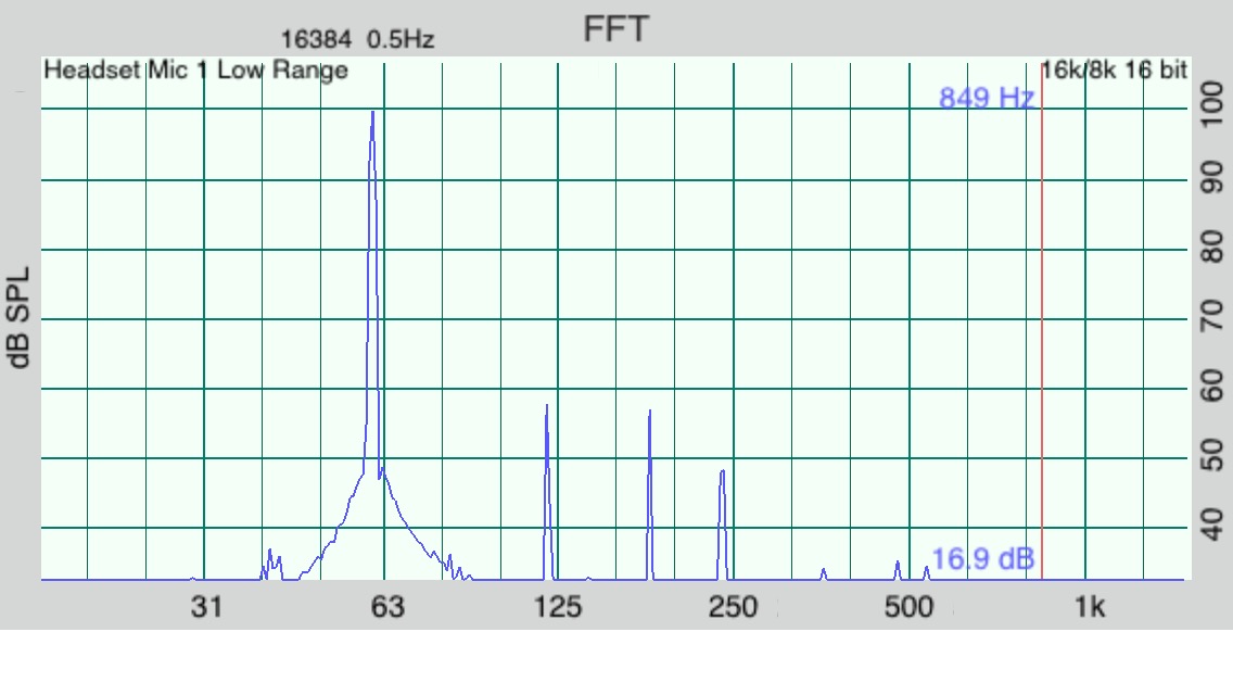

My next experiment was to try a peerless xxls 830842 10" sub with the passive radiator. I made another plywood adapter plate as shown.
I used this sub in my minivan for a few years in a sealed .5 QTC alignment but am know using it sealed in a home office setting.
This passive radiator alignment is similar to one recommend by Peerless.
The sealed alignment sounds tighter to me than the passive radiator especially once you get above 2x resonance (80hz). However it's not perfect, I get some sort of 140hz resonance that shows up in close mike measurements and ruins the crossover to the satellites.
16 69 -23 -39
20 94 -32 -25
25 93 -26 -27
31.5 76 -25 -48
40 92 -31 -26
50 103 -32 -30
63 111 -22 -31
attached is 60hz@80db and 100db
