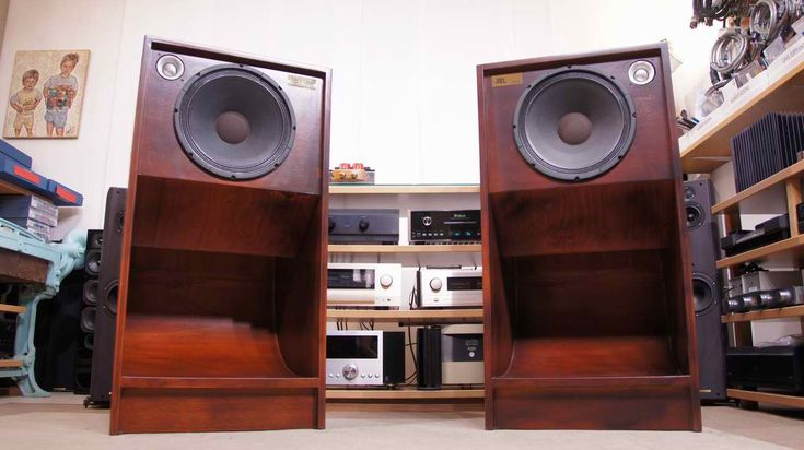

Han anyone else thought about building a La Scala type enclosure with different dimensions? I have a Joseph Crowe ES600 horn equipped with a SB Audience 65CDN-T compression driver and was planning to build a La Scala type bin but feel the ES600 would out of place with the 24.5 inch (62cm) wide box. So I thought I could maybe build a narrower and taller box keeping the same area for the throat an mouth. What do you think? Stupid idea? 🙂
At first I thought: Why Not? But on second thought, would it not change the dispersion pattern? Less of an issue at the lower frequencies, but in the Mid's, and in particular, around the cross-over frequency. Disclaimer: I have zero experience in this sort of thing, just thinking off the top of my head!
and a further thought: maybe rotate the guts of the horn by 90 degrees? That would stiffen the long side walls, but again, what would that do for the radiation pattern?
Well I'm was planning to to crossover at 600Hz since that's the lower limit of the horn I have.. The wavelength at 600Hz is about 57 centimeters (23") so a 90 cm high horn might be emitting those frequencies close to the floor, a long way from the ES600 horn causing some problems. It would probably be pretty hard to fit the 15" woofer into the doghouse without getting into problems with space at the back and sides. Maybe I can make it a little bit slimmer and taller. Next stop Hornresp!

I don't see any sonic reason to have the woofer box the same width as the CD horn. The - 3 db width should be the same, but this has to with horn design, not horn exit width.
Taking the CD down to 600 hz will limit wattage to that suitable for one listener in a quiet room. With 70 w CD RX22, 1985 Peavey SP2 had pink noise wattage at 175. Crossover was 800 hz. 1995 SP2 with 1200 hz crossover was rated 300 w. 2004 SP2 with 1800 hz crossover is 500 w. The latter requires a pinched back reflex box to get 6 db point out to +- 45 deg horizontal at 1800 hz.

My comment would be about how beautiful the first photo was. Beyond the striking looks, I could only hope that it would be possible to make the acoustics work. I do wonder at the idea of the 600hz crossover though.
Yes, the width ís only about looks. I was just wondering if I change the height-width ratio but keep horn length, throat and mouth sizes. I think it would still look good.a little wider (and lower). Would it work the same.
The most obvious solution for my project would be an EV Eliminator bin since that would “eliminate” guesswork for my EVM 15B woofers. Maybe I can make it look nice with some good wood veneer and careful carpentry. …unless I feel the need to redesign the wheel. 😂

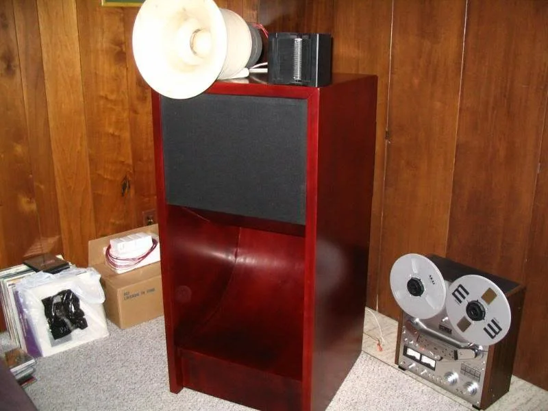

I like the look of post #1. I first bought speakers at the end of the age of real walnut veneer, (KLH23) and don't like the black on black with plastic horn of my excellent sounding Peavey SP2(2004). I have bought a CD, horn, and woofer for a replacement. Your picture makes me think of sending my aluminum eminence horns out for a bronze anodize treatment.
