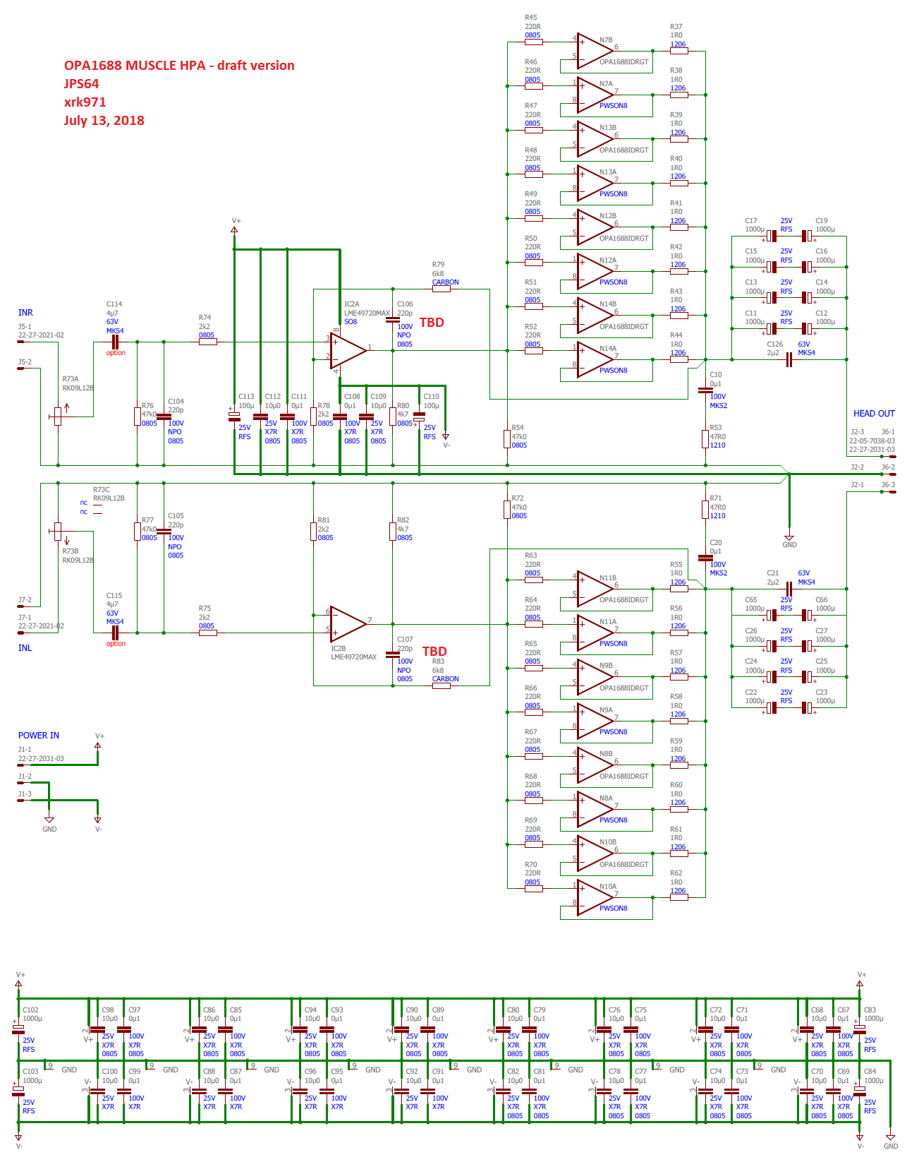

But OTOH, I am designing an amp that can drive 2.5wrms into a 32ohm load, and this should be sufficient for driving the flagship HE6 (84dB and 50ohm). Not that I have an HE6, but I want the amp to drive any load. So I am using 8x OPA1688 in parallel as buffers (ea capable of 75mA or 600mA total with 28vpp) with +/-18v rails.
Cheap as Chips OPA1688 Low-THD Muscle Amp

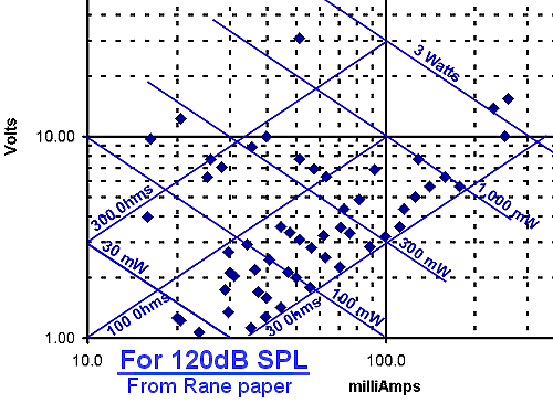

Many years ago, for an insane situation (quality monitoring recordings in the same room with large bands), I asked myself to design for 120dB SPL "in any headphone".
120dB SPL is Very Frikkin LOUD!! Deafening. It would only be used for seconds at a time, a couple minutes in my lifetime. However when I needed to check a loud passage for clipping, I needed to know the clip was NOT in the headphone amp but the signal to tape/digits.
As xrk971 says, "depends on the phones". Sensitivity varies a LOT. Impedance has ranged all over the place, making V/I a wide target.
Using RANE's older paper, the attached is what I came up with. I decided that I would live without the up-right outliers, they were not useful for location recording (too costly, too fragile, or too darn dull).
For 120dB SPL, I get 7V or 250mA RMS to cover most-all headphones.
For continuous listening (not spot-monitoring), 110dB SPL is still a LOT. This needs 2.2V 80mA RMS, or 3.1V 110mA Peak.
6.2V peak-peak plus a few Volts for amplifier losses means you can design an AMPLE headphone driver with 8 or 9 (or 7) Volt supply.
The 110mA peak need can be covered with TO-92 BJTs or a few opamps.
Several-WATT amps for (all but a few) headphones is, IMHO, like using a 2KW PA amp for apartment loudspeakers. Or the 5-ton truck to bring the beer home. If it makes you happy, OK; but it is not necessary.
