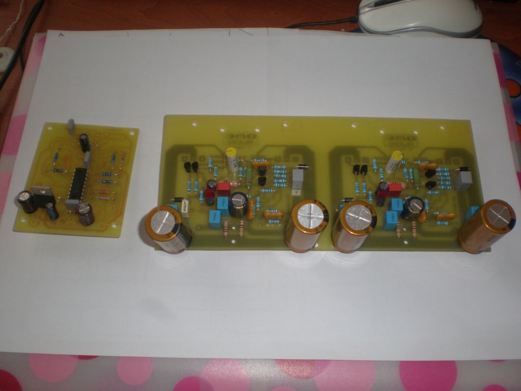

SOME OF DR BORA'S AMPS BUILT BY ME :-

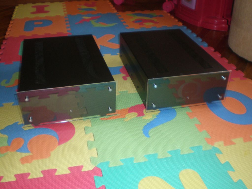

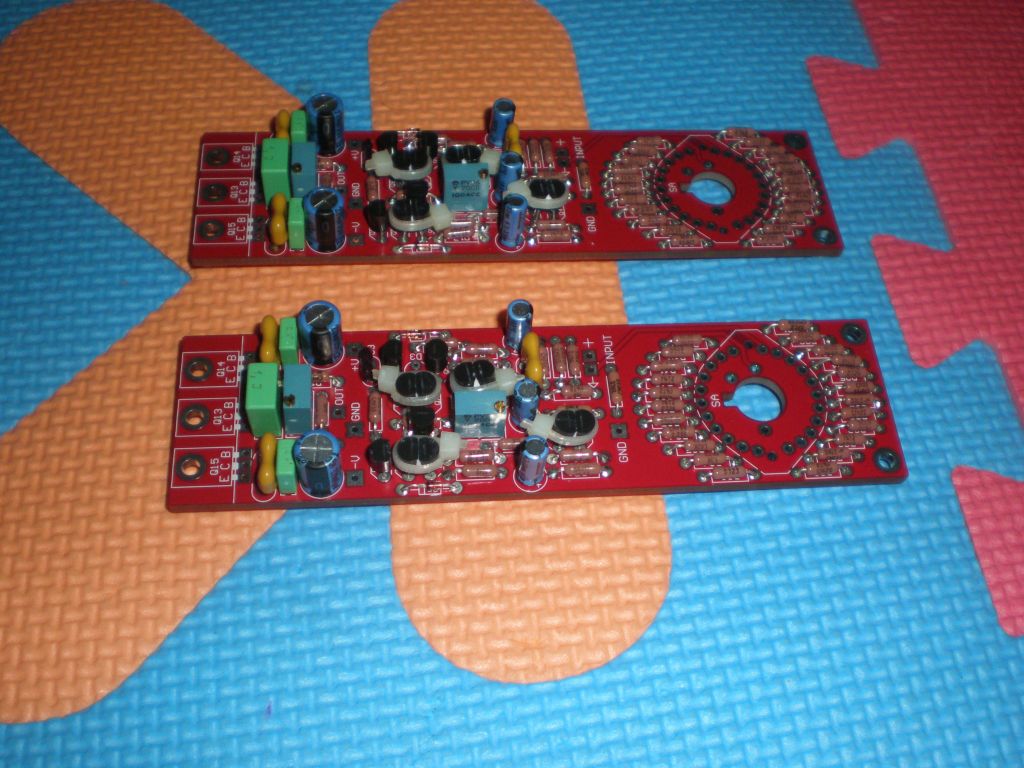

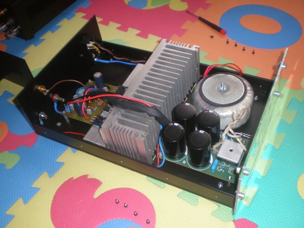

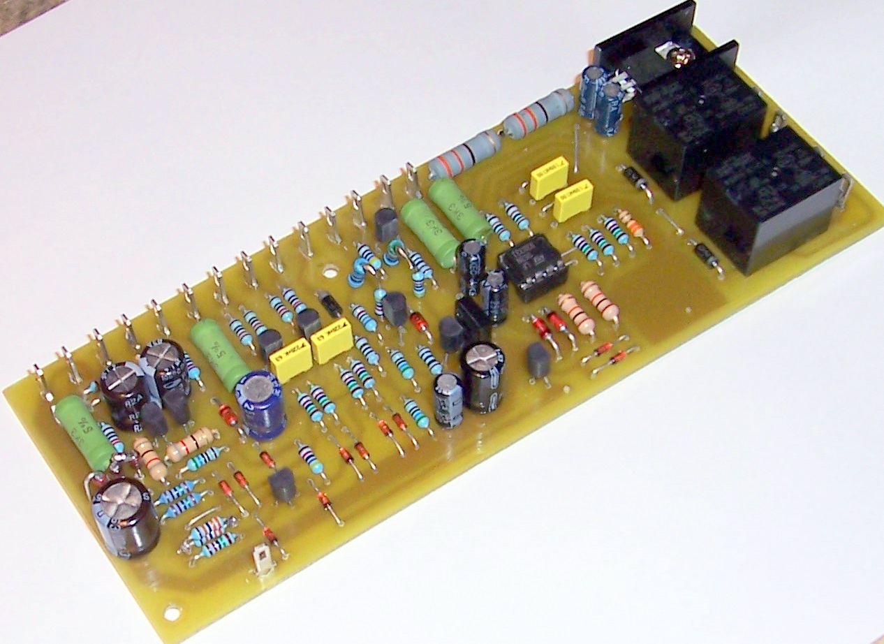

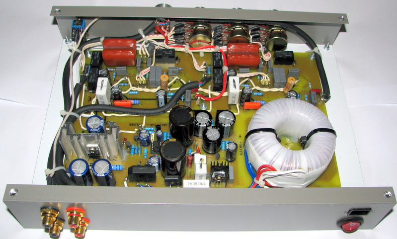

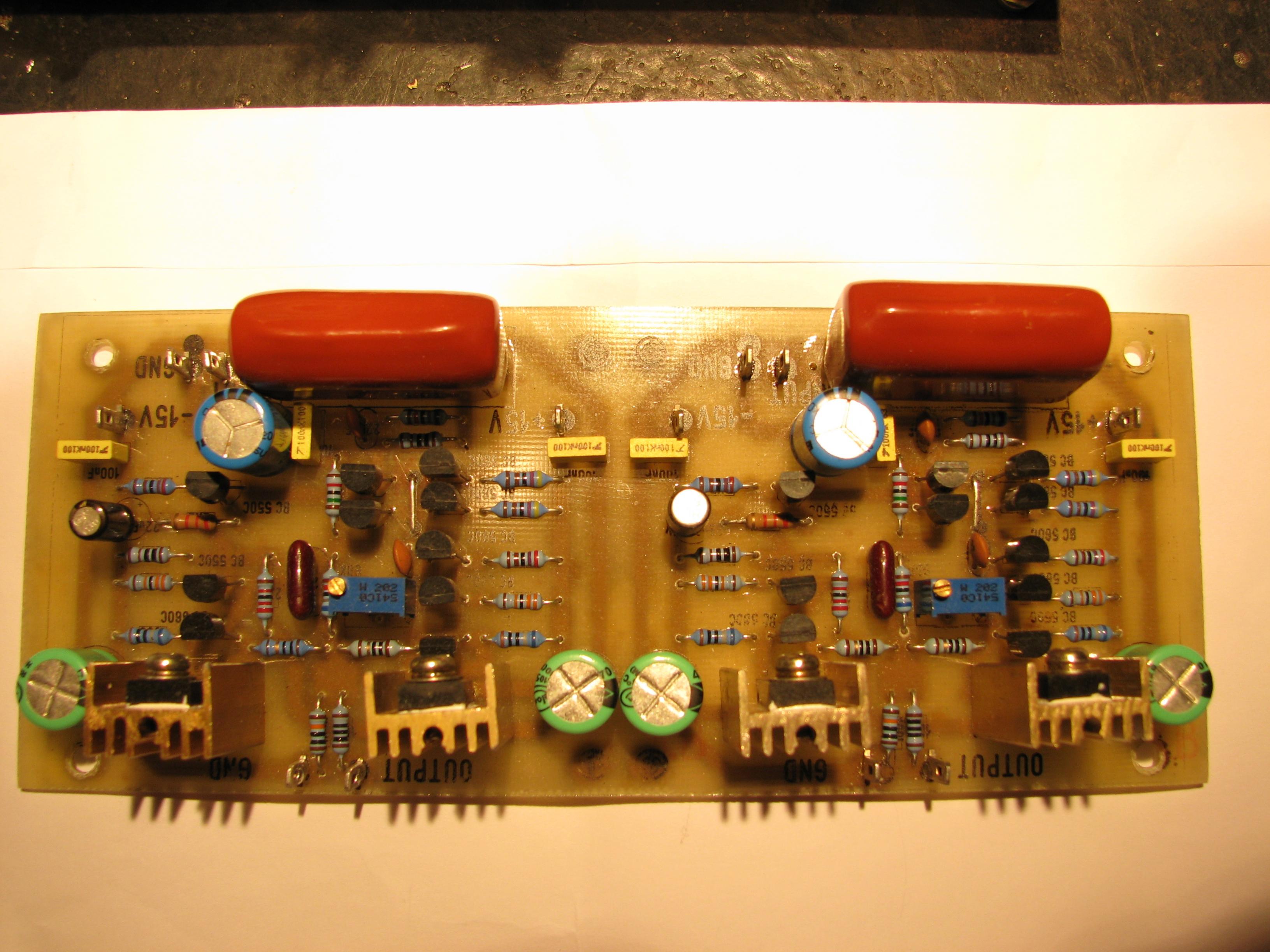

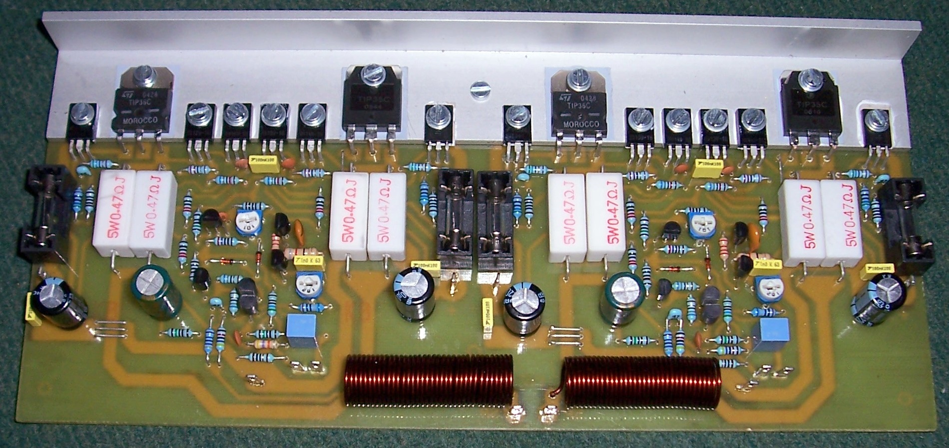

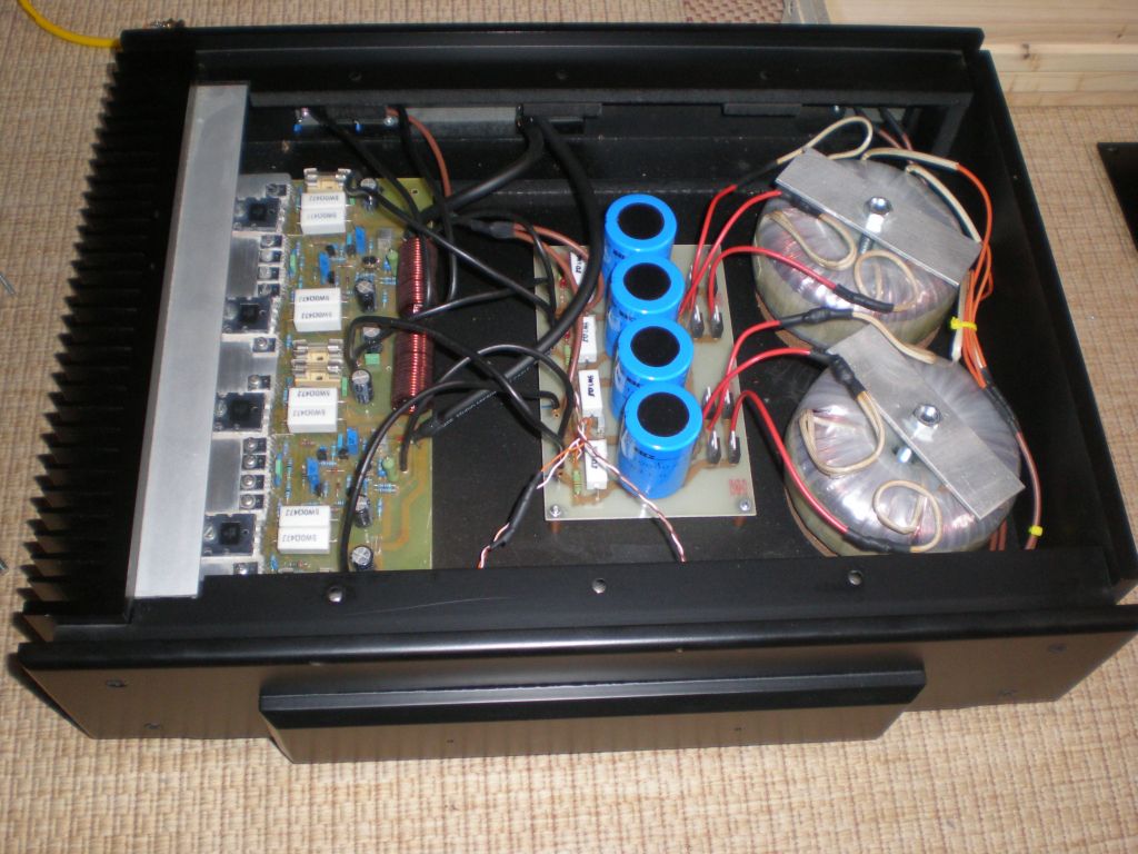

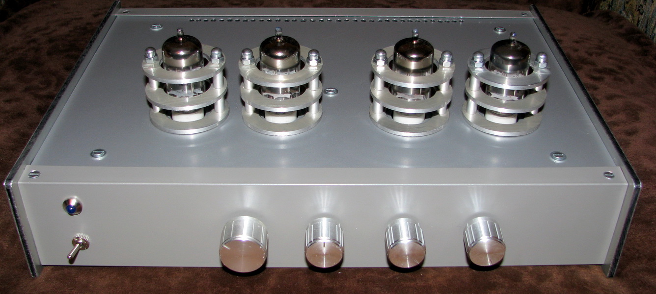

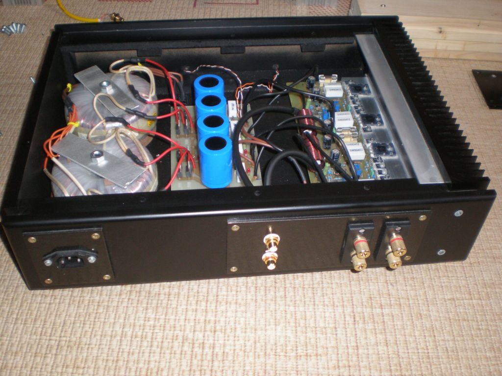

Dr. Bora is not a selfpromoting man, therefore everyone are not familiar with his designs. He is truly a wonderfull person and perhaps it's our duty (us who have built any of Dr.Bora's projects) to get to world introduced to his designs. These are some of mine:
DoGC mk3
Studio
Tehno aka Modus - a good friend of mine refuses to give it back to me 🙂
Clepsidra preamp
Flat BTpreamp
DoGC mk3
Studio
Clepsidra preamp
Flat BTpreamp

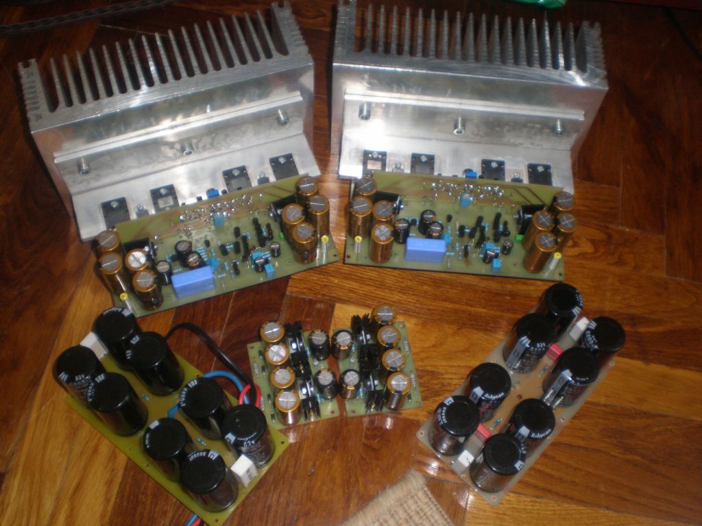

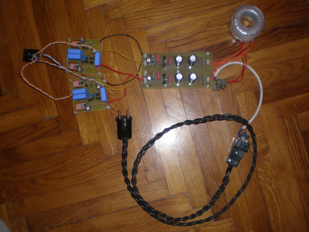

A good friend of mine refuses to return Tehno i've made recently and leaves me with no other choice but to assemble another one for myself. I started assembling Modus M using only one pair of output transistors. Thus, the pcb is smaller, good job by dr. Bora again.

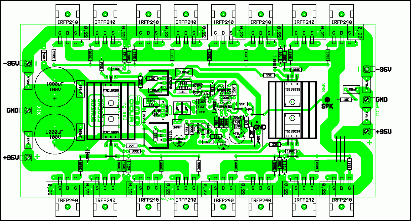

@ andrewlebon
I will suggest Legend Quazor (not Quasar !) as better option Andrew.
that amp looks like a monster, and tempting
to use seperate supply(double), is it possible to remove diodes in supply rails between frontend and output stage
I can manage 55Vdc for output stage, and 60Vdc for frontend
and maybe just use 2x 3+3 IRFP240, instead of 2x 4+4
Of course "tinitus" you can omit those diodes and supply pre-stages from separate (preferably well stabilized) PSU and provide second separate high power DC source for output stage. Your voltages should be OK but you have to be aware of significantly reduced output power on 8ohms loads. On the other hand, number of output devices and those planed voltages will give you freedom to connect loads of much lower impedance - even 2ohms should still be safe. With such a low supply, requirements for some components will be much relaxed and many replacements will work satisfactory.

Hi sekhar! What's up?!
Annual vacations are in progress, and because that there are only few people on the forums. Do you have a higher quality photo of studio-SE amplifier? Have you tested this amplifier? What transistors did you use?
that is great, thanks Bora

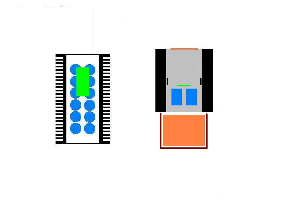

seems I may be facing a first time making my own boards, and hardwired outputs 🙄
You have my PCB for QUAZOR available on my site. Why would you develop your own... except if you strictly want that way? I would like to discourage you to hard wire output devices (if that is what you meant) because those are MOSFET-s…parasitics might spoil your adventure!
parasitics, thats to do with delay times
I was thinking of roughly something like below, showing one mono amp
I suppose not very far from your board design
thanks fore the warning, something to think about
hey, I see now that your actual board layout is different from what you show in the first seen picture, and much nicer looking, yeah
hmm, my heatsinks are still 400(L)x300(W)x40, of which I have two
Instead of cutting them into 4, I could use them as is, and your Legend Quasor boards would fit nicely
But I also like the idea of placing supply caps along the output dvices, and closer
decitions decitions 😕
but those boards looks good

every mosfet (240) is fed or sunk via 0r22 source resistor from the +ve or -ve supply rails.But I also like the idea of placing supply caps along the output dvices, and closer
Why have split supply rails fed from both ends of the PCB? The resistance of the traces should be small in comparison to the 0r22
If the right hand end +ve & -ve are deleted, but you keep the output trace spkr tab at the right hand end, you will ifnd that the total trace resistance from +ve to output and from -ve to output is near identical for all mosfets. It's the same as a water radiator connected "tboe" (Top and bottom at Opposite Ends).
