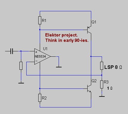

Duo said:
The major difference is
that the feedback loop is now with a speaker in place of the feedback resistor,
so that it senses current drawn through the speaker.
About 15 years ago, in the beginning of the 90-ies, I think,
Elektor had such an amplifier.
I could find this article and post a copy of schematic.
I have all them old Elektor magazines stored here.
The basic and rather simple circuit can be seen in my attachment.
I have drawn this schematic from memory.
It shows the Current Feedback princip.
The Gain in this case is: LSP 8 Ohm / 1 Ohm = 8

Yes,
this is probably the way to do it, hacknet.
My attachment is not a complete design circuit.
As I told, it is a simplified diagram - to show the basic princip.
Actually this is what I would call A True Current Feedback Amplifier.
CFA - In the correct sense.
Because gives an output current proportional to input voltage.
One thing about woofers/speakers to use with this.
You may have to rolloff the rising impedance of the speaker.
Using some impedance equalizing filter.
Similar in effect to the Zobel Network.
Say the impedance would rise to 30 Ohm in higher freq.
The gain would be also 30!!
Regards, lineup

See my attachment:
http://www.diyaudio.com/forums/attachment.php?s=&postid=1118549&stamp=1170003209
The gain is: LSP-Z / R3
R3 is in this case 1 Ohm.
So, Nominal gain is: 8/1 = 8
At Z=30 Ohm ...... 30/1 = 30
This is why we need to watch out, that speaker impedance stays within a reasonable level.

Duo said:
At higher output, the circuit is almost impossible to stabilize,
probably due to the high open loop gain and the amount of feedback I have.
Current feedback amplifiers can be a bit tricky to get stable.
I remember I had oscillations when setting up that Elektor circuit.
Current feedback amps can be very fast - high slewrate ...
Usually not a good idea, to have same supply line
for input, pre stage and output stage.
Actually not uncommon to see Current Feedback amplifiers
with separate regulated supply for the front end part!

It seems that with some slight modifications, this is now stable; with the same op-amp I started with.
I had to add some B-C capacitance in the current source that operates the pulldown for the op-amp's emitter follower to drive the outputs. This slowed it down enough to stay stable up to higher output than I originally intended. I'm now happy with the circuit for the most part.
UPDATE: The LF411 op-amp co-operates with this topology beautifully.
It's absolutely stable in situations where my other op-amp would not calm down. I was using an MC4558CP1 dual op-amp.
I would be picking much better op-amps if I could, but I'm doing this project with only the parts I have around in my junk collection, so bear with me.
I'm pleased enough with this one I may built the first prototype with it.
